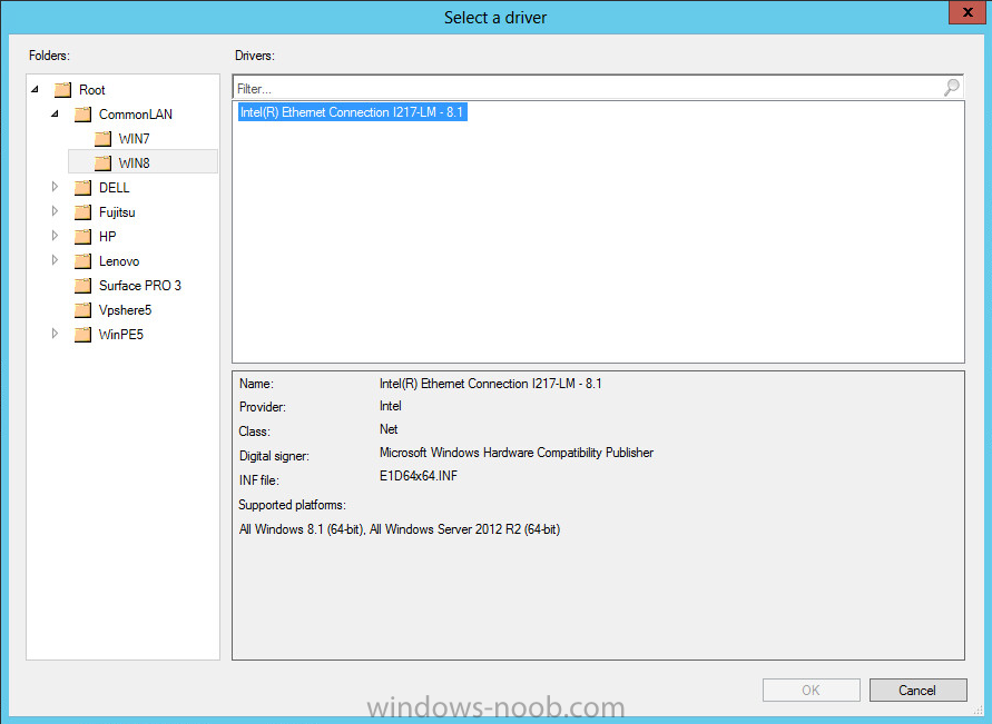

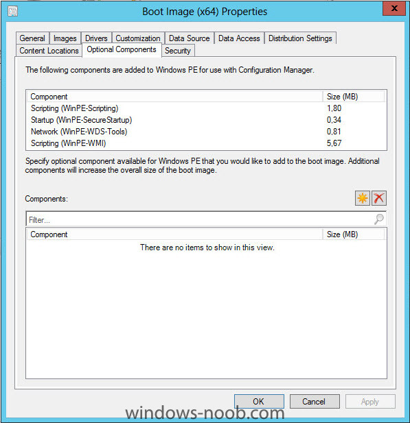

  2. Hello All, I use SCCM 2012R2 CU4 for a while since few days I have some errors modifying or customizing boot images. I cannot add drivers to boot image (see screenshot) I select the driver to add but OK is greyed and I cannot add any driver. I added Optional Componants like powershell but I cannot see them in the Optional Componants tab I checked mounting the Wim and componants are in the image (powershell is available )
