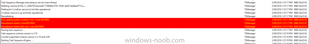

	Hi Guys, I am currently trying to run an in-place refresh on a particular machine, and it's failing on the "Applying Operating System" section of the Task Sequence. I've posted another thread, but that's completely different issue with a different computer, so don't get confused if you see my two posts. In this case, I have a computer that will PXE boot perfectly and install an OS that I have deployed through a Task Sequence. That all works well. The issue I have is when I want to run the in-place refresh Task Sequence which essentially loads the same TS as the completely SOE install, but the difference is that this one uses USMT as well. The settings (with the exception of the USMT sections of the Task Sequence) are exactly the same as the TS that works fine, but for some reason, when it gets to Applying OS, it fails with 80070002. I've had a look at the logs by pressing F8 during the deployment and I've checked out the smsts.log file, and it's showing the WinSendHTTP error message. It looks like the error message translates to something like it's not able to reesolve the server name. I've run an IPCONFIG on the machine, and I'm getting a 169 address, so that would most likely explain that part. The issue is that I don't understand why it would be getting a 169 address. The drivers are the same, the boot image is the same, the WIM that it's installing is the same. Literally the only diffference is that it captures the user state etc, and that this one starts from the Software Center, rather than a PXE boot. Everything else is exactly the same, but for some reason this fails on this particular machine. Any ideas?

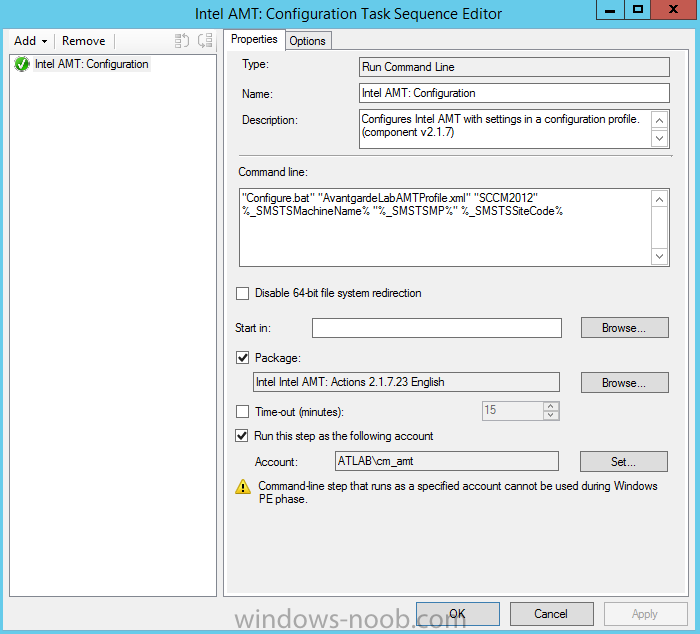

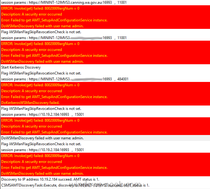

	Hi Everyone, I've just run the Intel AMT: Configuration task sequence and that's worked successfully but it's showing up as 'detected' instead of 'externally provisioned'. I've had a look at the AMTOPMGR.log and I'm getting the following logs (attached). If anyone could please let me know what the best way to get this up and running, that would be great.

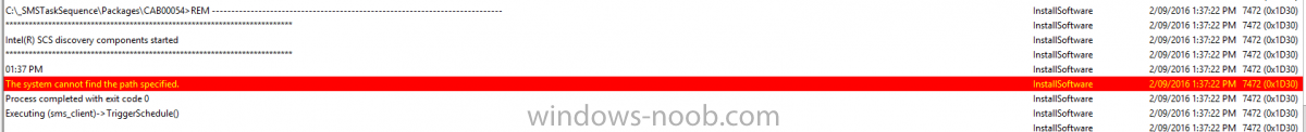

	Hi Everyone, I'm trying to run the Intel SCS: Platform Discovery Task Sequence through SCCM. I noticed that a lot of test machines are not showing up in the Intel AMT: Exists device collection after the TS has run which would indicate an issue. I've checked the smsts.log and this is what I have: Any advice for this one? I can see that it references that it can't find the specified file. Everything has been located in the default locations and the user account it's running as is a domain admin.

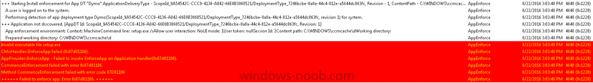

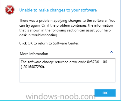

	Hi Guys, I've created an application within SCCM to essentially run "setup.exe /s". I can run this manually and it works perfectly, so I know the "/s" flag works fine. When running it through Software Centre, I get the following errors (pic 1 taken from appenforce.log, pic 2 taken from software centre). Any ideas? I'm not sure what "Invalid Executable File Setup.exe" means. As I had mentioned, I can run that exe without any problems if I'm running it manually. Just fails through SCCM.

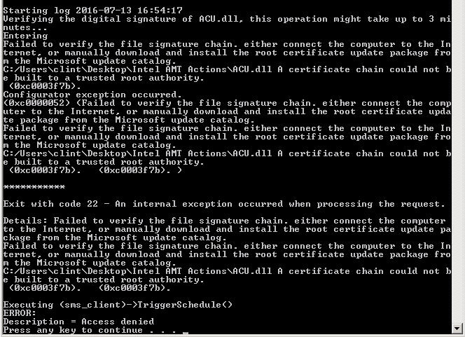

	Hi Guys, I'm running a task sequence which was setup by Intel SCS and it's failing on me. The SMSTS logs are below. Any ideas? <![LOG[==========[ TsProgressUI started in process 1544 ]==========]LOG]!><time="16:24:40.414-480" date="07-13-2016" component="TsProgressUI" context="" type="1" thread="3620" file="winmain.cpp:330"> <![LOG[Registering COM classes]LOG]!><time="16:24:40.414-480" date="07-13-2016" component="TsProgressUI" context="" type="1" thread="3620" file="winmain.cpp:187"> <![LOG[sbModulePath = C:\Windows\CCM\TsProgressUI.exe]LOG]!><time="16:24:40.414-480" date="07-13-2016" component="TsProgressUI" context="" type="1" thread="3620" file="tsprogressuiclass.cpp:625"> <![LOG[shutdown complete.]LOG]!><time="16:24:40.417-480" date="07-13-2016" component="TsProgressUI" context="" type="1" thread="3620" file="winmain.cpp:512"> <![LOG[successfully intialized Logging for TS Manager.]LOG]!><time="16:24:40.625-480" date="07-13-2016" component="TSManager" context="" type="1" thread="1436" file="tsmanager.cpp:746"> <![LOG[Commandline: C:\Windows\CCM\TSManager.exe /service]LOG]!><time="16:24:40.626-480" date="07-13-2016" component="TSManager" context="" type="1" thread="1436" file="tsmanager.cpp:101"> <![LOG[successfully registered Task Sequencing COM Interface.]LOG]!><time="16:24:40.631-480" date="07-13-2016" component="TSManager" context="" type="1" thread="1436" file="environmentlib.cpp:821"> <![LOG[Executing as a service]LOG]!><time="16:24:40.631-480" date="07-13-2016" component="TSManager" context="" type="1" thread="1436" file="tsmanager.cpp:759"> <![LOG[started ServiceMain]LOG]!><time="16:24:40.651-480" date="07-13-2016" component="TSManager" context="" type="1" thread="3200" file="tsmanager.cpp:333"> <![LOG[Task Sequence Manager executing as service main thread]LOG]!><time="16:24:40.651-480" date="07-13-2016" component="TSManager" context="" type="1" thread="3200" file="tsmanager.cpp:450"> <![LOG[Deleting volume ID file C:\_SMSTSVolumeID.7159644d-f741-45d5-ab29-0ad8aa4771ca ...]LOG]!><time="16:24:40.655-480" date="07-13-2016" component="TSManager" context="" type="1" thread="3200" file="resolvesource.cpp:506"> <![LOG[Waiting for CcmExec service to be fully operational]LOG]!><time="16:24:40.664-480" date="07-13-2016" component="TSManager" context="" type="1" thread="3200" file="utils.cpp:4888"> <![LOG[CcmExec service is up and fully operational]LOG]!><time="16:24:40.664-480" date="07-13-2016" component="TSManager" context="" type="1" thread="3200" file="utils.cpp:4893"> <![LOG[Remediating]LOG]!><time="16:24:40.664-480" date="07-13-2016" component="TSManager" context="" type="1" thread="3200" file="tsnapcontrol.cpp:43"> <![LOG[Error getting system isolation info. Code 8027000C]LOG]!><time="16:24:40.666-480" date="07-13-2016" component="TSManager" context="" type="3" thread="3200" file="remediate.cpp:632"> <![LOG[Remediation failed. Code 8027000C]LOG]!><time="16:24:40.666-480" date="07-13-2016" component="TSManager" context="" type="3" thread="3200" file="tsnapcontrol.cpp:48"> <![LOG[Remediation failed with error code 8027000C]LOG]!><time="16:24:40.666-480" date="07-13-2016" component="TSManager" context="" type="3" thread="3200" file="tsmanager.cpp:1539"> <![LOG[Parsing task sequence . . .]LOG]!><time="16:24:40.666-480" date="07-13-2016" component="TSManager" context="" type="1" thread="3200" file="tsmanager.cpp:1434"> <![LOG[Task sequence schema version is 3.10]LOG]!><time="16:24:40.667-480" date="07-13-2016" component="TSManager" context="" type="0" thread="3200" file="tsmanager.cpp:1365"> <![LOG[Current supported schema version is 3.10 and 3.00]LOG]!><time="16:24:40.667-480" date="07-13-2016" component="TSManager" context="" type="0" thread="3200" file="tsmanager.cpp:1373"> <![LOG[starting Task Sequence Engine . . . ]LOG]!><time="16:24:40.668-480" date="07-13-2016" component="TSManager" context="" type="1" thread="3200" file="tsmanager.cpp:913"> <![LOG[****************************************************************************]LOG]!><time="16:24:40.668-480" date="07-13-2016" component="TSManager" context="" type="1" thread="3200" file="tsmanager.cpp:916"> <![LOG[set a global environment variable _SMSTSNextInstructionPointer=0]LOG]!><time="16:24:40.668-480" date="07-13-2016" component="TSManager" context="" type="0" thread="3200" file="executionenv.cxx:668"> <![LOG[set a global environment variable _SMSTSInstructionTableSize=1]LOG]!><time="16:24:40.668-480" date="07-13-2016" component="TSManager" context="" type="0" thread="3200" file="executionenv.cxx:668"> <![LOG[set a global environment variable SMSTSRebootRequested=]LOG]!><time="16:24:40.668-480" date="07-13-2016" component="TSManager" context="" type="0" thread="3200" file="executionenv.cxx:668"> <![LOG[set a global environment variable SMSTSRebootDelay=]LOG]!><time="16:24:40.668-480" date="07-13-2016" component="TSManager" context="" type="0" thread="3200" file="executionenv.cxx:668"> <![LOG[set a global environment variable SMSTSRebootMessage=]LOG]!><time="16:24:40.668-480" date="07-13-2016" component="TSManager" context="" type="0" thread="3200" file="executionenv.cxx:668"> <![LOG[set a global environment variable SMSTSRebootReason=]LOG]!><time="16:24:40.668-480" date="07-13-2016" component="TSManager" context="" type="0" thread="3200" file="executionenv.cxx:668"> <![LOG[set a global environment variable SMSTSRetryRequested=]LOG]!><time="16:24:40.668-480" date="07-13-2016" component="TSManager" context="" type="0" thread="3200" file="executionenv.cxx:668"> <![LOG[The task execution engine started execution]LOG]!><time="16:24:40.669-480" date="07-13-2016" component="TSManager" context="" type="1" thread="3200" file="engine.cxx:69"> <![LOG[set authenticator in transport]LOG]!><time="16:24:40.670-480" date="07-13-2016" component="TSManager" context="" type="0" thread="3200" file="libsmsmessaging.cpp:7734"> <![LOG[Default CSP is Microsoft Enhanced RSA and AES Cryptographic Provider]LOG]!><time="16:24:40.684-480" date="07-13-2016" component="TSManager" context="" type="0" thread="3200" file="libcrypt.cpp:1914"> <![LOG[Default CSP Type is 24]LOG]!><time="16:24:40.684-480" date="07-13-2016" component="TSManager" context="" type="0" thread="3200" file="libcrypt.cpp:1915"> <![LOG[start executing an instruction. Instruction name: Intel AMT: Configuration. Instruction pointer: 0]LOG]!><time="16:24:40.813-480" date="07-13-2016" component="TSManager" context="" type="1" thread="3200" file="engine.cxx:116"> <![LOG[set a global environment variable _SMSTSCurrentActionName=Intel AMT: Configuration]LOG]!><time="16:24:40.813-480" date="07-13-2016" component="TSManager" context="" type="0" thread="3200" file="executionenv.cxx:668"> <![LOG[set a global environment variable _SMSTSNextInstructionPointer=0]LOG]!><time="16:24:40.813-480" date="07-13-2016" component="TSManager" context="" type="0" thread="3200" file="executionenv.cxx:668"> <![LOG[set a local default variable SMSTSDisableWow64Redirection]LOG]!><time="16:24:40.831-480" date="07-13-2016" component="TSManager" context="" type="0" thread="3200" file="executionenv.cxx:700"> <![LOG[set a local default variable _SMSTSRunCommandLineAsUser]LOG]!><time="16:24:40.831-480" date="07-13-2016" component="TSManager" context="" type="0" thread="3200" file="executionenv.cxx:700"> <![LOG[set a local default variable SMSTSRunCommandLineUserName]LOG]!><time="16:24:40.831-480" date="07-13-2016" component="TSManager" context="" type="0" thread="3200" file="executionenv.cxx:700"> <![LOG[set a local default variable SMSTSRunCommandLineUserPassword]LOG]!><time="16:24:40.832-480" date="07-13-2016" component="TSManager" context="" type="0" thread="3200" file="executionenv.cxx:700"> <![LOG[set a global environment variable _SMSTSLogPath=C:\Windows\CCM\Logs\SMSTSLog]LOG]!><time="16:24:40.832-480" date="07-13-2016" component="TSManager" context="" type="0" thread="3200" file="executionenv.cxx:668"> <![LOG[Expand a string: smsswd.exe /run:AVT0000A Configure.bat ".\AvantgardeLabAMTProfile.xml" "SCCM2012" %_SMSTSMachineName% "%_SMSTSMP%" %_SMSTSSiteCode%]LOG]!><time="16:24:40.832-480" date="07-13-2016" component="TSManager" context="" type="0" thread="3200" file="executionenv.cxx:782"> <![LOG[Expand a string: ]LOG]!><time="16:24:40.833-480" date="07-13-2016" component="TSManager" context="" type="0" thread="3200" file="executionenv.cxx:782"> <![LOG[start executing the command line: smsswd.exe /run:AVT0000A Configure.bat ".\AvantgardeLabAMTProfile.xml" "SCCM2012" %_SMSTSMachineName% "%_SMSTSMP%" %_SMSTSSiteCode%]LOG]!><time="16:24:40.834-480" date="07-13-2016" component="TSManager" context="" type="1" thread="3200" file="instruction.cxx:722"> <![LOG[!--------------------------------------------------------------------------------------------!]LOG]!><time="16:24:40.834-480" date="07-13-2016" component="TSManager" context="" type="1" thread="3200" file="instruction.cxx:751"> <![LOG[Expand a string: WinPEandFullOS]LOG]!><time="16:24:40.834-480" date="07-13-2016" component="TSManager" context="" type="0" thread="3200" file="executionenv.cxx:782"> <![LOG[Executing command line: smsswd.exe /run:AVT0000A Configure.bat ".\AvantgardeLabAMTProfile.xml" "SCCM2012" %_SMSTSMachineName% "%_SMSTSMP%" %_SMSTSSiteCode%]LOG]!><time="16:24:40.834-480" date="07-13-2016" component="TSManager" context="" type="1" thread="3200" file="commandline.cpp:827"> <![LOG[[ smsswd.exe ]]LOG]!><time="16:24:40.850-480" date="07-13-2016" component="InstallSoftware" context="" type="1" thread="2000" file="main.cpp:289"> <![LOG[PackageID = 'AVT0000A']LOG]!><time="16:24:40.853-480" date="07-13-2016" component="InstallSoftware" context="" type="1" thread="2000" file="main.cpp:318"> <![LOG[baseVar = '', ContinueOnError='']LOG]!><time="16:24:40.853-480" date="07-13-2016" component="InstallSoftware" context="" type="1" thread="2000" file="main.cpp:319"> <![LOG[ProgramName = 'Configure.bat ".\AvantgardeLabAMTProfile.xml" "SCCM2012" ARMADALE-TEST "SCCM.atlab.local" AVT']LOG]!><time="16:24:40.853-480" date="07-13-2016" component="InstallSoftware" context="" type="1" thread="2000" file="main.cpp:320"> <![LOG[swdAction = '0001']LOG]!><time="16:24:40.853-480" date="07-13-2016" component="InstallSoftware" context="" type="1" thread="2000" file="main.cpp:321"> <![LOG[Getting linked token]LOG]!><time="16:24:40.982-480" date="07-13-2016" component="InstallSoftware" context="" type="1" thread="2000" file="runcommandline.cpp:334"> <![LOG[ResolveSource flags: 0x00000000]LOG]!><time="16:24:42.137-480" date="07-13-2016" component="InstallSoftware" context="" type="1" thread="2000" file="resolvesource.cpp:3201"> <![LOG[sMSTSPersistContent: . The content for package AVT0000A will be persisted]LOG]!><time="16:24:42.137-480" date="07-13-2016" component="InstallSoftware" context="" type="1" thread="2000" file="resolvesource.cpp:3212"> <![LOG[Locations: Multicast = 0, HTTP = 1, SMB = 1.]LOG]!><time="16:24:42.140-480" date="07-13-2016" component="InstallSoftware" context="" type="1" thread="2000" file="resolvesource.cpp:2749"> <![LOG[Multicast is not enabled for the package.]LOG]!><time="16:24:42.140-480" date="07-13-2016" component="InstallSoftware" context="" type="1" thread="2000" file="resolvesource.cpp:2789"> <![LOG[Trying http://SCCM.atlab.local/SMS_DP_SMSPKG$/AVT0000A.]LOG]!><time="16:24:42.140-480"date="07-13-2016" component="InstallSoftware" context="" type="1" thread="2000" file="resolvesource.cpp:2870"> <![LOG[set authenticator in transport]LOG]!><time="16:24:42.142-480" date="07-13-2016" component="InstallSoftware" context="" type="0" thread="2000" file="libsmsmessaging.cpp:7734"> <![LOG[WinHttp credentials set]LOG]!><time="16:24:42.142-480" date="07-13-2016" component="InstallSoftware" context="" type="1" thread="2000" file="downloadcontent.cpp:796"> <![LOG LOG]!><time="16:24:42.161-480" date="07-13-2016" component="InstallSoftware" context="" type="1" thread="2000" file="downloadcontent.cpp:350"><![LOG[Downloaded file from http://SCCM.atlab.local:80/SMS_DP_SMSPKG$/AVT0000A/sccm?/ACU.dllto C:\_SMSTaskSequence\Packages\AVT0000A\ACU.dll ]LOG]!><time="16:24:43.859-480" date="07-13-2016" component="InstallSoftware" context="" type="1" thread="2000" file="downloadcontent.cpp:1574"> <![LOG[Downloaded file from http://SCCM.atlab.local:80/SMS_DP_SMSPKG$/AVT0000A/sccm?/ACUConfig.exeto C:\_SMSTaskSequence\Packages\AVT0000A\ACUConfig.exe ]LOG]!><time="16:24:44.469-480" date="07-13-2016" component="InstallSoftware" context="" type="1" thread="2000" file="downloadcontent.cpp:1574"> <![LOG[Downloaded file from http://SCCM.atlab.local:80/SMS_DP_SMSPKG$/AVT0000A/sccm?/AvantgardeLabAMTProfile.xmlto C:\_SMSTaskSequence\Packages\AVT0000A\AvantgardeLabAMTProfile.xml ]LOG]!><time="16:24:44.477-480" date="07-13-2016" component="InstallSoftware" context="" type="1" thread="2000" file="downloadcontent.cpp:1574"> <![LOG[Downloaded file from http://SCCM.atlab.local:80/SMS_DP_SMSPKG$/AVT0000A/sccm?/configure.batto C:\_SMSTaskSequence\Packages\AVT0000A\configure.bat ]LOG]!><time="16:24:44.491-480" date="07-13-2016" component="InstallSoftware" context="" type="1" thread="2000" file="downloadcontent.cpp:1574"> <![LOG[Downloaded file from http://SCCM.atlab.local:80/SMS_DP_SMSPKG$/AVT0000A/sccm?/discover.batto C:\_SMSTaskSequence\Packages\AVT0000A\discover.bat ]LOG]!><time="16:24:44.506-480" date="07-13-2016" component="InstallSoftware" context="" type="1" thread="2000" file="downloadcontent.cpp:1574"> <![LOG[Downloaded file from http://SCCM.atlab.local:80/SMS_DP_SMSPKG$/AVT0000A/sccm?/Intel.Wsman.Scripting.dllto C:\_SMSTaskSequence\Packages\AVT0000A\Intel.Wsman.Scripting.dll ]LOG]!><time="16:24:44.546-480" date="07-13-2016" component="InstallSoftware" context="" type="1" thread="2000" file="downloadcontent.cpp:1574"> <![LOG[Downloaded file from http://SCCM.atlab.local:80/SMS_DP_SMSPKG$/AVT0000A/sccm?/maintenance.batto C:\_SMSTaskSequence\Packages\AVT0000A\maintenance.bat ]LOG]!><time="16:24:44.554-480" date="07-13-2016" component="InstallSoftware" context="" type="1" thread="2000" file="downloadcontent.cpp:1574"> <![LOG[Downloaded file from http://SCCM.atlab.local:80/SMS_DP_SMSPKG$/AVT0000A/sccm?/Move_to_ACM.batto C:\_SMSTaskSequence\Packages\AVT0000A\Move_to_ACM.bat ]LOG]!><time="16:24:44.562-480" date="07-13-2016" component="InstallSoftware" context="" type="1" thread="2000" file="downloadcontent.cpp:1574"> <![LOG[Downloaded file from http://SCCM.atlab.local:80/SMS_DP_SMSPKG$/AVT0000A/sccm?/RedirectionConfig.exeto C:\_SMSTaskSequence\Packages\AVT0000A\RedirectionConfig.exe ]LOG]!><time="16:24:44.585-480" date="07-13-2016" component="InstallSoftware" context="" type="1" thread="2000" file="downloadcontent.cpp:1574"> <![LOG[Downloaded file from http://SCCM.atlab.local:80/SMS_DP_SMSPKG$/AVT0000A/sccm?/Remote_Configure.batto C:\_SMSTaskSequence\Packages\AVT0000A\Remote_Configure.bat ]LOG]!><time="16:24:44.598-480" date="07-13-2016" component="InstallSoftware" context="" type="1" thread="2000" file="downloadcontent.cpp:1574"> <![LOG[Downloaded file from http://SCCM.atlab.local:80/SMS_DP_SMSPKG$/AVT0000A/sccm?/Remote_Discover.batto C:\_SMSTaskSequence\Packages\AVT0000A\Remote_Discover.bat ]LOG]!><time="16:24:44.606-480" date="07-13-2016" component="InstallSoftware" context="" type="1" thread="2000" file="downloadcontent.cpp:1574"> <![LOG[Downloaded file from http://SCCM.atlab.local:80/SMS_DP_SMSPKG$/AVT0000A/sccm?/Remote_Maintenance.batto C:\_SMSTaskSequence\Packages\AVT0000A\Remote_Maintenance.bat ]LOG]!><time="16:24:44.615-480" date="07-13-2016" component="InstallSoftware" context="" type="1" thread="2000" file="downloadcontent.cpp:1574"> <![LOG[Downloaded file from http://SCCM.atlab.local:80/SMS_DP_SMSPKG$/AVT0000A/sccm?/Remote_Unconfigure.batto C:\_SMSTaskSequence\Packages\AVT0000A\Remote_Unconfigure.bat ]LOG]!><time="16:24:44.624-480" date="07-13-2016" component="InstallSoftware" context="" type="1" thread="2000" file="downloadcontent.cpp:1574"> <![LOG[Downloaded file from http://SCCM.atlab.local:80/SMS_DP_SMSPKG$/AVT0000A/sccm?/unconfigure.batto C:\_SMSTaskSequence\Packages\AVT0000A\unconfigure.bat ]LOG]!><time="16:24:44.633-480" date="07-13-2016" component="InstallSoftware" context="" type="1" thread="2000" file="downloadcontent.cpp:1574"> <![LOG[VerifyContentHash: Hash algorithm is 32780]LOG]!><time="16:24:44.637-480" date="07-13-2016" component="InstallSoftware" context="" type="1" thread="2000" file="downloadcontent.cpp:1829"> <![LOG[Resolved source to 'C:\_SMSTaskSequence\Packages\AVT0000A']LOG]!><time="16:24:44.812-480" date="07-13-2016" component="InstallSoftware" context="" type="1" thread="2000" file="runcommandline.cpp:453"> <![LOG[Working dir 'C:\_SMSTaskSequence\Packages\AVT0000A']LOG]!><time="16:24:44.813-480" date="07-13-2016" component="InstallSoftware" context="" type="1" thread="2000" file="runcommandline.cpp:546"> <![LOG[Executing command line: Run command line]LOG]!><time="16:24:44.813-480" date="07-13-2016" component="InstallSoftware" context="" type="1" thread="2000" file="commandline.cpp:827"> <![LOG[]LOG]!><time="16:24:45.064-480" date="07-13-2016" component="InstallSoftware" context="" type="1" thread="2000" file="runcommandline.cpp:34"> <![LOG[C:\_SMSTaskSequence\Packages\AVT0000A>rem Copyright © 2011-2014, Intel Corporation. (Component version 2.1) ]LOG]!><time="16:24:45.064-480" date="07-13-2016" component="InstallSoftware" context="" type="1" thread="2000" file="runcommandline.cpp:34"> <![LOG[]LOG]!><time="16:24:45.064-480" date="07-13-2016" component="InstallSoftware" context="" type="1" thread="2000" file="runcommandline.cpp:34"> <![LOG[C:\_SMSTaskSequence\Packages\AVT0000A>rem All rights reserved. ]LOG]!><time="16:24:45.064-480" date="07-13-2016" component="InstallSoftware" context="" type="1" thread="2000" file="runcommandline.cpp:34"> <![LOG[]LOG]!><time="16:24:45.064-480" date="07-13-2016" component="InstallSoftware" context="" type="1" thread="2000" file="runcommandline.cpp:34"> <![LOG[C:\_SMSTaskSequence\Packages\AVT0000A>rem]LOG]!><time="16:24:45.064-480" date="07-13-2016" component="InstallSoftware" context="" type="1" thread="2000" file="runcommandline.cpp:34"> <![LOG[]LOG]!><time="16:24:45.064-480" date="07-13-2016" component="InstallSoftware" context="" type="1" thread="2000" file="runcommandline.cpp:34"> <![LOG[C:\_SMSTaskSequence\Packages\AVT0000A>rem Redistribution and use in source and binary forms, with or without modification, are permitted provided that the following conditions are met: ]LOG]!><time="16:24:45.064-480" date="07-13-2016" component="InstallSoftware" context="" type="1" thread="2000" file="runcommandline.cpp:34"> <![LOG[]LOG]!><time="16:24:45.064-480" date="07-13-2016" component="InstallSoftware" context="" type="1" thread="2000" file="runcommandline.cpp:34"> <![LOG[C:\_SMSTaskSequence\Packages\AVT0000A>rem]LOG]!><time="16:24:45.064-480" date="07-13-2016" component="InstallSoftware" context="" type="1" thread="2000" file="runcommandline.cpp:34"> <![LOG[]LOG]!><time="16:24:45.064-480" date="07-13-2016" component="InstallSoftware" context="" type="1" thread="2000" file="runcommandline.cpp:34"> <![LOG[C:\_SMSTaskSequence\Packages\AVT0000A>rem * Redistributions of source code must retain the above copyright notice, this list of conditions and the following disclaimer. ]LOG]!><time="16:24:45.064-480" date="07-13-2016" component="InstallSoftware" context="" type="1" thread="2000" file="runcommandline.cpp:34"> <![LOG[]LOG]!><time="16:24:45.064-480" date="07-13-2016" component="InstallSoftware" context="" type="1" thread="2000" file="runcommandline.cpp:34"> <![LOG[C:\_SMSTaskSequence\Packages\AVT0000A>rem * Redistributions in binary form must reproduce the above copyright notice, this list of conditions and the following disclaimer in the documentation and/or other materials provided with the distribution. ]LOG]!><time="16:24:45.064-480" date="07-13-2016" component="InstallSoftware" context="" type="1" thread="2000" file="runcommandline.cpp:34"> <![LOG[]LOG]!><time="16:24:45.064-480" date="07-13-2016" component="InstallSoftware" context="" type="1" thread="2000" file="runcommandline.cpp:34"> <![LOG[C:\_SMSTaskSequence\Packages\AVT0000A>rem * Neither the name of Intel Corporation nor the names of its contributors may be used to endorse or promote products derived from this software without specific prior written permission. ]LOG]!><time="16:24:45.064-480" date="07-13-2016" component="InstallSoftware" context="" type="1" thread="2000" file="runcommandline.cpp:34"> <![LOG[]LOG]!><time="16:24:45.064-480" date="07-13-2016" component="InstallSoftware" context="" type="1" thread="2000" file="runcommandline.cpp:34"> <![LOG[C:\_SMSTaskSequence\Packages\AVT0000A>rem]LOG]!><time="16:24:45.064-480" date="07-13-2016" component="InstallSoftware" context="" type="1" thread="2000" file="runcommandline.cpp:34"> <![LOG[]LOG]!><time="16:24:45.064-480" date="07-13-2016" component="InstallSoftware" context="" type="1" thread="2000" file="runcommandline.cpp:34"> <![LOG[C:\_SMSTaskSequence\Packages\AVT0000A>rem THIS SOFTWARE IS PROVIDED BY THE COPYRIGHT HOLDERS AND CONTRIBUTORS "AS IS" AND ANY EXPRESS OR IMPLIED WARRANTIES, INCLUDING, BUT NOT LIMITED TO, THE IMPLIED WARRANTIES OF MERCHANTABILITY AND FITNESS FOR A PARTICULAR PURPOSE ARE DISCLAIMED. IN NO EVENT SHALL THE COPYRIGHT OWNER OR CONTRIBUTORS BE LIABLE FOR ANY DIRECT, INDIRECT, INCIDENTAL, SPECIAL, EXEMPLARY, OR CONSEQUENTIAL DAMAGES (INCLUDING, BUT NOT LIMITED TO, PROCUREMENT OF SUBSTITUTE GOODS OR SERVICES; LOSS OF USE, DATA, OR PROFITS; OR BUSINESS INTERRUPTION) HOWEVER CAUSED AND ON ANY THEORY OF LIABILITY, WHETHER IN CONTRACT, STRICT LIABILITY, OR TORT (INCLUDING NEGLIGENCE OR OTHERWISE) ARISING IN ANY WAY OUT OF THE USE OF THIS SOFTWARE, EVEN IF ADVISED OF THE POSSIBILITY OF SUCH DAMAGE. ]LOG]!><time="16:24:45.064-480" date="07-13-2016" component="InstallSoftware" context="" type="1" thread="2000" file="runcommandline.cpp:34"> <![LOG[starting log 2016-07-13 16:24:45]LOG]!><time="16:24:45.814-480" date="07-13-2016" component="InstallSoftware" context="" type="1" thread="2000" file="runcommandline.cpp:34"> <![LOG[Verifying the digital signature of ACU.dll, this operation might take up to 3 minutes...]LOG]!><time="16:24:45.814-480" date="07-13-2016" component="InstallSoftware" context="" type="1" thread="2000" file="runcommandline.cpp:34"> <![LOG[Entering]LOG]!><time="16:24:45.814-480" date="07-13-2016" component="InstallSoftware" context="" type="1" thread="2000" file="runcommandline.cpp:34"> <![LOG[Failed to verify the file signature chain. either connect the computer to the Internet, or manually download and install the root certificate update package from the Microsoft update catalog. ]LOG]!><time="16:24:46.064-480" date="07-13-2016" component="InstallSoftware" context="" type="1" thread="2000" file="runcommandline.cpp:34"> <![LOG[]LOG]!><time="16:24:46.064-480" date="07-13-2016" component="InstallSoftware" context="" type="1" thread="2000" file="runcommandline.cpp:34"> <![LOG[:/_SMSTaskSequence\Packages\AVT0000A\ACU.dll A certificate chain could not be built to a trusted root authority.]LOG]!><time="16:24:46.064-480" date="07-13-2016" component="InstallSoftware" context="" type="1" thread="2000" file="runcommandline.cpp:34"> <![LOG[]LOG]!><time="16:24:46.064-480" date="07-13-2016" component="InstallSoftware" context="" type="1" thread="2000" file="runcommandline.cpp:34"> <![LOG[(0xc0003f7b). ]LOG]!><time="16:24:46.064-480" date="07-13-2016" component="InstallSoftware" context="" type="1" thread="2000" file="runcommandline.cpp:34"> <![LOG[Configurator exception occurred. ]LOG]!><time="16:24:46.064-480" date="07-13-2016" component="InstallSoftware" context="" type="1" thread="2000" file="runcommandline.cpp:34"> <![LOG[]LOG]!><time="16:24:46.064-480" date="07-13-2016" component="InstallSoftware" context="" type="1" thread="2000" file="runcommandline.cpp:34"> <![LOG[0xc0000052) (Failed to verify the file signature chain. either connect the computer to the Internet, or manually download and install the root certificate update package from the Microsoft update catalog. ]LOG]!><time="16:24:46.064-480" date="07-13-2016" component="InstallSoftware" context="" type="1" thread="2000" file="runcommandline.cpp:34"> <![LOG[]LOG]!><time="16:24:46.064-480" date="07-13-2016" component="InstallSoftware" context="" type="1" thread="2000" file="runcommandline.cpp:34"> <![LOG[ailed to verify the file signature chain. either connect the computer to the Internet, or manually download and install the root certificate update package from the Microsoft update catalog. ]LOG]!><time="16:24:46.064-480" date="07-13-2016" component="InstallSoftware" context="" type="1" thread="2000" file="runcommandline.cpp:34"> <![LOG[]LOG]!><time="16:24:46.064-480" date="07-13-2016" component="InstallSoftware" context="" type="1" thread="2000" file="runcommandline.cpp:34"> <![LOG[:/_SMSTaskSequence\Packages\AVT0000A\ACU.dll A certificate chain could not be built to a trusted root authority.]LOG]!><time="16:24:46.064-480" date="07-13-2016" component="InstallSoftware" context="" type="1" thread="2000" file="runcommandline.cpp:34"> <![LOG[]LOG]!><time="16:24:46.065-480" date="07-13-2016" component="InstallSoftware" context="" type="1" thread="2000" file="runcommandline.cpp:34"> <![LOG[(0xc0003f7b). (0xc0003f7b). )]LOG]!><time="16:24:46.065-480" date="07-13-2016" component="InstallSoftware" context="" type="1" thread="2000" file="runcommandline.cpp:34"> <![LOG[]LOG]!><time="16:24:46.065-480" date="07-13-2016" component="InstallSoftware" context="" type="1" thread="2000" file="runcommandline.cpp:34"> <![LOG[***********]LOG]!><time="16:24:46.065-480" date="07-13-2016" component="InstallSoftware" context="" type="1" thread="2000" file="runcommandline.cpp:34"> <![LOG[]LOG]!><time="16:24:46.065-480" date="07-13-2016" component="InstallSoftware" context="" type="1" thread="2000" file="runcommandline.cpp:34"> <![LOG[Exit with code 22 - An internal exception occurred when processing the request. ]LOG]!><time="16:24:46.065-480" date="07-13-2016" component="InstallSoftware" context="" type="1" thread="2000" file="runcommandline.cpp:34"> <![LOG[Details: Failed to verify the file signature chain. either connect the computer to the Internet, or manually download and install the root certificate update package from the Microsoft update catalog. ]LOG]!><time="16:24:46.065-480" date="07-13-2016" component="InstallSoftware" context="" type="1" thread="2000" file="runcommandline.cpp:34"> <![LOG[]LOG]!><time="16:24:46.065-480" date="07-13-2016" component="InstallSoftware" context="" type="1" thread="2000" file="runcommandline.cpp:34"> <![LOG[ailed to verify the file signature chain. either connect the computer to the Internet, or manually download and install the root certificate update package from the Microsoft update catalog. ]LOG]!><time="16:24:46.065-480" date="07-13-2016" component="InstallSoftware" context="" type="1" thread="2000" file="runcommandline.cpp:34"> <![LOG[]LOG]!><time="16:24:46.065-480" date="07-13-2016" component="InstallSoftware" context="" type="1" thread="2000" file="runcommandline.cpp:34"> <![LOG[:/_SMSTaskSequence\Packages\AVT0000A\ACU.dll A certificate chain could not be built to a trusted root authority.]LOG]!><time="16:24:46.065-480" date="07-13-2016" component="InstallSoftware" context="" type="1" thread="2000" file="runcommandline.cpp:34"> <![LOG[]LOG]!><time="16:24:46.065-480" date="07-13-2016" component="InstallSoftware" context="" type="1" thread="2000" file="runcommandline.cpp:34"> <![LOG[(0xc0003f7b). (0xc0003f7b). ]LOG]!><time="16:24:46.065-480" date="07-13-2016" component="InstallSoftware" context="" type="1" thread="2000" file="runcommandline.cpp:34"> <![LOG[]LOG]!><time="16:24:46.065-480" date="07-13-2016" component="InstallSoftware" context="" type="1" thread="2000" file="runcommandline.cpp:34"> <![LOG[ACUConfig failed with error 22]LOG]!><time="16:24:46.065-480" date="07-13-2016" component="InstallSoftware" context="" type="1" thread="2000" file="runcommandline.cpp:34"> <![LOG[starting log 2016-07-13 16:24:46]LOG]!><time="16:24:46.565-480" date="07-13-2016" component="InstallSoftware" context="" type="1" thread="2000" file="runcommandline.cpp:34"> <![LOG[Verifying the digital signature of ACU.dll, this operation might take up to 3 minutes...]LOG]!><time="16:24:46.565-480" date="07-13-2016" component="InstallSoftware" context="" type="1" thread="2000" file="runcommandline.cpp:34"> <![LOG[Entering]LOG]!><time="16:24:46.565-480" date="07-13-2016" component="InstallSoftware" context="" type="1" thread="2000" file="runcommandline.cpp:34"> <![LOG[Failed to verify the file signature chain. either connect the computer to the Internet, or manually download and install the root certificate update package from the Microsoft update catalog. ]LOG]!><time="16:24:46.815-480" date="07-13-2016" component="InstallSoftware" context="" type="1" thread="2000" file="runcommandline.cpp:34"> <![LOG[]LOG]!><time="16:24:46.815-480" date="07-13-2016" component="InstallSoftware" context="" type="1" thread="2000" file="runcommandline.cpp:34"> <![LOG[:/_SMSTaskSequence\Packages\AVT0000A\ACU.dll A certificate chain could not be built to a trusted root authority.]LOG]!><time="16:24:46.815-480" date="07-13-2016" component="InstallSoftware" context="" type="1" thread="2000" file="runcommandline.cpp:34"> <![LOG[]LOG]!><time="16:24:46.815-480" date="07-13-2016" component="InstallSoftware" context="" type="1" thread="2000" file="runcommandline.cpp:34"> <![LOG[(0xc0003f7b). ]LOG]!><time="16:24:46.815-480" date="07-13-2016" component="InstallSoftware" context="" type="1" thread="2000" file="runcommandline.cpp:34"> <![LOG[Configurator exception occurred. ]LOG]!><time="16:24:46.815-480" date="07-13-2016" component="InstallSoftware" context="" type="1" thread="2000" file="runcommandline.cpp:34"> <![LOG[]LOG]!><time="16:24:46.815-480" date="07-13-2016" component="InstallSoftware" context="" type="1" thread="2000" file="runcommandline.cpp:34"> <![LOG[0xc0000052) (Failed to verify the file signature chain. either connect the computer to the Internet, or manually download and install the root certificate update package from the Microsoft update catalog. ]LOG]!><time="16:24:46.815-480" date="07-13-2016" component="InstallSoftware" context="" type="1" thread="2000" file="runcommandline.cpp:34"> <![LOG[]LOG]!><time="16:24:46.840-480" date="07-13-2016" component="InstallSoftware" context="" type="1" thread="2000" file="runcommandline.cpp:34"> <![LOG[ailed to verify the file signature chain. either connect the computer to the Internet, or manually download and install the root certificate update package from the Microsoft update catalog. ]LOG]!><time="16:24:46.840-480" date="07-13-2016" component="InstallSoftware" context="" type="1" thread="2000" file="runcommandline.cpp:34"> <![LOG[]LOG]!><time="16:24:46.840-480" date="07-13-2016" component="InstallSoftware" context="" type="1" thread="2000" file="runcommandline.cpp:34"> <![LOG[:/_SMSTaskSequence\Packages\AVT0000A\ACU.dll A certificate chain could not be built to a trusted root authority.]LOG]!><time="16:24:46.840-480" date="07-13-2016" component="InstallSoftware" context="" type="1" thread="2000" file="runcommandline.cpp:34"> <![LOG[]LOG]!><time="16:24:46.840-480" date="07-13-2016" component="InstallSoftware" context="" type="1" thread="2000" file="runcommandline.cpp:34"> <![LOG[(0xc0003f7b). (0xc0003f7b). )]LOG]!><time="16:24:46.840-480" date="07-13-2016" component="InstallSoftware" context="" type="1" thread="2000" file="runcommandline.cpp:34"> <![LOG[]LOG]!><time="16:24:46.840-480" date="07-13-2016" component="InstallSoftware" context="" type="1" thread="2000" file="runcommandline.cpp:34"> <![LOG[***********]LOG]!><time="16:24:46.840-480" date="07-13-2016" component="InstallSoftware" context="" type="1" thread="2000" file="runcommandline.cpp:34"> <![LOG[]LOG]!><time="16:24:46.840-480" date="07-13-2016" component="InstallSoftware" context="" type="1" thread="2000" file="runcommandline.cpp:34"> <![LOG[Exit with code 22 - An internal exception occurred when processing the request. ]LOG]!><time="16:24:46.840-480" date="07-13-2016" component="InstallSoftware" context="" type="1" thread="2000" file="runcommandline.cpp:34"> <![LOG[Details: Failed to verify the file signature chain. either connect the computer to the Internet, or manually download and install the root certificate update package from the Microsoft update catalog. ]LOG]!><time="16:24:46.840-480" date="07-13-2016" component="InstallSoftware" context="" type="1" thread="2000" file="runcommandline.cpp:34"> <![LOG[]LOG]!><time="16:24:46.840-480" date="07-13-2016" component="InstallSoftware" context="" type="1" thread="2000" file="runcommandline.cpp:34"> <![LOG[ailed to verify the file signature chain. either connect the computer to the Internet, or manually download and install the root certificate update package from the Microsoft update catalog. ]LOG]!><time="16:24:46.840-480" date="07-13-2016" component="InstallSoftware" context="" type="1" thread="2000" file="runcommandline.cpp:34"> <![LOG[]LOG]!><time="16:24:46.840-480" date="07-13-2016" component="InstallSoftware" context="" type="1" thread="2000" file="runcommandline.cpp:34"> <![LOG[:/_SMSTaskSequence\Packages\AVT0000A\ACU.dll A certificate chain could not be built to a trusted root authority.]LOG]!><time="16:24:46.840-480" date="07-13-2016" component="InstallSoftware" context="" type="1" thread="2000" file="runcommandline.cpp:34"> <![LOG[]LOG]!><time="16:24:46.840-480" date="07-13-2016" component="InstallSoftware" context="" type="1" thread="2000" file="runcommandline.cpp:34"> <![LOG[(0xc0003f7b). (0xc0003f7b). ]LOG]!><time="16:24:46.840-480" date="07-13-2016" component="InstallSoftware" context="" type="1" thread="2000" file="runcommandline.cpp:34"> <![LOG[]LOG]!><time="16:24:46.840-480" date="07-13-2016" component="InstallSoftware" context="" type="1" thread="2000" file="runcommandline.cpp:34"> <![LOG[Executing (sms_client)->TriggerSchedule()]LOG]!><time="16:24:46.840-480" date="07-13-2016" component="InstallSoftware" context="" type="1" thread="2000" file="runcommandline.cpp:34"> <![LOG[]LOG]!><time="16:24:46.840-480" date="07-13-2016" component="InstallSoftware" context="" type="1" thread="2000" file="runcommandline.cpp:34"> <![LOG[ethod execution successful.]LOG]!><time="16:24:46.840-480" date="07-13-2016" component="InstallSoftware" context="" type="1" thread="2000" file="runcommandline.cpp:34"> <![LOG[]LOG]!><time="16:24:46.840-480" date="07-13-2016" component="InstallSoftware" context="" type="1" thread="2000" file="runcommandline.cpp:34"> <![LOG[ut Parameters:[abstract]]LOG]!><time="16:24:46.840-480" date="07-13-2016" component="InstallSoftware" context="" type="1" thread="2000" file="runcommandline.cpp:34"> <![LOG[class __PARAMETERS]LOG]!><time="16:24:46.840-480" date="07-13-2016" component="InstallSoftware" context="" type="1" thread="2000" file="runcommandline.cpp:34"> <![LOG[{]LOG]!><time="16:24:46.840-480" date="07-13-2016" component="InstallSoftware" context="" type="1" thread="2000" file="runcommandline.cpp:34"> <![LOG[ [out] uint32 ReturnValue;]LOG]!><time="16:24:46.840-480" date="07-13-2016" component="InstallSoftware" context="" type="1" thread="2000" file="runcommandline.cpp:34"> <![LOG[};]LOG]!><time="16:24:46.840-480" date="07-13-2016" component="InstallSoftware" context="" type="1" thread="2000" file="runcommandline.cpp:34"> <![LOG[]LOG]!><time="16:24:46.840-480" date="07-13-2016" component="InstallSoftware" context="" type="3" thread="2000" file="runcommandline.cpp:40"> <![LOG[Process completed with exit code 22]LOG]!><time="16:24:47.149-480" date="07-13-2016" component="InstallSoftware" context="" type="1" thread="2000" file="commandline.cpp:1123"> <![LOG[Exit code: 22]LOG]!><time="16:24:47.149-480" date="07-13-2016" component="InstallSoftware" context="" type="1" thread="2000" file="runcommandline.cpp:34"> <![LOG[No Instance(s) Available.]LOG]!><time="16:24:47.149-480" date="07-13-2016" component="InstallSoftware" context="" type="3" thread="2000" file="runcommandline.cpp:40"> <![LOG[]LOG]!><time="16:24:47.149-480" date="07-13-2016" component="InstallSoftware" context="" type="3" thread="2000" file="runcommandline.cpp:40"> <![LOG[Command line returned 22]LOG]!><time="16:24:47.149-480" date="07-13-2016" component="InstallSoftware" context="" type="1" thread="2000" file="runcommandline.cpp:569"> <![LOG[Process completed with exit code 22]LOG]!><time="16:24:47.666-480" date="07-13-2016" component="TSManager" context="" type="1" thread="3200" file="commandline.cpp:1123"> <![LOG[!--------------------------------------------------------------------------------------------!]LOG]!><time="16:24:47.666-480" date="07-13-2016" component="TSManager" context="" type="1" thread="3200" file="instruction.cxx:804"> <![LOG[Failed to run the action: Intel AMT: Configuration. The device does not recognize the command. (Error: 00000016; Source: Windows)]LOG]!><time="16:24:47.666-480" date="07-13-2016" component="TSManager" context="" type="3" thread="3200" file="instruction.cxx:895"> <![LOG[set authenticator in transport]LOG]!><time="16:24:47.668-480" date="07-13-2016" component="TSManager" context="" type="0" thread="3200" file="libsmsmessaging.cpp:7734"> <![LOG[set a global environment variable _SMSTSLastActionRetCode=22]LOG]!><time="16:24:47.788-480" date="07-13-2016" component="TSManager" context="" type="0" thread="3200" file="executionenv.cxx:668"> <![LOG[set a global environment variable _SMSTSLastActionSucceeded=false]LOG]!><time="16:24:47.789-480" date="07-13-2016" component="TSManager" context="" type="0" thread="3200" file="executionenv.cxx:668"> <![LOG[Clear local default environment]LOG]!><time="16:24:47.789-480" date="07-13-2016" component="TSManager" context="" type="0" thread="3200" file="executionenv.cxx:807"> <![LOG[Failed to run the action: Intel AMT: Configuration. Execution has been aborted]LOG]!><time="16:24:47.794-480" date="07-13-2016" component="TSManager" context="" type="3" thread="3200" file="instruction.cxx:983"> <![LOG[set authenticator in transport]LOG]!><time="16:24:47.795-480" date="07-13-2016" component="TSManager" context="" type="0" thread="3200" file="libsmsmessaging.cpp:7734"> <![LOG[Failed to run the last action: Intel AMT: Configuration. Execution of task sequence failed. The device does not recognize the command. (Error: 00000016; Source: Windows)]LOG]!><time="16:24:48.055-480" date="07-13-2016" component="TSManager" context="" type="3" thread="3200" file="engine.cxx:213"> <![LOG[set authenticator in transport]LOG]!><time="16:24:48.059-480" date="07-13-2016" component="TSManager" context="" type="0" thread="3200" file="libsmsmessaging.cpp:7734"> <![LOG[Task Sequence Engine failed! Code: enExecutionFail]LOG]!><time="16:24:49.392-480" date="07-13-2016" component="TSManager" context="" type="3" thread="3200" file="tsmanager.cpp:923"> <![LOG[****************************************************************************]LOG]!><time="16:24:49.393-480" date="07-13-2016" component="TSManager" context="" type="1" thread="3200" file="tsmanager.cpp:953"> <![LOG[Task sequence execution failed with error code 80004005]LOG]!><time="16:24:49.393-480" date="07-13-2016" component="TSManager" context="" type="3" thread="3200" file="tsmanager.cpp:954"> <![LOG[Cleaning Up.]LOG]!><time="16:24:49.393-480" date="07-13-2016" component="TSManager" context="" type="1" thread="3200" file="tsmanager.cpp:675"> <![LOG[Removing Authenticator]LOG]!><time="16:24:49.394-480" date="07-13-2016" component="TSManager" context="" type="1" thread="3200" file="tsmanager.cpp:686"> <![LOG[Cleaning up task sequence folder]LOG]!><time="16:24:49.394-480" date="07-13-2016" component="TSManager" context="" type="1" thread="3200" file="utils.cpp:2329"> <![LOG[File "C:\_SMSTaskSequence\TSEnv.dat" does not exist. (Code 0x80070002)]LOG]!><time="16:24:49.395-480" date="07-13-2016" component="TSManager" context="" type="3" thread="3200" file="ccmfile.cpp:211"> <![LOG[Deleting volume ID file C:\_SMSTSVolumeID.7159644d-f741-45d5-ab29-0ad8aa4771ca ...]LOG]!><time="16:24:49.403-480" date="07-13-2016" component="TSManager" context="" type="1" thread="3200" file="resolvesource.cpp:506"> <![LOG[successfully unregistered Task Sequencing Environment COM Interface.]LOG]!><time="16:24:49.405-480" date="07-13-2016" component="TSManager" context="" type="1" thread="3200" file="environmentlib.cpp:910"> <![LOG[Executing command line: "C:\Windows\CCM\TsProgressUI.exe" /Unregister]LOG]!><time="16:24:49.406-480" date="07-13-2016" component="TSManager" context="" type="1" thread="3200" file="commandline.cpp:827"> <![LOG[==========[ TsProgressUI started in process 2924 ]==========]LOG]!><time="16:24:49.417-480" date="07-13-2016" component="TsProgressUI" context="" type="1" thread="3964" file="winmain.cpp:330"> <![LOG[unregistering COM classes]LOG]!><time="16:24:49.417-480" date="07-13-2016" component="TsProgressUI" context="" type="1" thread="3964" file="winmain.cpp:204"> <![LOG[shutdown complete.]LOG]!><time="16:24:49.418-480" date="07-13-2016" component="TsProgressUI" context="" type="1" thread="3964" file="winmain.cpp:512"> <![LOG[Process completed with exit code 0]LOG]!><time="16:24:49.432-480" date="07-13-2016" component="TSManager" context="" type="1" thread="3200" file="commandline.cpp:1123"> <![LOG[successfully unregistered TS Progress UI.]LOG]!><time="16:24:49.433-480" date="07-13-2016" component="TSManager" context="" type="1" thread="3200" file="utils.cpp:2903"> <![LOG[start to cleanup TS policy]LOG]!><time="16:24:49.434-480" date="07-13-2016" component="TSManager" context="" type="0" thread="3200" file="utils.cpp:3639"> <![LOG[End TS policy cleanup]LOG]!><time="16:24:49.448-480" date="07-13-2016" component="TSManager" context="" type="0" thread="3200" file="utils.cpp:3687"> <![LOG[RegQueryValueExW is unsuccessful for Software\Microsoft\SMS\Task Sequence, SMSTSEndProgram]LOG]!><time="16:24:49.448-480" date="07-13-2016" component="TSManager" context="" type="2" thread="3200" file="utils.cpp:811"> <![LOG[GetTsRegValue() is unsuccessful. 0x80070002.]LOG]!><time="16:24:49.449-480" date="07-13-2016" component="TSManager" context="" type="2" thread="3200" file="utils.cpp:842"> <![LOG[End program: ]LOG]!><time="16:24:49.449-480" date="07-13-2016" component="TSManager" context="" type="1" thread="3200" file="tsmanager.cpp:494"> <![LOG[Error executing Task Sequence Manager service. Code 0x80004005]LOG]!><time="16:24:49.449-480" date="07-13-2016" component="TSManager" context="" type="3" thread="3200" file="tsmanager.cpp:498"> <![LOG[sending error status message]LOG]!><time="16:24:49.449-480" date="07-13-2016" component="TSManager" context="" type="1" thread="3200" file="tsmanager.cpp:501"> <![LOG[set authenticator in transport]LOG]!><time="16:24:49.451-480" date="07-13-2016" component="TSManager" context="" type="0" thread="3200" file="libsmsmessaging.cpp:7734"> <![LOG[successfully finalized logs to SMS client log directory from C:\Windows\CCM\Logs]LOG]!><time="16:24:49.718-480" date="07-13-2016" component="TSManager" context="" type="1" thread="3200" file="tslogging.cpp:1542">

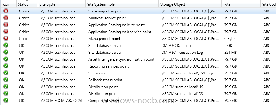

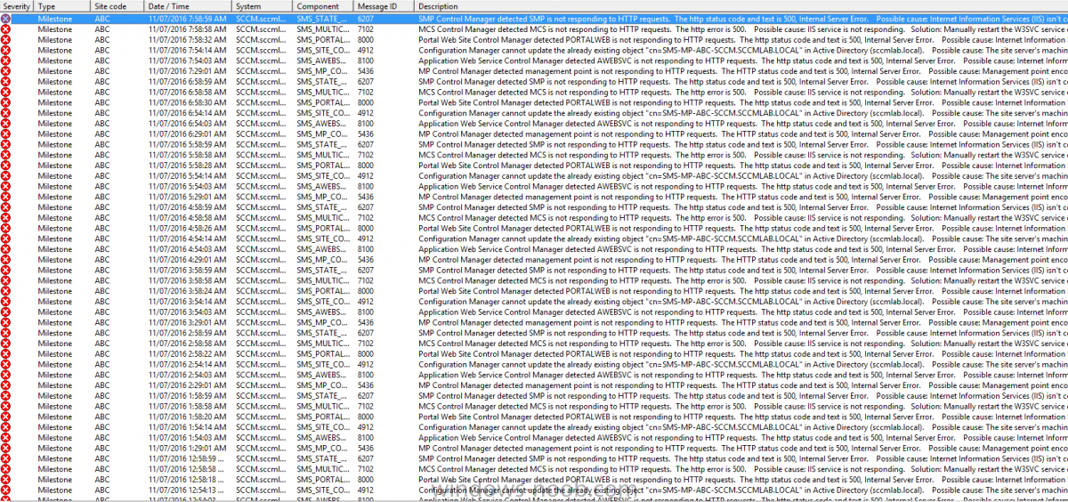

	Hi Guys, I've just logged into my SCCM lab after not using it for a while and I've noticed that there's 5 roles which are showing up as 'critical' randomly. Nothing has changed in the environment which would warrant this as far as I'm aware. Just wondering whether anyone has come across SCCM randomly dishing out these critical errors?
