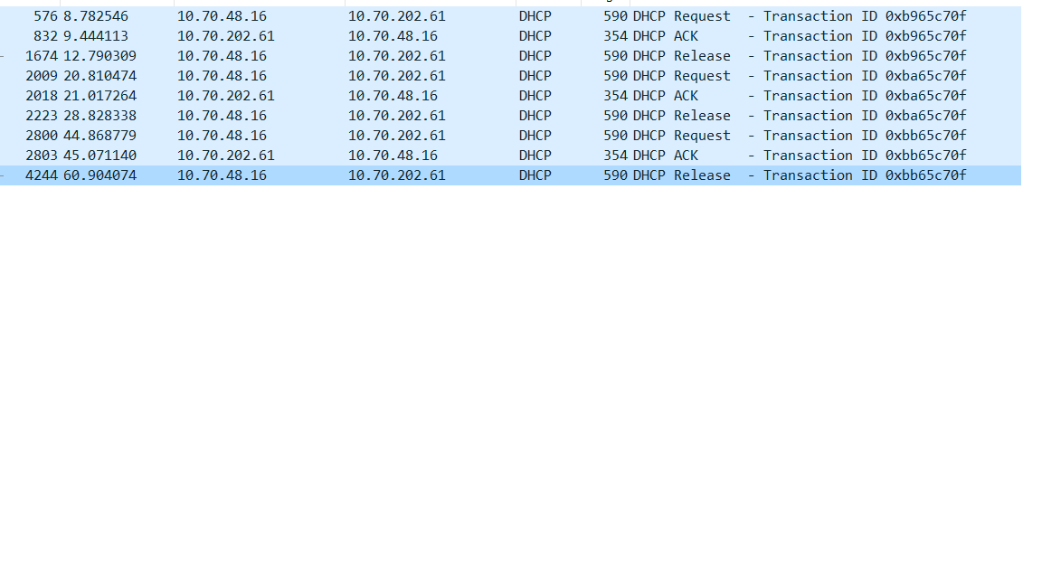

  2. I've looked with wireshark. I don't understand why the DHCP releas happens? See attached file
