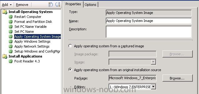

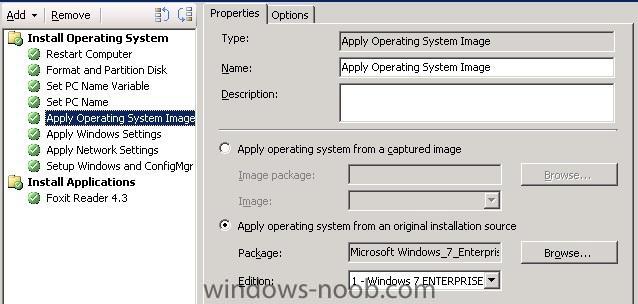

It's being done as an "Apply Operating System Image" task using the "Apply Operating System from original installation source". This option then references a Windows 7 package that had been added under Operating Systems Installation Packages. Attached image shows the task sequence at the moment (which I've recreated from scratch again) with detail of the apply OS image item.
