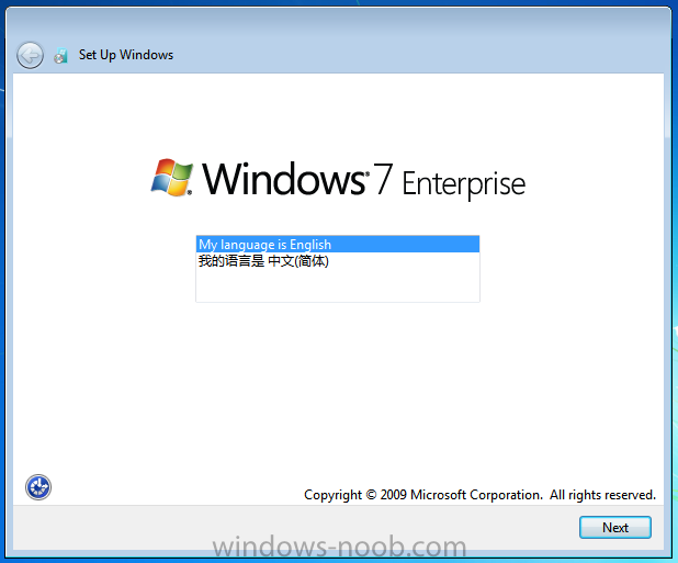

Wooohoooo Resolved this.... Went back to basics, re-created the unattend file in SIM and set the UILanguage to en-US and all is working grand!!

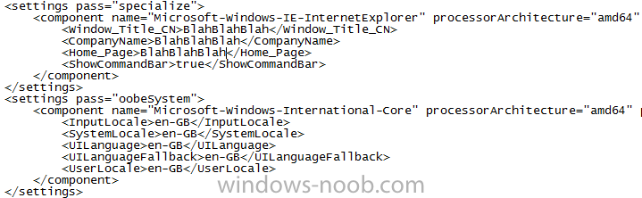

Additional Language Pack…. I’m deploying W7 X64 Enterprise using SCCM 2007 with MDT Integrated (zero’ish touch), no problem there at all… Standard setup en-GB throughout however a requirement has arisen to include the zh-CN (Simplified Chinese) Language Pack for one of our regions. en-GB is to remain the standard but zh-CN needs to installed as an option for the users in that region. The language pack installs great apart from one annoying thing and that is the language option screen in OOBE, the damn thing keeps appearing and it’s driving me nuts! Please see attached file.. I am using our standard unattend file which is minimal and is attached... I have tried the following: Added the International Core (language settings) to the unattend at the Specialize pass – the Prompt Still appears. Removed the Specialize pass from the unattend – the Prompt Still appears. Added Shell Setup and set OOBE to skip machine and user setup – the Prompt still appears. Changed the package source location to be local directory (I read this on this post) – the Prompt Still appears. Have I missed something glaringly obvious..? Any ideas would be greatly received.. Thanks in advance. Rich.

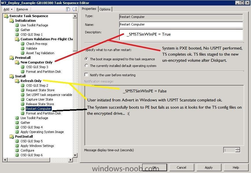

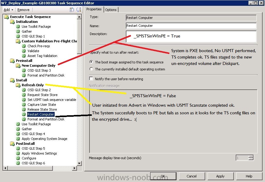

Morning Bronx Bull The OSDStateStore sounds interesting, although because the whole drive is encrypted I wonder if this will still work. Because the TS is running a Refresh(Wipe & Load) it is being run from within the OS… I don’t think you can diskpart the C partition when the OS is running… I totally agree that USMT isn’t the issue..and yep like your TS I have UMST loadstate is in the tail end of the TS, which works as expected. This TS including USMT works absolutely fine on un-encrypted systems, it’s purely the encrypted laptops that are causing the issue.. From the image provided you can see that: Refresh scenario is initiated from within the exisiting OS in order to perform USMT tasks on WinXP or Win7 using the variable = SMSTSInWinPE = False) USMT Scanstate completes…. The system then performs the Reboot task to the associated boot image which stages the following to the encrypted drive in the _SMSTaskSequence directory prior to actually rebooting: TSEnv.dat Backup directory Logs directory WDPackage directory WinPE directory The system the reboots, Checkpoint encryption then prompts for logon credentials which are then entered. Win PE then boots and attempts to initiate hardware devices, however because the disk is not yet accessible and is actually still encrypted at this moment in time the “Unable to read task sequence configuration disk” message is displayed and the task sequence fails Please see the TS attached…

Thanks for your response Bronx Bull…. 3rd party Encryption and OSD really don’t play nice and it’s giving me a bad headache! ;-) All packages are being run directly from the DP’s however when the TS runs it automatically stages the TS config files (_SMSTaskSequence) to a local drive, then boots to PE and references the _SMSTaskSequence directory… I think re-directing the staging directory to a network share sounds like it could get really quire messy, if as you say it is even possible. I will investigate further… I have heared about the Checkpoint filter drivers but from what I have read they seem to be for Bart PE and have not seen or heard of any succesfull SCCM OSD Win PE integrations… Not really possible as the OS is running at the time of TS execution… so the process is: If the user initiates the TS and the config files are staged locally on the encrypted C partition, The TS then runs USMT and stores data on the SMP The system then reboots to WinPE (I will test the following tomorrow) Create TSHook and a Diskpart script to run prior to the TS starting which blows away the encryption & _SMSTaskSequence directory and creating a new un-encrypted file system acessablie from WinPE I will test but I expect the TS will fail as the _SMSTaskSequence containing the TS config files has been blown away by Diskpart…unless I’m missing something?? I suspect for the encrypted laptops I will need to remove USMT from the TS and use Separate TS’s for Back-up (USMT Scanstate) and Restore (USMT Loadstate) and have the field guys PXE boot the encrypted laptops and process the TS as a “New Computer” thus blowing away the encryption straight away - Only after the user has successfully run the BackUp TS though….. Fun & Games… J Rich.

Morning All, any ideas on this one would be greatly appreciated. I am deploying our captured image using one task sequence that caters for the Bare metal and Refresh (now Wipe & Load I believe) scenarios, this has worked fined until we perform a Wipe & Load on the Checkpoint Encrypted laptops in the fleet. These laptops have all partitions encrypted leaving no un-encrypted estate on them. You may already see where I am going with this…. The task sequence is being advertised to the user who runs the TS from within Windows enabling the capture of USMT data to the SMP. Once the USMT Capture is complete the system is rebooted to the PE boot image in order to run diskpart and apply the image etc…. This is where the TS fails. The Task Sequence config files have been staged to the c:\_SMSTaskSequence directory which is of course Encrypted within PE, we then receive the “Unable to read task sequence configuration disk.” I have seen a number posts elsewhere that mention using a “Hook” that runs a diskpart script upon the restart to clean and re-partition the disk before TS begins to process. I am a little unsure how this would work as the config files will have been “blown away” by the diskpart script and surely the TS will fail again with same error, can any confirm my suspicions? I have also seen some articles that mention changing the location of the Staging config files from c:\_SMSTaskSequence to x:\_SMSTaskSequence . Again I’m a bit unsure about this as I didn’t think X: was accessible prior to loading the PE boot image. I hope this makes sense. I look forward to hearing any suggestions.. Kind Regards, Rich.
