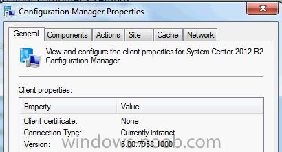

I am having a problem installing Configuration Client and Applications on my test VM via UDI Task sequence.
Configuration manager looks like this when entering windows right after deployment:

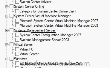

I have 0 Updates on SCCM server so that might be an issue if some kb is adressing this issue but i don't have the option to choose sccm 2012, only sccm 2007 and 2003:

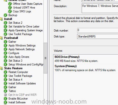

I always gave 15GB of hdd space to VM and it installed always on E drive:
I correct it now as I am writing this to deploy windows to C: drive

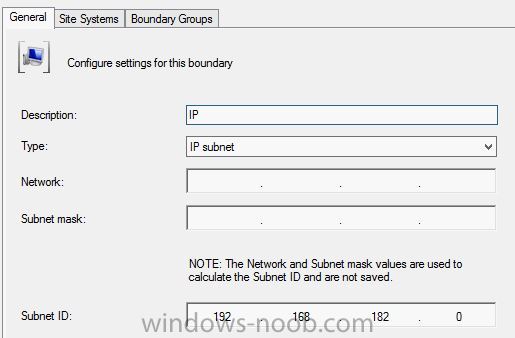

Boundaries:
SCCM 2012 is with CU3

Just add "OSDPreserveDriveLetter=False" before the Apply OS step, which allows the task sequence to auto-correct the issue.

I will try your solution but I think my problem is that in build and capture TS the image already contains SCCM client and this new UDI TS tries to overwrite it and does not succeed.

The problem was the image of windows 7 which had already configuration manager inside + additional step from new MDT UDI TS = not working.
But I must say that the error description in the logs is for me totally unclear, you cannot deduct anything.
