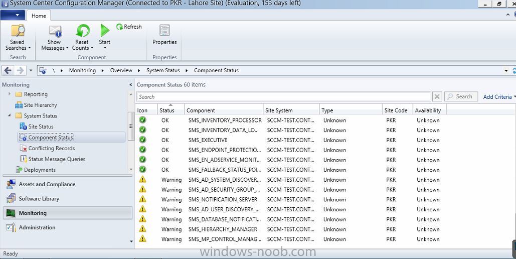

I am using VMWare workstation environment to setup an SCCM 2012 environment. I am able to set up DNS, AD, SQL & SCCM Server so far but getting critical error on MP and some of the components showing warnings as attached.
I have increased the schema, given the full rights to the user on SCCM server, allowed the Firewall ports in AD
I am not sure what is lagging and where am I making mistake. Please guide me.
I have also attached log file created during installing client on Win 7 by using client push method.
Pls Note: I am not well versed with Servers.

ccmsetup.txtFetching info...
GetDPLocations failed with error 0x80072ee7
Failed to get DP locations as the expected version from MP 'SCCM-TEST.contoso.com'. Error 0x80072ee7
Failed to get client version for sending state messages. Error 0x8004100e
The client is finding the MP but is is unable to resolve the distribution point. Make sure you have defined your boundaries and that your servers have static IP's (or at least make sure DNS has accurate info). Probably need to double check your firewall settings and IIS permissions as well. I would also start using CMtrace to look at your logs as it highlights any failures and helps you troubleshoot.
