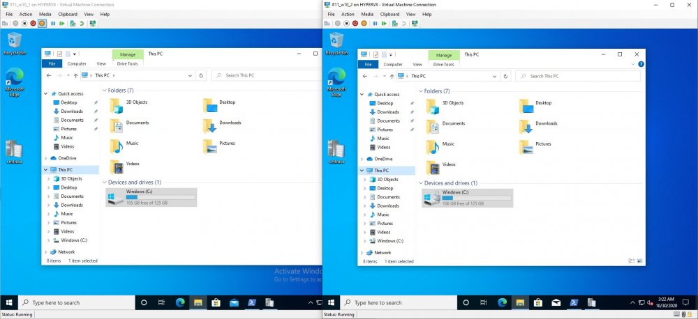

Opening Windows File Explorer on both vm's show's that clearly the vm on the right is encrypted, while the vm on the left is not.

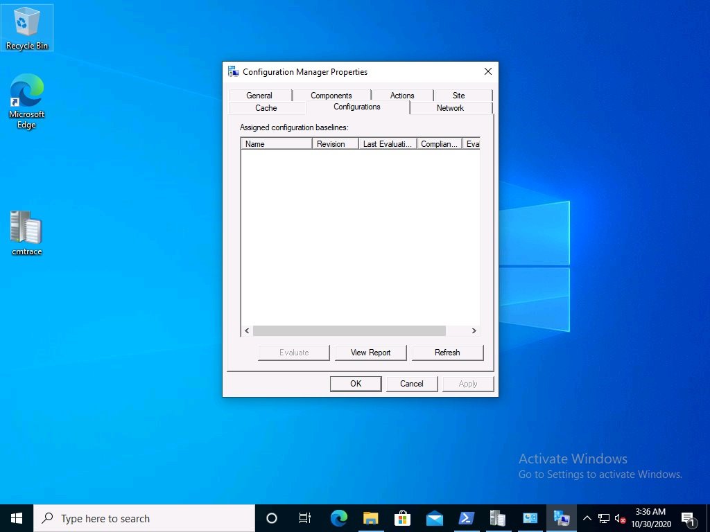

and we can see that there is no BitLocker Management related policy shown in the ConfigMgr client agent on either of the two virtual machines

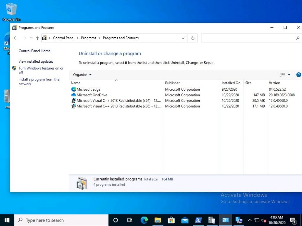

A quick check of programs installed, reveals that the MDOP MBAM client Agent is not installed on either Virtual Machine. This agent is responsible for interpreting the BitLocker Mangement policy settings and acting accordingly.

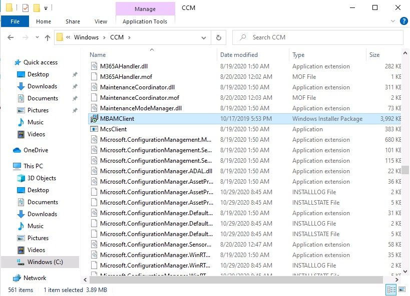

This MDOP MBAM client agent installation file (MSI) is present in the ConfigMgr client agent files path (C:\Windows\CCM\MBAMCLIENT.MSI) even when the no BitLocker Management policy is deployed to the client.

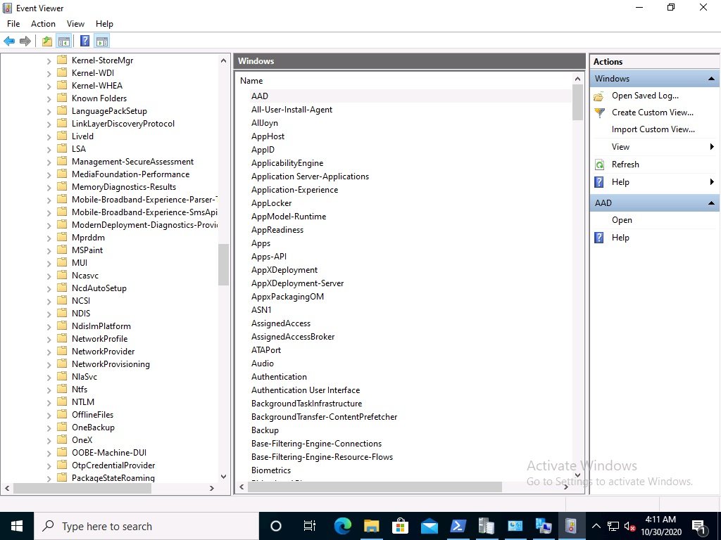

There will be no MBAM related events (or folders) in the Event Viewer at the following path Applications and services logs\Microsoft\Windows\

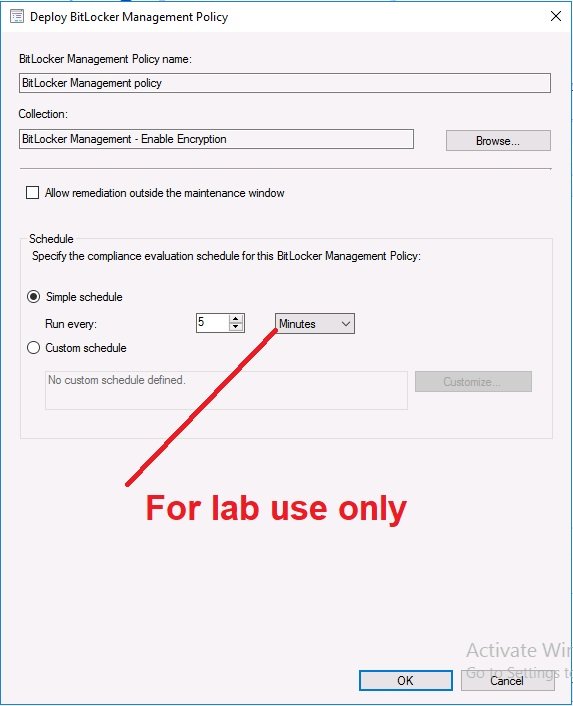

So now that we've seen what client computers look like when not targeted with BitLocker Management policy, let's go ahead and deploy policy the previously created policy to them.

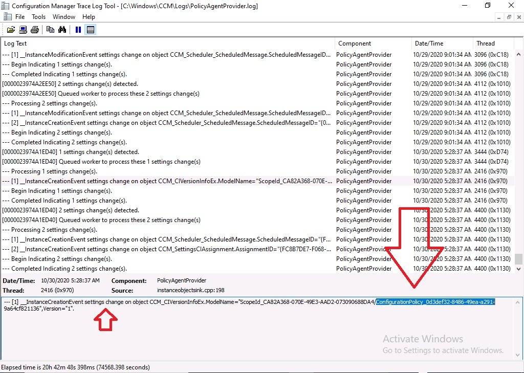

The first indication that there's a change comes from the PolicyAgentProvider.log on the client, where it see's the new policy and refers to it via it's ScopeID.

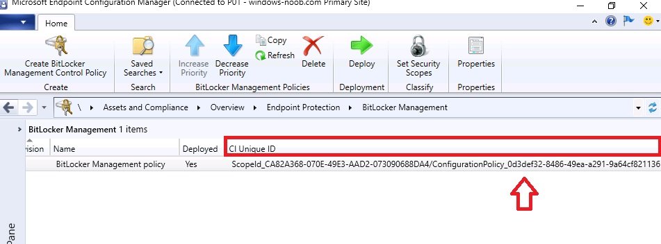

You can confirm that this is indeed the policy by enabling the CI_Unique_ID column in the Configuration Manager console for your respective BitLocker Management policy.

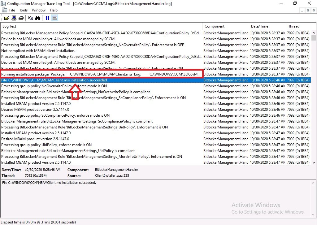

The BitlockerManagementHandler.log records details about BitLocker management policies, the installation of the MBAMClient.msi (MDOP MBAM client agent) and whether the configured policy is compliant or not.
Below you can see the BitlockerManagementHandler.log showing the installation of the MBAMClient.msi.

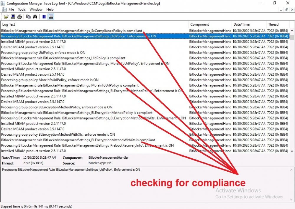

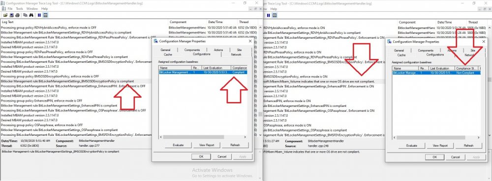

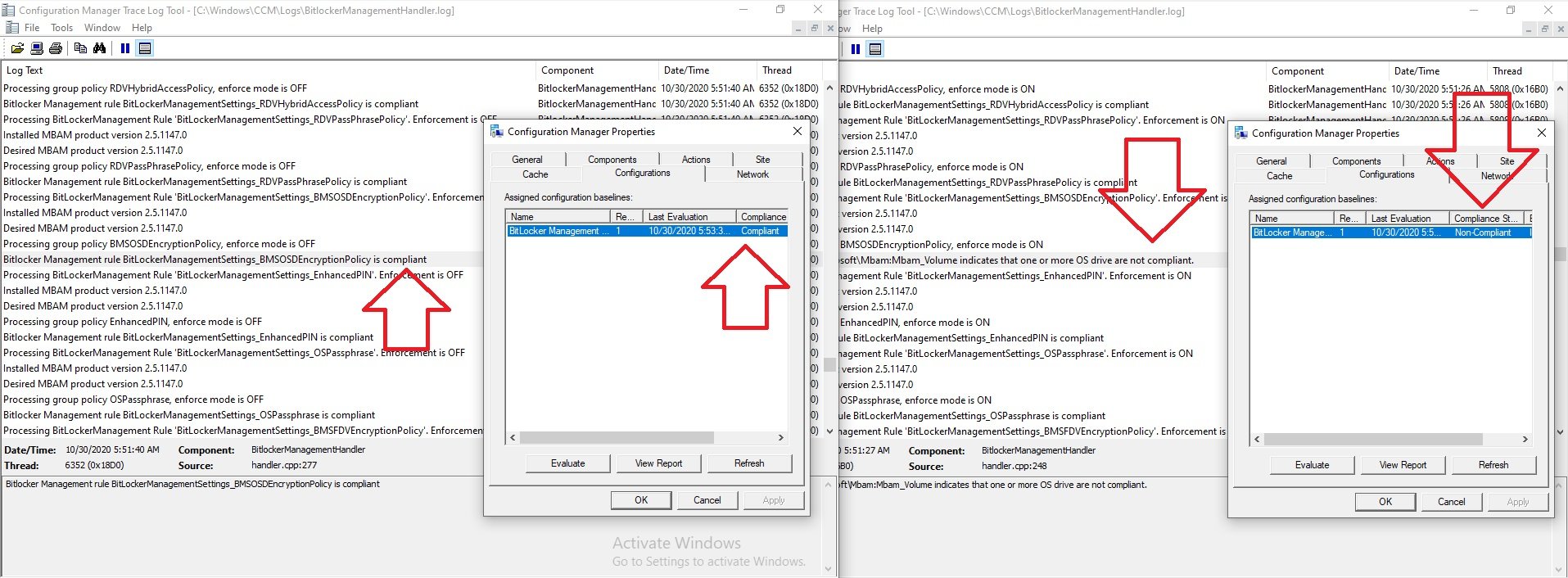

Below you can see the BitlockerManagementHandler.log showing that it's checking for compliance
and after the MDOP MBAM agent is done enforcing policy the computer will be marked Compliant or Non-Compliant. On this vm everything was compliant so the configuration baseline was marked as compliant.
If you remember in the start of this blog post we had two virtual machines, one had no encryption configured (vm1) while the second had XTS-AES 128 configured, and that does NOT match our BitLocker Management policy of XTS-AES 256 therefore it is marked as non compliant even though it is encrypted.

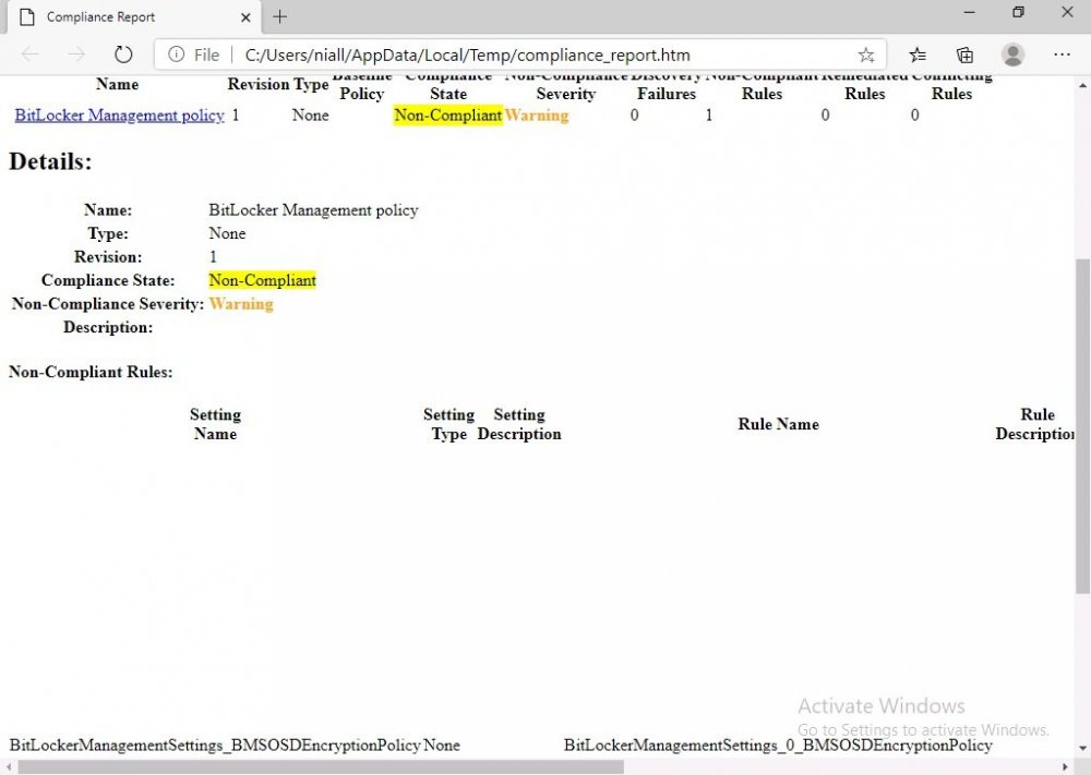

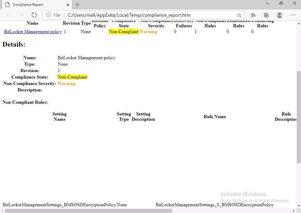

You can also look at the built in report for the Configuration Baseline by clicking on View report to see why it's not compliant, it's not that clear but if you see at the bottom of this report it's referring to the BMSOSDEncryptionPolicy and that's because the algorithm is different to the policy.

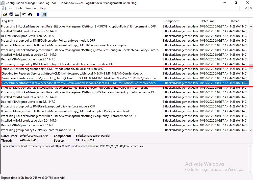

After checking for compliance the log reports on whether or not it can reach the BitLocker Management recovery service. Below you can see a successful connection to the recovery service.

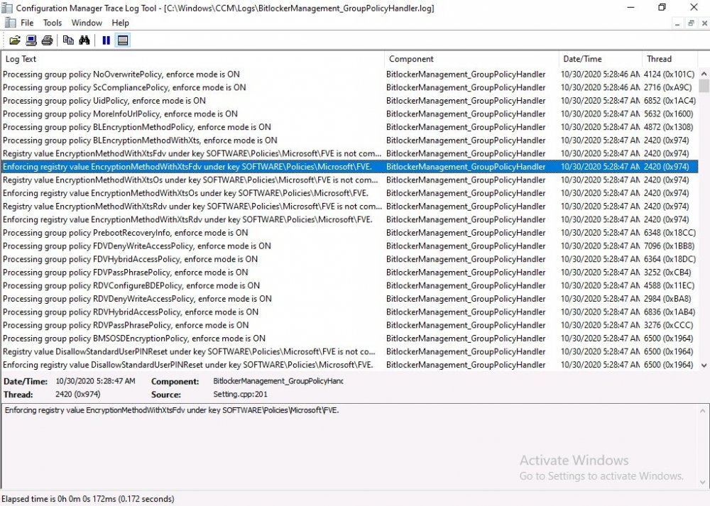

The BitlockerManagement_GroupPolicyHandler.log records information about the presence of Local Group Policy settings which are written to the registry and if appropriate, enforces them.

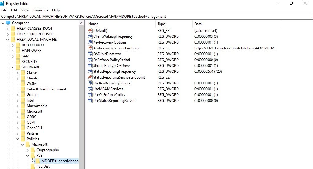

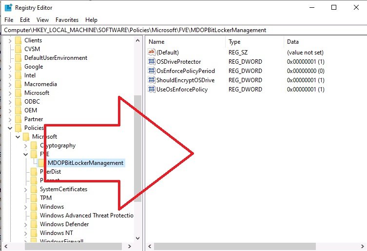

Below you can see the registry settings are now populated.

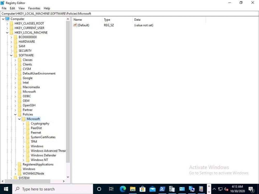

if it looks like there are several registry keys missing (such as in the example below)

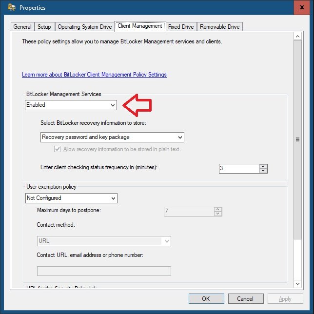

then double-check that you've configured and enabled the BitLocker Management Settings in the Client Management setting of the configured BitLocker Management policy

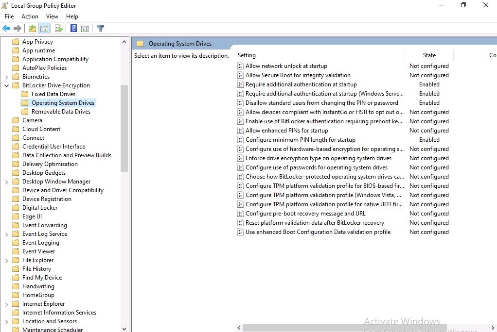

Once the registry keys are populated correctly, they'll be reflected in Local Group Policy settings on the clients.

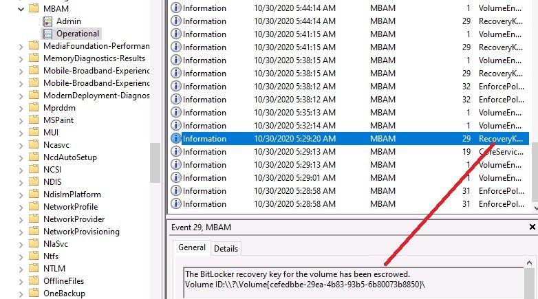

Lastly, the MDOP MBAM agent logs the success or failure of it's actions to the event viewer and includes information about whether or not it can reach the Recovery Service as you can see in the example below:
and it will also log the escrowing of recovery keys.

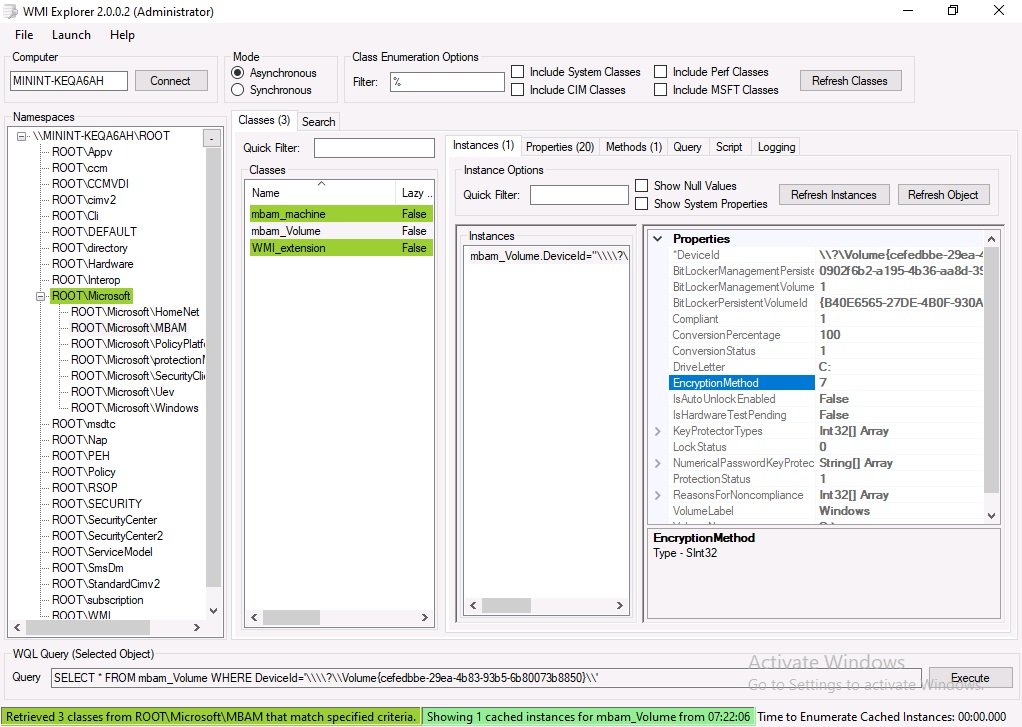

Reviewing Policy using WMI Explorer
You can also use WMI Explorer 2.0 to take a closer look at policy on the client computers, browse to ROOT\Microsoft\MBAM as shown here (ran as Local Administrator).
and below you can see the two virtual machines side by side showing compliant versus non-compliant in WMI Explorer

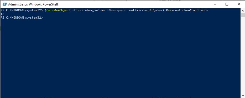

Using PowerShell to determine non-compliance
You can use Powershell to determine non compliance, for example:
(Get-WMIObject -Class mbam_Volume -NameSpace root\microsoft\mbam).ReasonsForNonCompliance
and the results returned (16) match what was seen in WMI Explorer on the already encrypted client.

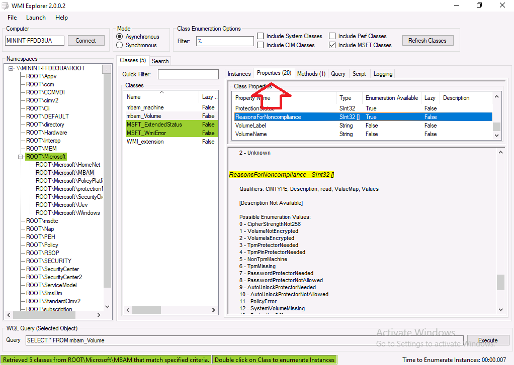

or simply click on the Properties tab in WMI Explorer, and look what it reveals for that Property.
