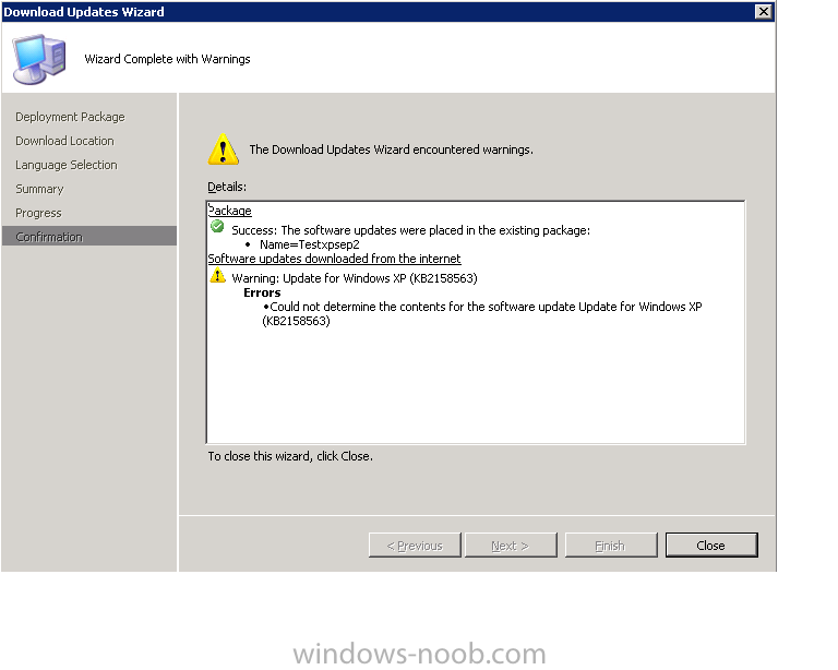

  On 9/30/2010 at 10:49 AM, konetie said:
can you check the patchdownloader.log ,if the pactch is downlaoded to the package destination location or not ?
hi,
i have checked the patchdownloader.log there are no entries today. the destination location is also empty.
thanks.
  On 9/30/2010 at 11:37 AM, satish23 said:
hi,
thanks.
Are you able to download other patches except this or this is only causing problem while downloading ?
can you check the downlaod link from SCCM for the particular patch and see if you are able to downlaod it ?
hi,
this is happening for all the patches, i am able to download the patch directly from browser, in fact to explain this i had a similar issue last month where i had to reinstall the complete server and it started working after that. this problem re-appeared from last week. this is happening for any patch that i try to download.
