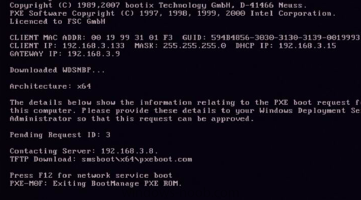

I´m facing a weird problem, which I try to solve for some days now.
I have a Fujitsu-Siemens NX40 (which is basically a RX300S3), which I´d like to deploy Windows 2008R2 to.
I do get an advertisement, and "press F12" comes up. When I do press F12, it aborts PXE-Boot.
I get various entries in smspxe.log (posted later). SCCM 2007R2 is used.
It found the MAC-Adress, so I cleared the PXE-offer, delted then the entry and also deleted the advertisement on that collection. Afterwards I deleted the collection too.
It won´t PXE-boot anyways.
The strange thing is: a VM (Workstation) I created with the exact same MAC-Adress is booting fine, so does other VMs with 2008R2. Just this particular physical machine is causing me headache.....
Find the (freshly created) smspxe.log and a screenshot of my KVMoverIP Switch attached. Maybe one of you guru´s can help me out of that??
Thanks in advance
Guybrush
PS.: I ran the "MAC - Computers for a specific MAC address" report, and it didn´t find any matches for this MAC. So it should be in the "Unknown Systems" Collection. Other Unknown Systems are behaving fine.
