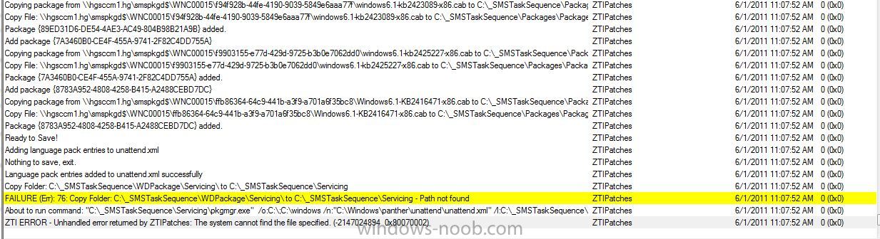

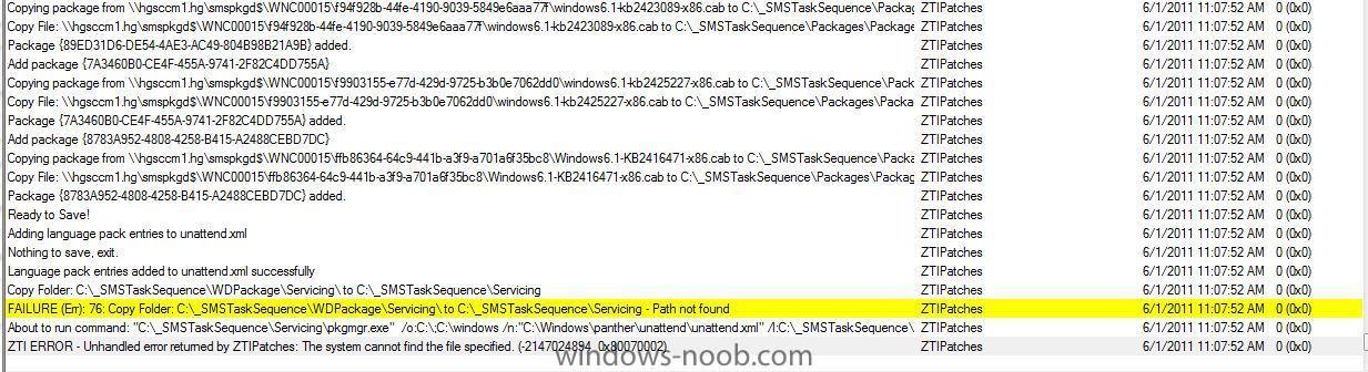

I was not using a toolkit package... ;( I do find alot of this criptic and suprisingly enough, google does not have a lot of info for some of these errors. I have created a toolkit package by creating a dummy MDTS and specifying a folder to create the Toolkit package to. I now have it in this order:
Use Toolkit Package
Install Software Updates Offline
Setup Windows and configmgr
It looks like it is able to copy all the updates over to the computer, but then it fails copying all the updates to a different folder. I did some searching of the oracle, and the couple of posts that matched my errors were from people that tried manually creating Toolkit package by copying the files to a shared location. I'm going to try recreating the toolkit package and see if that helps.
