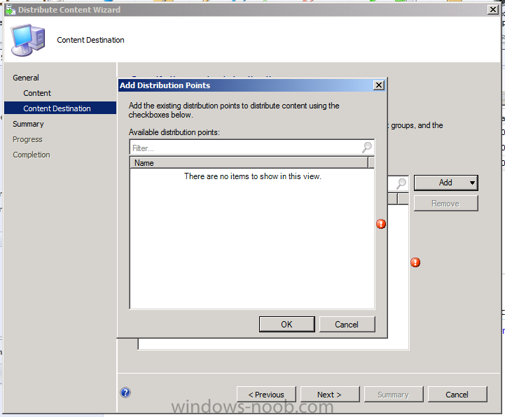

I have, with success, setup a SCCM 2012 site that has the following:
--> 1 distribution point
I have also installed MDT 2012 and integrated this with SCCM. Today, I have ran through Steps 17 and 18 of your SCCM 2012 guide, and now I have an issue
When deploying objects (for example, a task sequence) to my distribution point, no available distribution points are listed. I have checked the health of the distribution point, which is OK
So, basically, I am stuck, for now and am asking for some help ...
-- Matt
When you distribute a task sequence basically all its doing is distributing the content the task sequence uses. If that content has already been distributed when you created it no DP will show up as it's already being used. Go to to Monitoring - Distribution Status - Content Status and see if your packages show to already be distributed to your distribution point.

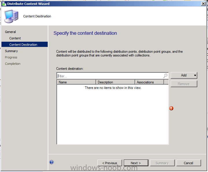

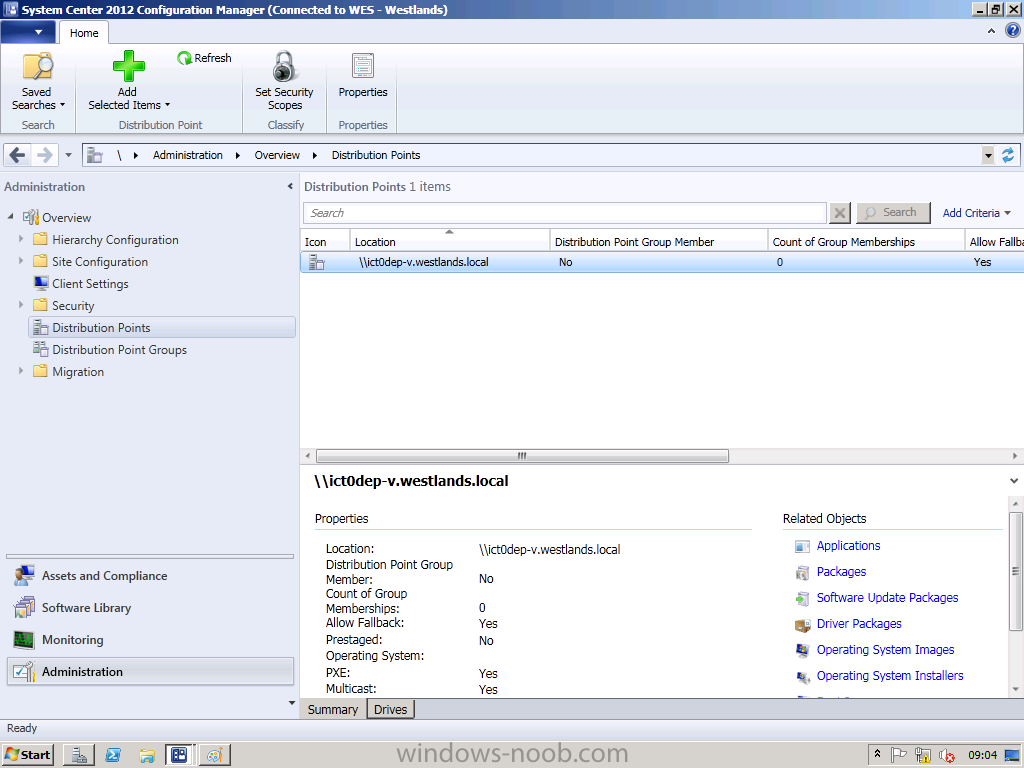

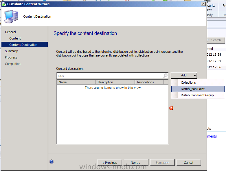

Hey
The screenshots show the process I have made for distributing the content (in this case, a task sequence) to the distribution point. This is the same sequence of event I have been going through for other content added to the distribution point
In all cases, apart from adding a distribution point to a distribution group, I am unable to view the distribution point as referenced in the third screenshot
-- Matt
When you look at all of the content that's in the task sequence is it already distributed?
The task sequence itself won't be distributed as task sequences only need be deployed. When you click distribute content on a task sequence it's actually going to distribute all of the content in the task sequence. However, if all of the content has already been distributed SCCM will not show you any distribution points in the list when you try to again. Go into your packages that are in your task sequence and see if all of the content is distributed. If it is this is your problem.
