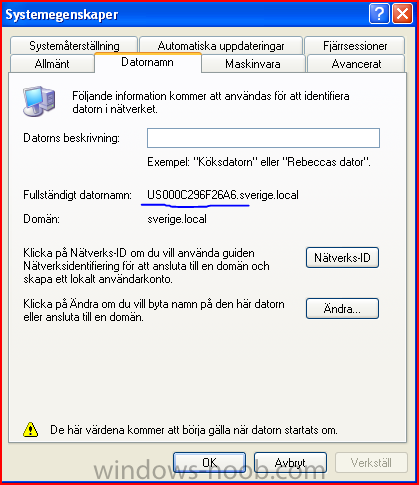

Try this script:
It will change your computername to US+MACADDR (without any ":")
Example (XP in swedish but i think you understand how it works):
After this script has run you need to restart your computer and if your computer was in a domain you need to readd the computer to the domain.
If you need more help with this give me a ping and ill show you how to do a script that will allso rejoin the computer to a domain.

This is only tested on winXP, will get back to you guys once tested on Vista. Will allso upload an english picture once i get the chance ;)
Forgot to write that you should save the above code as a .vbs script.
