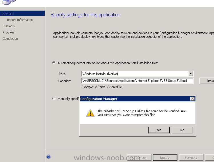

I just started with IE9 too and went the IEAK way as I need to add some trusted sites, modify the security level of these sites (and I also add the most used company related url in the fav bar).
it smoothly created the msi but when I want to add it as an application I received a warning:
I acknowledge the error and then add it as an application in my TS (a simple deploy win 7 x64).
and same as you face I doesn't get installed. (no error message during the TS)
I'm still trying to find which log(s) I should check for applications install (might be related to the publisher warning)
