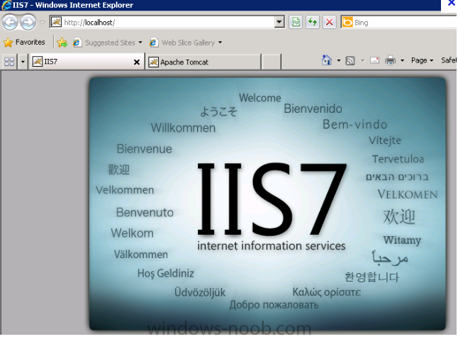

Please can some one confirm if the below image is correct when you type in the URL for a DP/MP for SCCM 2012 - I am trying to do a OSD but my smsts.log is saying the below:

When i go onto my DP Server and type in the URL i get the IIS screen - is this correct or should i see the file available?

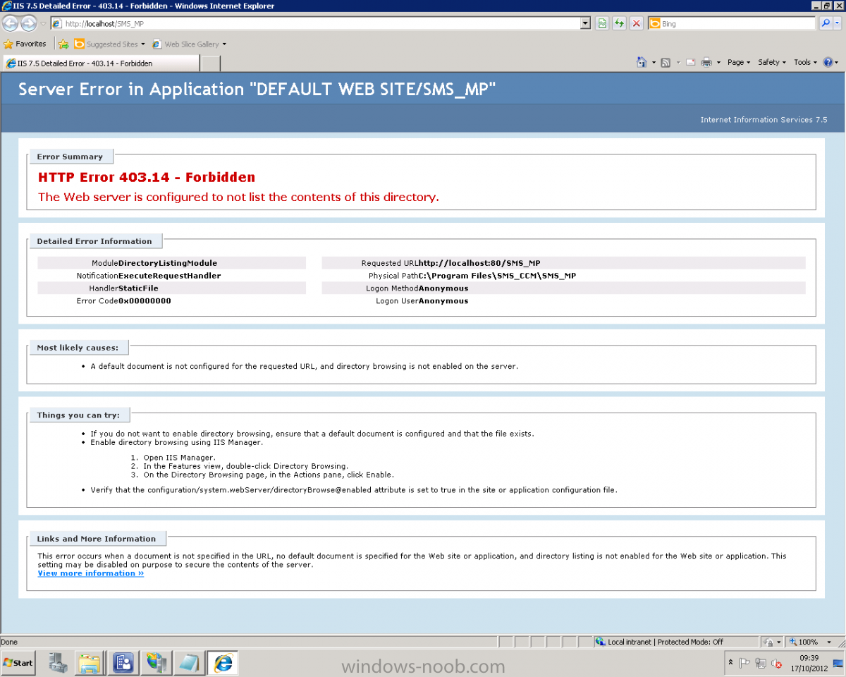

Hi Rocket Man
yes sorry the screen shot you see is what i do see, i sent you an error i got on one of the web pages within the IIS folder. Resolved that by enabling directory browser.
