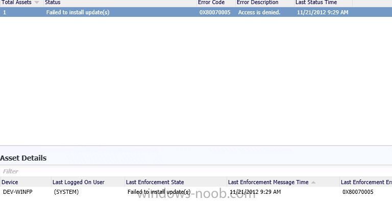

Hello All,
I'm having a problem with my SCCM environment and I was hoping someone would point me in the right direction. In my environment, I have an SCCM server, a SQL server and a WSUS server. The SCCM server can communicate with the SQL server and is able to pulll down the updates from that WSUS server. I was able to successfully push the client out to 60 servers on our network with no problem. The problem I'm having is the SCCM server is able to patch itself but is unable to patch any other server. I believe it's a group policy issue but not sure which policy needs to be turned off in order to be able to push out the updates successfully. Attached is a picture of what I'm seeing.post-18306-0-85373900-1354056663_thumb.png
Have you checked the update logs on the client or server? They may tell you where the denial is happening.
