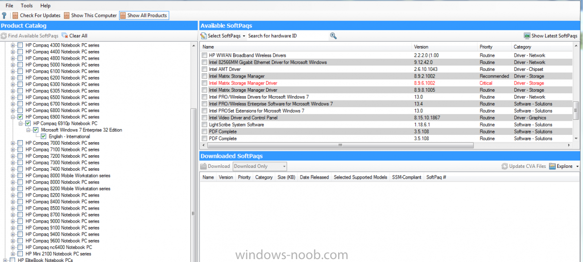

I have done a search and it appears that the required file is sp46134.exe
So I downloaded and ran this file (just ran the EXE manually on the laptop) it brings up the install and runs through fine with no errors.
But in device manager it will still say those drivers are not there. I hope this makes sense as I am never very good at explaining myself.
What you say to do:
Download all the drivers for the 6910p and install them one by one and hope that one works then use that in sccm.
I am just trying that now and see how I go but just wanted to make sure I was reading that right,
Damn it!
wouldn't you know the first one that I try from HPDM worked! Seems to be a newer one that what I was using.. Sometimes it pays to go back to basics.
Thanks for the help, I wouldn't have done that without the prompt. I'll throw it to SCCM and hopefully everything goes OK.
Worked perfect, can't believe it was a dumb version mismatch.
Turns out the first one I had was for versions up to vista but the other one was windows 7 only.
