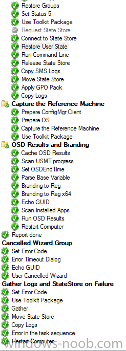

Problem: Restore User State in the Task Sequence is not restoring User Profiles. When you log in as the user where Capture User State is performed, nothing is moving over.
Validation: C:\StateStore\USMT is being created and I can see all Captured User State files and folder.
Unable to Resolve: Loadstate from the same USMT package used to run Capture User State is not working as intended. Steps run through, but looking at the logs, this is all I can see:

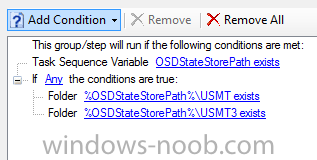

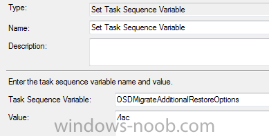

Property OSDMigrateAdditionalRestoreOptions is now = /hardlink /nocompress ztiuserstate 5/16/2013 4:23:03 PM 0 (0x0000)
