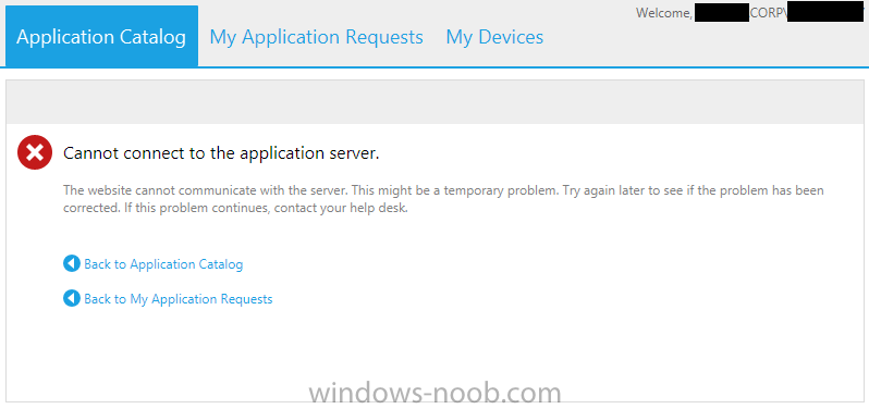

When I hit the Application Catalog URL I get the error: "cannot connect to the application server" (see screenshot).

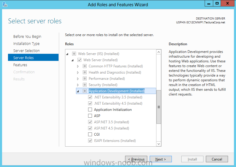

I googled my butt off and found that this is normally due to dotnet WCF Activation > HTTP Activation features not being installed. I've confirmed that these are all installed as required (initially they weren't, so I thought I'd solved the problem... alas it remains).

But I can also confirm that IIS has ASP.NET 4.5 installed.
I dug up the dism cmdline to do that IIS registration, as a few google hits mentioned that even if it was installed in features it can still sometimes need a poke:
C:\Windows\system32>dism /online /enable-feature /featurename:IIS-ASPNET45

I also just messed around with the App Pool settings in IIS for both the CMApplicationCatalog and CMApplicationCatalogSvc, if I switch them to use the default app pool the website throws a 500 error. The fact that my CMAppCat site actually loads the basics leads me to believe that it is failing to connect to the Management Point server.
I've been testing using NetMon and I can see traffic being sent back and forward between the AppCat webserver host and the MP.
Driving me bonkers :(
I went through the steps set out on this TechNet article to "verify the installation of the roles". Everything looked good, but then I checked the ServicePortalWebService.log file and felt like an idiot.
[7, PID:4220][07/17/2013 14:06:20] :System.Data.SqlClient.SqlException: A network-related or instance-specific error occurred while establishing a connection to SQL Server. The server was not found or was not accessible. Verify that the instance name is correct and that SQL Server is configured to allow remote connections. (provider: TCP Provider, error: 0 - A connection attempt failed because the connected party did not properly respond after a period of time, or established connection failed because connected host has failed to respond.)
at System.Data.SqlClient.SqlInternalConnection.OnError(SqlException exception, Boolean breakConnection)
at System.Data.SqlClient.TdsParser.ThrowExceptionAndWarning(TdsParserStateObject stateObj)
at System.Data.SqlClient.TdsParser.Connect(ServerInfo serverInfo, SqlInternalConnectionTds connHandler, Boolean ignoreSniOpenTimeout, Int64 timerExpire, Boolean encrypt, Boolean trustServerCert, Boolean integratedSecurity, SqlConnection owningObject, Boolean withFailover)
at System.Data.SqlClient.SqlInternalConnectionTds.AttemptOneLogin(ServerInfo serverInfo, String newPassword, Boolean ignoreSniOpenTimeout, Int64 timerExpire, SqlConnection owningObject, Boolean withFailover)
at System.Data.SqlClient.SqlInternalConnectionTds.LoginNoFailover(String host, String newPassword, Boolean redirectedUserInstance, SqlConnection owningObject, SqlConnectionString connectionOptions, Int64 timerStart)
So yeah, it is the connection back to the SQL host which is gumming up the works.
