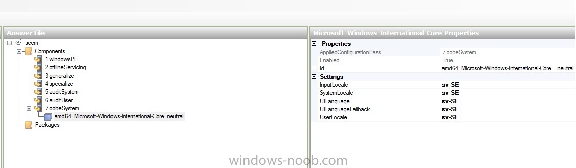

Hi everything is working fine for me. OS deployment, Drivers And application deployment. One thing that i didnt secceed with is changing the keyboard language. i already created a package with xml file "as shown in the attahed file" and added it to the Apply Operating System. Regards
