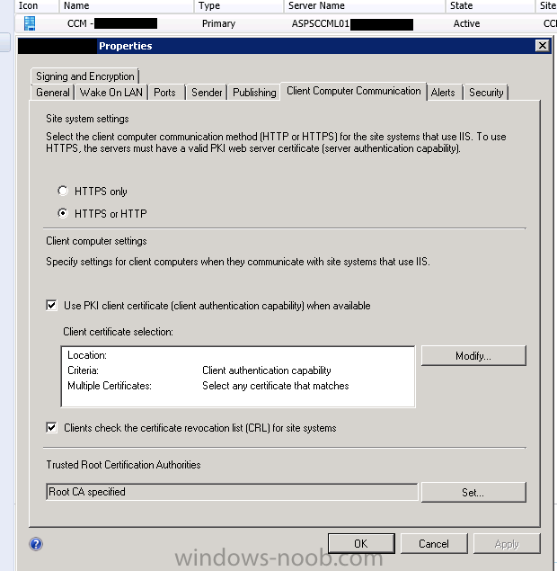

I finally found what went wrong: when first setting up the MP I installed it to use HTTPS only. I went on to configure the DP and so on and later on reconfigure on the MP to allow HTTP and HTTS requests. the error in smstslog on the DP is in fact pretty explicit: Initializing HTTP transport. OSDSetupHook 6/5/2012 11:05:42 AM 1928 (0x0788) Setting URL = https://CORPSCL01.company.com/NOCERT_SMS_DP_SMSPKG$/CCM0000A. OSDSetupHook 6/5/2012 11:05:42 AM 1928 (0x0788) Address=https://CORPSCL01.company.com, Scheme=https, Object=/NOCERT_SMS_DP_SMSPKG$/CCM0000A, Port=443. OSDSetupHook 6/5/2012 11:05:42 AM 1928 (0x0788) Setting Authenticator. OSDSetupHook 6/5/2012 11:05:42 AM 1928 (0x0788) Set authenticator in transport OSDSetupHook 6/5/2012 11:05:42 AM 1928 (0x0788) Setting Media Certificate. OSDSetupHook 6/5/2012 11:05:42 AM 1928 (0x0788) WinHttp credentials set OSDSetupHook 6/5/2012 11:05:42 AM 1928 (0x0788) CLibSMSMessageWinHttpTransport::Send: URL: CORPSCL01.company.com:443 PROPFIND /NOCERT_SMS_DP_SMSPKG$/CCM0000A OSDSetupHook 6/5/2012 11:05:42 AM 1928 (0x0788) In SSL, but with no client cert OSDSetupHook 6/5/2012 11:05:42 AM 1928 (0x0788) Error. Received 0x80072efd from WinHttpSendRequest. OSDSetupHook 6/5/2012 11:05:45 AM 1928 (0x0788) connect (sock, (struct sockaddr *) &SockAddrIn, sizeof (struct sockaddr_in)) == 0, HRESULT=8007274d (e:\nts_sccm_release\sms\framework\osdmessaging\libsmsmessaging.cpp,725) OSDSetupHook 6/5/2012 11:05:46 AM 1928 (0x0788) socket 'connect' failed; 8007274d OSDSetupHook 6/5/2012 11:05:46 AM 1928 (0x0788) hr, HRESULT=80072efd (e:\nts_sccm_release\sms\framework\osdmessaging\libsmsmessaging.cpp,8738) OSDSetupHook 6/5/2012 11:05:46 AM 1928 (0x0788) sending with winhttp failed; 80072efd OSDSetupHook 6/5/2012 11:05:46 AM 1928 (0x0788) oHttpTransport.Send((char*)S_DAVQUERY, (sizeof(S_DAVQUERY)/sizeof(S_DAVQUERY[0]))-sizeof(char), pReply, nReplySize), HRESULT=80072efd (e:\nts_sccm_release\sms\framework\tscore\downloadcontent.cpp,829) OSDSetupHook 6/5/2012 11:05:46 AM 1928 (0x0788) SendResourceRequest() failed with 0x80072efd OSDSetupHook 6/5/2012 11:05:46 AM 1928 (0x0788) SendResourceRequest(), HRESULT=80072efd (e:\nts_sccm_release\sms\framework\tscore\downloadcontent.cpp,572) OSDSetupHook 6/5/2012 11:05:46 AM 1928 (0x0788) oDavRequest.GetDirectoryListing(setDirs, setFiles), HRESULT=80072efd (e:\nts_sccm_release\sms\framework\tscore\resolvesource.cpp,2411) OSDSetupHook 6/5/2012 11:05:46 AM 1928 (0x0788) Retrying download... OSDSetupHook 6/5/2012 11:05:46 AM 1928 (0x0788) Based on the address it is trying to reach at: Address=https://CORPSCL01.company.com, Scheme=https, Object=/NOCERT_SMS_DP_SMSPKG$/CCM0000A, Port=443. It falls back to HTTP and then to SMB to no avail I investigated the the IIS settings on the DP and saw that no certificate was configured. I took our wildcard certificate (I beleive I could have use our internal CA too), install it and configure the default website to use it for https. And bingo, it could retrieve the CM client package I guess the DP never go the update to allow HTTP requests. cheers, Steve

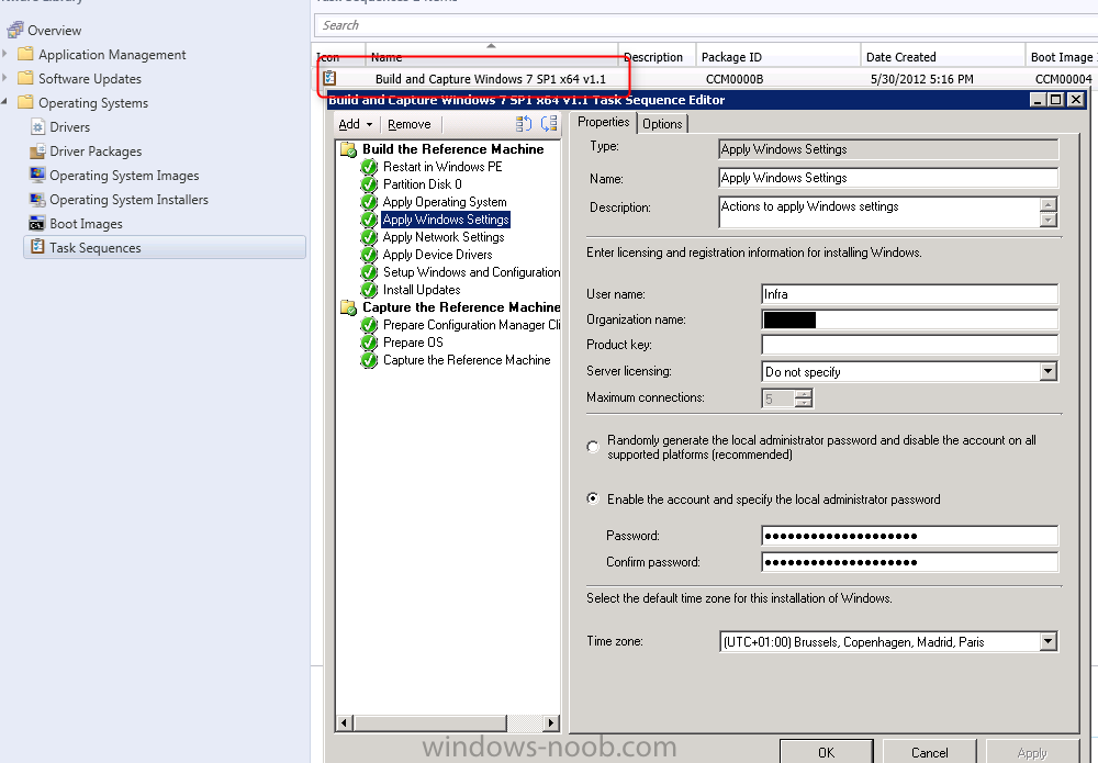

Hello First of all thank you very much for all the guides and the help you provide here !!!! Now based on the guide found at http://www.windows-noob.com/forums/index.php?/topic/4468-using-sccm-2012-rc-in-a-lab-part-7-build-and-capture-windows-7-x64/, I made a small mistake and missed the "and that you DO enter an Administrator Password" when creating the task sequence. As the OS is not part of a domain or is another user configured ... I'm locked out .... So I modified the settings accordingly but I cannot get the client computer to see that modification. Topology is : one main server (in a datacenter) with a dedicated SQL instance and one disribution point in another physical building where I reside with my test computer. I tried by - Right click the task sequence and Deploy (to the same Collection) - I selected all references one by one and Update Distribution point (Bootimage package, OS installation package and CM client upgrade package) When I do 'Distribute Content' and select 'Add Distribution points', only the server in the datacenter is selectable. not my WDS on the client site (which means it is already valid for the task sequence right?) I'm pretty sure it's my distribution point that's missing the new info but I dont know how and where I can push the new version of the task sequence. Thanks for your help Steve
