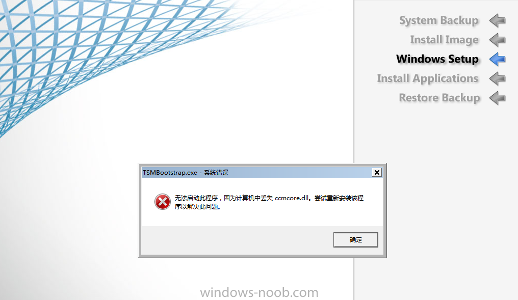

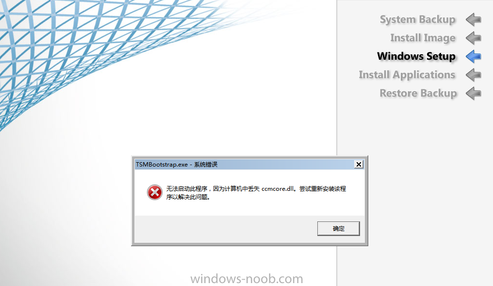

	TSMBootstrap.exe-system error(Deploy win7 ent with UDI-wizard)sxleilong replied to sxleilong's question in How do I ? Hello, maybe you said, when I installed an error, I click OK, then restart the installed system there are two "Software Center", one Chinese, the otherEnglish. ISO image language is Chinese, now install English language pack. Logs.zip
	TSMBootstrap.exe-system error(Deploy win7 ent with UDI-wizard)sxleilong replied to sxleilong's question in How do I ? I am glad that you can pay attention to my problem, I first say thank you! MDT2012Update1(6.1.2373.0)+SCCM2012RTM+beta1 SCCM server: win server 2008 R2 with sp1+SQL 2008R2 with sp2+WSUS3.0 with 2 hotfix+ADK

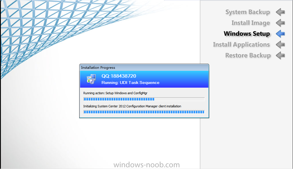

	TSMBootstrap.exe-system error(Deploy win7 ent with UDI-wizard)sxleilong posted a question in How do I ? At this point everything goes smoothly, But, next ,Reported error View smsts.log Tip: Could not execute WMI method SMS Client.SetClient ProvisioningMode Failed to take client out of provisioning mode(ox80041013) Failed to take SMS client out of provisioning mode(ox80041013)
	when I use UDI wizard deploy Windows 7, my UDI task sequence is different than "anyweb Guide", I wanted to know was encountered and how to solve? Note: SCCM2012 with the official version MDT2012(6.0.2223.0)(no update1) test UDI successful deployment,but I cann't use MDT2012 update1 (6.1.XXX) . MDT2012 update1 (6.1.XXX) cann't create User Driven Installation Task Sequence. Anybody counld provide me 'MDT2012(6.0.2223.0) Setup'?
	My current environment: SCCM2012 with SP1 beta+ MDT2012 update 1 +ADK +SQL2008R2 with SP2 But when I use UDI wizard deploy Windows 7, my UDI task sequence is different than "anyweb Guide", I wanted to know was encountered and how to solve? Note: with the official version of SCCM2012+ official version MDT2012(no update1) test UDI successful deployment Or can anyone tell me how the integration with SCCM2012 MDT2012 Update 1 UDI deployment? Thank you!!! Anybody counld privade me 'MDT2012(6.0.2223.0) Setup'?
