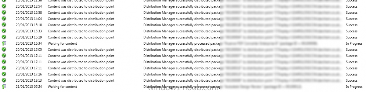

I've just turned off PullDP in the DP properties (I guess SP1 put it on automatically) -- its started copying!! Thanks for the hint anyweb -

I still have this issue. One of the packages which would not copy we just got a new version of, so I added it as a new application (to update via supersedance). This still did not copy to the second DP. The files structure is completely different to the first version (1 cab, 1 msi and a few ini files) - and it STILL does not copy! Any other suggestions would be helpful Also, no, I have not configured anything to do with PullDP (I'd also never heard of it) -
Some applications not copying to second DP (SCCM 2012 SP1)
steven_h replied to steven_h's topic in Configuration Manager 2012
Yes, that and PkgXferMgr.log They all look normal apart from: PullDP Query Result failed. Failure count = 98/100, Restart time = 22/01/2013 00:02:07 GMT Standard Time Which tried 100 times before failing the package at 00:08 last night. The source directory etc is all identical to all the working packages (ruling out permissions or share issues). -
We have SCCM 2012 SP1, and yesterday I installed a second distribution point for some computers in another physical location. OSD/PXE and most applications are working fine from the new DP, but two applications (both consist of many files if that is a possible reason) will not copy over. I don't get an error message, but they are sat waiting on "Waiting for content" as in the screen shot below. The packages are on the primary DP (no issues with that) I have tried modifying BITS settings to allow all file extensions as I thought that might be a potential cause, but it made no difference Any help appreciated.
