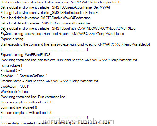

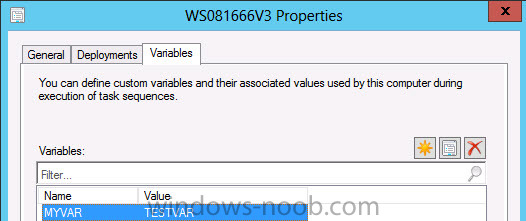

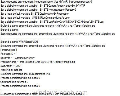

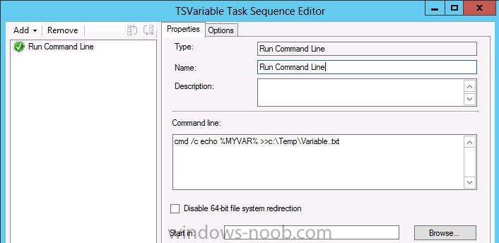

I would like to set custom Variables, at bottom line, I would like to use that in a later step to assign dynamically ip address in the server staging process. So my goal would be, set a computer variable MYVAR = TESTVAR and have that at the end a txt file with the contend TESTVAR. But it looks like I am missing something, any help would be nice. In the computer object I defined in that case MYVAR = TESTVAR: In the TS I call the Variable %MYVAR% and pipe it in a file. checking the smsts.log I can see that the command is executing but not like I mentioned. What I am missing? Thanks for help num63r5
