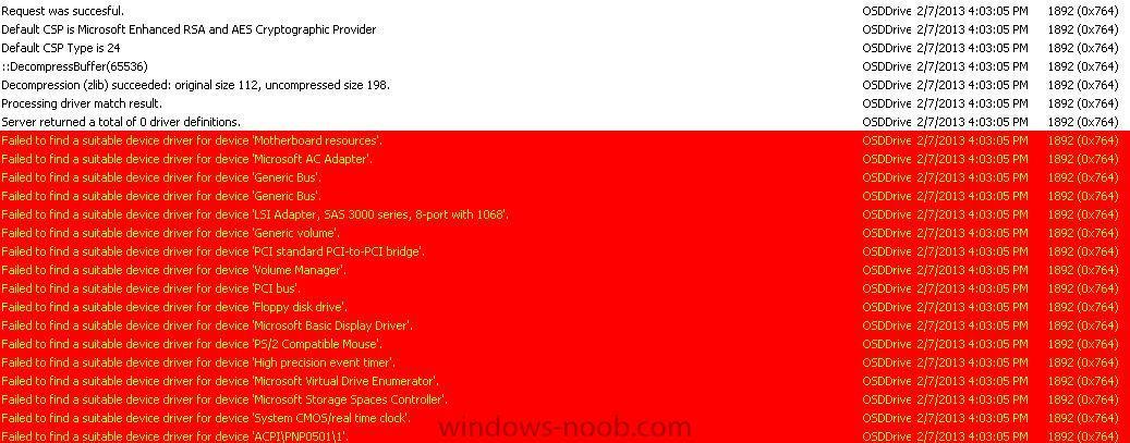

Anyone with a lab (or production) with VMWare VMs? I believe I have spent enough days now to determine my problem is drivers. I have done my homework on how to add VMWare Tools drivers to WinPE, but none of my VMs have a ./Program Files/VMWare/Drivers folder. Any suggestion on how can I get past this? If I go through the "hassle" of setting up a Hyper-V server.. will I have the same drivers issue? Is there anything I may be missing?
using System Center 2012 Configuration Manager - Part 7. Build and Capture Windows 7 X64 SP1
Have you re-distributed your sources? (OS installers, OS Images) I also created new task sequences, confirmed NAS account was configured and have access to path. I believe my problem is drivers. (I was under the impression I would not need drivers for a VMware VM)
DancingFerret: Thanks for the info. I allowed anonymous access to DP, and created a new root folder share. * UPDATE * As this is becoming very frustrating (almost 2 weeks into this) I copied my source files again, created new system images, system installers, task sequences, used my domain admin account instead of sccmnas account, and tried again. Now the TS goes further. After downloading the source files, I see the Windows background change, then says Setting up Windows and Configuration Manager, the background changes again to SCCM 2012 and the TS errors out. Error code: 0x80004005 I have attached a copy of my smsts.log as I don't seem to find an error. * UPDATE 2 * I attached a copy of the smsts.log under X:\windows\temp. This one shows an error during "Setup Windows and Configuration Manager". smsts7.log smsts.log
