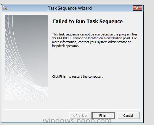

  1. Please help. The error I am receiving is "the task sequence cannot be run because the program files cannot be located on a distribution point" I know there has been other topics concerning this issue. But I've tried a lot of those suggestions. I am booting a virtual machine with an iso instead of PXE booting. I am still in the testing phases of this (obviously). The ID it is pointing to is the configuration manager upgrade. However with that said If I were to delete the current package, rebuild it, distribute and deploy it, the next time I try to run the TS it will point to a different package ID. Say the boot package. Repeating the procedure only keeps changing the package. It is like it just keeps going in a package round robin. I have since added my distribution point to a distribution point group. Nothing. I have verified that my domain is correct in my boundary group. I have verified permissions for a user to copy the files to the distribution group. I am just at a loss. If anyone can give me some direction I would appreciate it. We are running SCCM 2012 sp1 . I attached a log file and a screen capture of the actual errorsmsts.log Thanks all!!! <![LOG[LOGGING: Finalize process ID set to 828]LOG]!><time="09:51:09.874+480" date="04-05-2013" component="TSBootShell" context="" type="1" thread="832" file="tslogging.cpp:1495"> <![LOG[==============================[ TSBootShell.exe ]==============================]LOG]!><time="09:51:09.874+480" date="04-05-2013" component="TSBootShell" context="" type="1" thread="832" file="bootshell.cpp:1052"> <![LOG[succeeded loading resource DLL 'X:\sms\bin\x64\1033\TSRES.DLL']LOG]!><time="09:51:09.874+480" date="04-05-2013" component="TSBootShell" context="" type="1" thread="832" file="util.cpp:963"> <![LOG[Debug shell is enabled]LOG]!><time="09:51:09.874+480" date="04-05-2013" component="TSBootShell" context="" type="1" thread="832" file="bootshell.cpp:1063"> <![LOG[Waiting for PNP initialization...]LOG]!><time="09:51:10.077+480" date="04-05-2013" component="TSBootShell" context="" type="1" thread="856" file="bootshell.cpp:60"> <![LOG[RAM Disk Boot Path: MULTI(0)DISK(0)CDROM(0)\SOURCES\BOOT.WIM]LOG]!><time="09:51:10.077+480" date="04-05-2013" component="TSBootShell" context="" type="1" thread="856" file="configpath.cpp:186"> <![LOG[booted from removable media]LOG]!><time="09:51:10.077+480" date="04-05-2013" component="TSBootShell" context="" type="1" thread="856" file="configpath.cpp:190"> <![LOG[Checking for "D:\SOURCES\BOOT.WIM"]LOG]!><time="09:51:10.077+480" date="04-05-2013" component="TSBootShell" context="" type="0" thread="856" file="configpath.cpp:107"> <![LOG[Found D:\SOURCES\BOOT.WIM]LOG]!><time="09:51:10.436+480" date="04-05-2013" component="TSBootShell" context="" type="0" thread="856" file="configpath.cpp:116"> <![LOG[Remoable media path: D:\SOURCES\BOOT.WIM]LOG]!><time="09:51:10.436+480" date="04-05-2013" component="TSBootShell" context="" type="1" thread="856" file="configpath.cpp:192"> <![LOG[Found config path D:\]LOG]!><time="09:51:10.436+480" date="04-05-2013" component="TSBootShell" context="" type="1" thread="856" file="bootshell.cpp:545"> <![LOG[booting from removable media, not restoring bootloaders on hard drive]LOG]!><time="09:51:10.436+480" date="04-05-2013" component="TSBootShell" context="" type="1" thread="856" file="bootshell.cpp:579"> <![LOG[D:\WinPE does not exist.]LOG]!><time="09:51:10.436+480" date="04-05-2013" component="TSBootShell" context="" type="1" thread="856" file="bootshell.cpp:596"> <![LOG[D:\_SmsTsWinPE\WinPE does not exist.]LOG]!><time="09:51:10.436+480" date="04-05-2013" component="TSBootShell" context="" type="1" thread="856" file="bootshell.cpp:610"> <![LOG[Executing command line: wpeinit.exe -winpe]LOG]!><time="09:51:11.575+480" date="04-05-2013" component="TSBootShell" context="" type="1" thread="856" file="bootshell.cpp:857"> <![LOG[The command completed successfully.]LOG]!><time="09:51:16.021+480" date="04-05-2013" component="TSBootShell" context="" type="1" thread="856" file="bootshell.cpp:939"> <![LOG[starting DNS client service.]LOG]!><time="09:51:16.021+480" date="04-05-2013" component="TSBootShell" context="" type="1" thread="856" file="bootshell.cpp:663"> <![LOG[Executing command line: X:\sms\bin\x64\TsmBootstrap.exe /env:WinPE /configpath:D:\]LOG]!><time="09:51:16.552+480" date="04-05-2013" component="TSBootShell" context="" type="1" thread="856" file="bootshell.cpp:857"> <![LOG[The command completed successfully.]LOG]!><time="09:51:16.552+480" date="04-05-2013" component="TSBootShell" context="" type="1" thread="856" file="bootshell.cpp:939"> <![LOG[==============================[ TSMBootStrap.exe ]==============================]LOG]!><time="09:51:16.629+480" date="04-05-2013" component="TSMBootstrap" context="" type="1" thread="1100" file="tsmbootstrap.cpp:1129"> <![LOG[Command line: X:\sms\bin\x64\TsmBootstrap.exe /env:WinPE /configpath:D:\]LOG]!><time="09:51:16.629+480" date="04-05-2013" component="TSMBootstrap" context="" type="0" thread="1100" file="tsmbootstrap.cpp:1130"> <![LOG[succeeded loading resource DLL 'X:\sms\bin\x64\1033\TSRES.DLL']LOG]!><time="09:51:16.629+480" date="04-05-2013" component="TSMBootstrap" context="" type="1" thread="1100" file="util.cpp:963"> <![LOG[succeeded loading resource DLL 'X:\sms\bin\x64\TSRESNLC.DLL']LOG]!><time="09:51:16.629+480" date="04-05-2013" component="TSMBootstrap" context="" type="1" thread="1100" file="resourceutils.cpp:169"> <![LOG[Adding SMS bin folder "X:\sms\bin\x64" to the system environment PATH]LOG]!><time="09:51:16.645+480" date="04-05-2013" component="TSMBootstrap" context="" type="0" thread="1100" file="tsmbootstrap.cpp:963"> <![LOG[Failed to open PXE registry key. Not a PXE boot.]LOG]!><time="09:51:16.645+480" date="04-05-2013" component="TSMBootstrap" context="" type="0" thread="1100" file="tsmbootstrap.cpp:844"> <![LOG[Media Root = D:\]LOG]!><time="09:51:16.645+480" date="04-05-2013" component="TSMBootstrap" context="" type="1" thread="1100" file="tsmbootstrap.cpp:1000"> <![LOG[Dynamicallly found media is launched in WinPE from CD/DVD']LOG]!><time="09:51:16.645+480" date="04-05-2013" component="TSMBootstrap" context="" type="1" thread="1100" file="tsmbootstrap.cpp:1008"> <![LOG[Executing from Media in WinPE]LOG]!><time="09:51:16.645+480" date="04-05-2013" component="TSMBootstrap" context="" type="1" thread="1100" file="tsmbootstrap.cpp:1041"> <![LOG[Verifying Media Layout.]LOG]!><time="09:51:17.440+480" date="04-05-2013" component="TSMBootstrap" context="" type="1" thread="1100" file="tsmediawizardcontrol.cpp:1581"> <![LOG[MediaType = BootMedia]LOG]!><time="09:51:17.799+480" date="04-05-2013" component="TSMBootstrap" context="" type="1" thread="1100" file="tsmediawizardcontrol.cpp:2565"> <![LOG[PasswordRequired = false]LOG]!><time="09:51:17.892+480" date="04-05-2013" component="TSMBootstrap" context="" type="1" thread="1100" file="tsmediawizardcontrol.cpp:2591"> <![LOG[Found network adapter "IntelĀ® PRO/1000 MT Network Connection" with IP Address 192.168.70.99.]LOG]!><time="09:51:17.909+480" date="04-05-2013" component="TSMBootstrap" context="" type="0" thread="1100" file="tsmbootstraputil.cpp:474"> <![LOG[Running Wizard in Interactive mode]LOG]!><time="09:51:17.909+480" date="04-05-2013" component="TSMBootstrap" context="" type="1" thread="1100" file="tsmediawizardcontrol.cpp:2766"> <![LOG[Loading Media Variables from "D:\sms\data\variables.dat"]LOG]!><time="09:51:17.971+480" date="04-05-2013" component="TSMBootstrap" context="" type="1" thread="1100" file="tsremovablemedia.cpp:322"> <![LOG[no password for vars file]LOG]!><time="09:51:18.049+480" date="04-05-2013" component="TSMBootstrap" context="" type="0" thread="1100" file="tsmediawizardcontrol.cpp:247"> <![LOG[Activating Welcome Page.]LOG]!><time="09:51:18.049+480" date="04-05-2013" component="TSMBootstrap" context="" type="0" thread="1100" file="tsmediawelcomepage.cpp:131"> <![LOG[Loading bitmap]LOG]!><time="09:51:18.064+480" date="04-05-2013" component="TSMBootstrap" context="" type="1" thread="1100" file="tsmbootstrap.cpp:1228"> <![LOG[WelcomePage::OnWizardNext()]LOG]!><time="09:51:22.589+480" date="04-05-2013" component="TSMBootstrap" context="" type="0" thread="1100" file="tsmediawelcomepage.cpp:340"> <![LOG[Loading Media Variables from "D:\sms\data\variables.dat"]LOG]!><time="09:51:22.589+480" date="04-05-2013" component="TSMBootstrap" context="" type="1" thread="1100" file="tsremovablemedia.cpp:322"> <![LOG[no password for vars file]LOG]!><time="09:51:22.604+480" date="04-05-2013" component="TSMBootstrap" context="" type="0" thread="1100" file="tsmediawizardcontrol.cpp:247"> <![LOG[spawned thread 1112 to download policy.]LOG]!><time="09:51:22.604+480" date="04-05-2013" component="TSMBootstrap" context="" type="1" thread="1100" file="tsmediawelcomepage.cpp:405"> <![LOG[Entering TSMediaWizardControl::GetPolicy.]LOG]!><time="09:51:22.604+480" date="04-05-2013" component="TSMBootstrap" context="" type="0" thread="1112" file="tsmediawizardcontrol.cpp:527"> <![LOG[Creating key 'Software\Microsoft\SMS\47006C006F00620061006C005C007B00350031004100300031003600420036002D0046003000440045002D0034003700350032002D0042003900370043002D003500340045003600460033003800360041003900310032007D00']LOG]!><time="09:51:22.604+480" date="04-05-2013" component="TSMBootstrap" context="" type="1" thread="1112" file="environmentscope.cpp:284"> <![LOG[Environment scope successfully created: Global\{51A016B6-F0DE-4752-B97C-54E6F386A912}]LOG]!><time="09:51:22.604+480" date="04-05-2013" component="TSMBootstrap" context="" type="1" thread="1112" file="environmentscope.cpp:659"> <![LOG[Creating key 'Software\Microsoft\SMS\47006C006F00620061006C005C007B00420041003300410033003900300030002D0043004100360044002D0034006100630031002D0038004300320038002D003500300037003300410046004300320032004200300033007D00']LOG]!><time="09:51:22.604+480" date="04-05-2013" component="TSMBootstrap" context="" type="1" thread="1112" file="environmentscope.cpp:284"> <![LOG[Environment scope successfully created: Global\{BA3A3900-CA6D-4ac1-8C28-5073AFC22B03}]LOG]!><time="09:51:22.604+480" date="04-05-2013" component="TSMBootstrap" context="" type="1" thread="1112" file="environmentscope.cpp:659"> <![LOG[setting LogMaxSize to 1000000]LOG]!><time="09:51:22.604+480" date="04-05-2013" component="TSMBootstrap" context="" type="1" thread="1112" file="tsmediawizardcontrol.cpp:555"> <![LOG[setting LogMaxHistory to 1]LOG]!><time="09:51:22.604+480" date="04-05-2013" component="TSMBootstrap" context="" type="1" thread="1112" file="tsmediawizardcontrol.cpp:556"> <![LOG[setting LogLevel to 0]LOG]!><time="09:51:22.604+480" date="04-05-2013" component="TSMBootstrap" context="" type="1" thread="1112" file="tsmediawizardcontrol.cpp:557"> <![LOG[setting LogEnabled to 1]LOG]!><time="09:51:22.604+480" date="04-05-2013" component="TSMBootstrap" context="" type="1" thread="1112" file="tsmediawizardcontrol.cpp:558"> <![LOG[setting LogDebug to 1]LOG]!><time="09:51:22.619+480" date="04-05-2013" component="TSMBootstrap" context="" type="1" thread="1112" file="tsmediawizardcontrol.cpp:559"> <![LOG[uEFI: false]LOG]!><time="09:51:22.619+480" date="04-05-2013" component="TSMBootstrap" context="" type="1" thread="1112" file="tsmediawizardcontrol.cpp:569"> <![LOG[Loading variables from the Task Sequencing Removable Media.]LOG]!><time="09:51:22.619+480" date="04-05-2013" component="TSMBootstrap" context="" type="1" thread="1112" file="tsmediawizardcontrol.cpp:584"> <![LOG[Loading Media Variables from "D:\sms\data\variables.dat"]LOG]!><time="09:51:22.619+480" date="04-05-2013" component="TSMBootstrap" context="" type="1" thread="1112" file="tsremovablemedia.cpp:322"> <![LOG[succeeded loading resource DLL 'X:\sms\bin\x64\1033\TSRES.DLL']LOG]!><time="09:51:22.619+480" date="04-05-2013" component="TSMBootstrap" context="" type="1" thread="1112" file="util.cpp:963"> <![LOG[setting SMSTSMP TS environment variable]LOG]!><time="09:51:22.619+480" date="04-05-2013" component="TSMBootstrap" context="" type="1" thread="1112" file="tsmediawizardcontrol.cpp:604"> <![LOG[setting _SMSMediaGuid TS environment variable]LOG]!><time="09:51:22.619+480" date="04-05-2013" component="TSMBootstrap" context="" type="1" thread="1112" file="tsmediawizardcontrol.cpp:604"> <![LOG[setting _SMSTSBootMediaPackageID TS environment variable]LOG]!><time="09:51:22.619+480" date="04-05-2013" component="TSMBootstrap" context="" type="1" thread="1112" file="tsmediawizardcontrol.cpp:604"> <![LOG[setting _SMSTSBootMediaSourceVersion TS environment variable]LOG]!><time="09:51:22.619+480" date="04-05-2013" component="TSMBootstrap" context="" type="1" thread="1112" file="tsmediawizardcontrol.cpp:604"> <![LOG[setting _SMSTSBrandingTitle TS environment variable]LOG]!><time="09:51:22.619+480" date="04-05-2013" component="TSMBootstrap" context="" type="1" thread="1112" file="tsmediawizardcontrol.cpp:604"> <![LOG[setting _SMSTSCertSelection TS environment variable]LOG]!><time="09:51:22.619+480" date="04-05-2013" component="TSMBootstrap" context="" type="1" thread="1112" file="tsmediawizardcontrol.cpp:604"> <![LOG[setting _SMSTSCertStoreName TS environment variable]LOG]!><time="09:51:22.619+480" date="04-05-2013" component="TSMBootstrap" context="" type="1" thread="1112" file="tsmediawizardcontrol.cpp:604"> <![LOG[setting _SMSTSDiskLabel1 TS environment variable]LOG]!><time="09:51:22.619+480" date="04-05-2013" component="TSMBootstrap" context="" type="1" thread="1112" file="tsmediawizardcontrol.cpp:604"> <![LOG[setting _SMSTSHTTPPort TS environment variable]LOG]!><time="09:51:22.619+480" date="04-05-2013" component="TSMBootstrap" context="" type="1" thread="1112" file="tsmediawizardcontrol.cpp:604"> <![LOG[setting _SMSTSHTTPSPort TS environment variable]LOG]!><time="09:51:22.619+480" date="04-05-2013" component="TSMBootstrap" context="" type="1" thread="1112" file="tsmediawizardcontrol.cpp:604"> <![LOG[setting _SMSTSIISSSLState TS environment variable]LOG]!><time="09:51:22.619+480" date="04-05-2013" component="TSMBootstrap" context="" type="1" thread="1112" file="tsmediawizardcontrol.cpp:604"> <![LOG[setting _SMSTSMediaPFX TS environment variable]LOG]!><time="09:51:22.619+480" date="04-05-2013" component="TSMBootstrap" context="" type="1" thread="1112" file="tsmediawizardcontrol.cpp:604"> <![LOG[setting _SMSTSMediaSetID TS environment variable]LOG]!><time="09:51:22.619+480" date="04-05-2013" component="TSMBootstrap" context="" type="1" thread="1112" file="tsmediawizardcontrol.cpp:604"> <![LOG[setting _SMSTSMediaType TS environment variable]LOG]!><time="09:51:22.619+480" date="04-05-2013" component="TSMBootstrap" context="" type="1" thread="1112" file="tsmediawizardcontrol.cpp:604"> <![LOG[setting _SMSTSPublicRootKey TS environment variable]LOG]!><time="09:51:22.619+480" date="04-05-2013" component="TSMBootstrap" context="" type="1" thread="1112" file="tsmediawizardcontrol.cpp:604"> <![LOG[setting _SMSTSRootCACerts TS environment variable]LOG]!><time="09:51:22.619+480" date="04-05-2013" component="TSMBootstrap" context="" type="1" thread="1112" file="tsmediawizardcontrol.cpp:604"> <![LOG[setting _SMSTSSiteCode TS environment variable]LOG]!><time="09:51:22.619+480" date="04-05-2013" component="TSMBootstrap" context="" type="1" thread="1112" file="tsmediawizardcontrol.cpp:604"> <![LOG[setting _SMSTSSiteSigningCertificate TS environment variable]LOG]!><time="09:51:22.619+480" date="04-05-2013" component="TSMBootstrap" context="" type="1" thread="1112" file="tsmediawizardcontrol.cpp:604"> <![LOG[setting _SMSTSSupportUnknownMachines TS environment variable]LOG]!><time="09:51:22.635+480" date="04-05-2013" component="TSMBootstrap" context="" type="1" thread="1112" file="tsmediawizardcontrol.cpp:604"> <![LOG[setting _SMSTSTimezone TS environment variable]LOG]!><time="09:51:22.635+480" date="04-05-2013" component="TSMBootstrap" context="" type="1" thread="1112" file="tsmediawizardcontrol.cpp:604"> <![LOG[setting _SMSTSUseFirstCert TS environment variable]LOG]!><time="09:51:22.635+480" date="04-05-2013" component="TSMBootstrap" context="" type="1" thread="1112" file="tsmediawizardcontrol.cpp:604"> <![LOG[setting _SMSTSx64UnknownMachineGUID TS environment variable]LOG]!><time="09:51:22.635+480" date="04-05-2013" component="TSMBootstrap" context="" type="1" thread="1112" file="tsmediawizardcontrol.cpp:604"> <![LOG[setting _SMSTSx86UnknownMachineGUID TS environment variable]LOG]!><time="09:51:22.635+480" date="04-05-2013" component="TSMBootstrap" context="" type="1" thread="1112" file="tsmediawizardcontrol.cpp:604"> <![LOG[Root CA Public Certs=]LOG]!><time="09:51:22.635+480" date="04-05-2013" component="TSMBootstrap" context="" type="1" thread="1112" file="tsmediawizardcontrol.cpp:615"> <![LOG[Missing root CA environment variable from variables file]LOG]!><time="09:51:22.635+480" date="04-05-2013" component="TSMBootstrap" context="" type="1" thread="1112" file="tsmediawizardcontrol.cpp:621"> <![LOG[support Unknown Machines: 1]LOG]!><time="09:51:22.635+480" date="04-05-2013" component="TSMBootstrap" context="" type="1" thread="1112" file="tsmediawizardcontrol.cpp:632"> <![LOG[Custom hook from X:\\TSConfig.INI is ]LOG]!><time="09:51:22.635+480" date="04-05-2013" component="TSMBootstrap" context="" type="1" thread="1112" file="tsmediawizardcontrol.cpp:675"> <![LOG[No hook is found to be executed before downloading policy]LOG]!><time="09:51:22.635+480" date="04-05-2013" component="TSMBootstrap" context="" type="1" thread="1112" file="tsmediawizardcontrol.cpp:699"> <![LOG[Authenticator from the environment is empty.]LOG]!><time="09:51:22.650+480" date="04-05-2013" component="TSMBootstrap" context="" type="1" thread="1112" file="tsmediawizardcontrol.cpp:838"> <![LOG[Need to create Authenticator Info using PFX]LOG]!><time="09:51:22.650+480" date="04-05-2013" component="TSMBootstrap" context="" type="1" thread="1112" file="tsmediawizardcontrol.cpp:850"> <![LOG[initialized CStringStream object with string: 0804E599-9E75-4217-94FB-C0B082259278;2013-04-05T17:51:22Z.]LOG]!><time="09:51:22.682+480" date="04-05-2013" component="TSMBootstrap" context="" type="0" thread="1112" file="stringstream.cpp:101"> <![LOG[set media certificate in transport]LOG]!><time="09:51:22.682+480" date="04-05-2013" component="TSMBootstrap" context="" type="0" thread="1112" file="libsmsmessaging.cpp:9418"> <![LOG[set authenticator in transport]LOG]!><time="09:51:22.682+480" date="04-05-2013" component="TSMBootstrap" context="" type="0" thread="1112" file="libsmsmessaging.cpp:7751"> <![LOG[CLibSMSMessageWinHttpTransport::Send: URL: PGHSYSCENTER1.rangeresources.local:80 GET /SMS_MP/.sms_aut?MPKEYINFORMATIONMEDIA]LOG]!><time="09:51:22.697+480" date="04-05-2013" component="TSMBootstrap" context="" type="1" thread="1112" file="libsmsmessaging.cpp:8621"> <![LOG[Request was succesful.]LOG]!><time="09:51:22.728+480" date="04-05-2013" component="TSMBootstrap" context="" type="0" thread="1112" file="libsmsmessaging.cpp:8956"> <![LOG[Default CSP is Microsoft Enhanced RSA and AES Cryptographic Provider]LOG]!><time="09:51:22.728+480" date="04-05-2013" component="TSMBootstrap" context="" type="0" thread="1112" file="libcrypt.cpp:1904"> <![LOG[Default CSP Type is 24]LOG]!><time="09:51:22.728+480" date="04-05-2013" component="TSMBootstrap" context="" type="0" thread="1112" file="libcrypt.cpp:1905"> <![LOG[New settings:]LOG]!><time="09:51:22.728+480" date="04-05-2013" component="TSMBootstrap" context="" type="1" thread="1112" file="tsmediawizardcontrol.cpp:925"> <![LOG[ site=PGH,PGH, MP=http://PGHSYSCENTER1.rangeresources.local, ports: http=80,https=443]LOG]!><time="09:51:22.728+480" date="04-05-2013" component="TSMBootstrap" context="" type="1" thread="1112" file="tsmediawizardcontrol.cpp:927"> <![LOG[ certificates are received from MP.]LOG]!><time="09:51:22.728+480" date="04-05-2013" component="TSMBootstrap" context="" type="1" thread="1112" file="tsmediawizardcontrol.cpp:931"> <![LOG[unknown machine GUIDs: f46f7124-397d-48ce-88e6-a31c4bbb55e5 25564a7a-3de8-41bb-8309-672d69a92f0d]LOG]!><time="09:51:22.728+480" date="04-05-2013" component="TSMBootstrap" context="" type="1" thread="1112" file="tsmediawizardcontrol.cpp:986"> <![LOG[ MP specific X86 unknown machine GUID is received at run time]LOG]!><time="09:51:22.728+480" date="04-05-2013" component="TSMBootstrap" context="" type="1" thread="1112" file="tsmediawizardcontrol.cpp:993"> <![LOG[ MP specific X64 unknown machine GUID is received at run time]LOG]!><time="09:51:22.728+480" date="04-05-2013" component="TSMBootstrap" context="" type="1" thread="1112" file="tsmediawizardcontrol.cpp:999"> <![LOG[Getting MP time information]LOG]!><time="09:51:22.728+480" date="04-05-2013" component="TSMBootstrap" context="" type="1" thread="1112" file="tsmediawizardcontrol.cpp:1021"> <![LOG[set authenticator in transport]LOG]!><time="09:51:22.728+480" date="04-05-2013" component="TSMBootstrap" context="" type="0" thread="1112" file="libsmsmessaging.cpp:7751"> <![LOG[Requesting client identity]LOG]!><time="09:51:22.744+480" date="04-05-2013" component="TSMBootstrap" context="" type="1" thread="1112" file="libsmsmessaging.cpp:5760"> <![LOG[setting message signatures.]LOG]!><time="09:51:22.744+480" date="04-05-2013" component="TSMBootstrap" context="" type="0" thread="1112" file="libsmsmessaging.cpp:1297"> <![LOG[setting the authenticator.]LOG]!><time="09:51:22.744+480" date="04-05-2013" component="TSMBootstrap" context="" type="0" thread="1112" file="libsmsmessaging.cpp:1327"> <![LOG[CLibSMSMessageWinHttpTransport::Send: URL: PGHSYSCENTER1.rangeresources.local:80 CCM_POST /ccm_system/request]LOG]!><time="09:51:22.760+480" date="04-05-2013" component="TSMBootstrap" context="" type="1" thread="1112" file="libsmsmessaging.cpp:8621"> <![LOG[Request was succesful.]LOG]!><time="09:51:22.792+480" date="04-05-2013" component="TSMBootstrap" context="" type="0" thread="1112" file="libsmsmessaging.cpp:8956"> <![LOG[::DecompressBuffer(65536)]LOG]!><time="09:51:22.792+480" date="04-05-2013" component="TSMBootstrap" context="" type="0" thread="1112" file="ccmzlib.cpp:739"> <![LOG[Decompression (zlib) succeeded: original size 429, uncompressed size 2544.]LOG]!><time="09:51:22.792+480" date="04-05-2013" component="TSMBootstrap" context="" type="0" thread="1112" file="ccmzlib.cpp:651"> <![LOG[-60 -60]LOG]!><time="09:51:22.792+480" date="04-05-2013" component="TSMBootstrap" context="" type="1" thread="1112" file="libsmsmessaging.cpp:5956"> <![LOG[server time zone info: 300, , [0 11 0 1 2 0 0 0], 0, , [0 3 0 2 2 0 0 0], -60]LOG]!><time="09:51:22.792+480" date="04-05-2013" component="TSMBootstrap" context="" type="1" thread="1112" file="libsmsmessaging.cpp:6055"> <![LOG[Client Identity: ]LOG]!><time="09:51:22.792+480" date="04-05-2013" component="TSMBootstrap" context="" type="1" thread="1112" file="libsmsmessaging.cpp:6140"> <![LOG[Netbios name: ]LOG]!><time="09:51:22.792+480" date="04-05-2013" component="TSMBootstrap" context="" type="1" thread="1112" file="libsmsmessaging.cpp:6156"> <![LOG[Current time: 2013-04-05 17:51:22.792 TZ:Pacific Standard Time Bias:0480]LOG]!><time="09:51:22.792+480" date="04-05-2013" component="TSMBootstrap" context="" type="1" thread="1112" file="tsmediawizardcontrol.cpp:1090"> <![LOG[Current time zone info: 480, Pacific Standard Time, [0 0 0 0 0 0 0 0], 0, , [0 0 0 0 0 0 0 0], 0]LOG]!><time="09:51:22.792+480" date="04-05-2013" component="TSMBootstrap" context="" type="1" thread="1112" file="tsmediawizardcontrol.cpp:1118"> <![LOG[Adjusting the system time: -14399.069 seconds]LOG]!><time="09:51:22.792+480" date="04-05-2013" component="TSMBootstrap" context="" type="1" thread="1112" file="tsmediawizardcontrol.cpp:1120"> <![LOG[Time zone info set to: 300, , [0 11 0 1 2 0 0 0], 0, , [0 3 0 2 2 0 0 0], -60]LOG]!><time="13:51:22.792+240" date="04-05-2013" component="TSMBootstrap" context="" type="1" thread="1112" file="tsmediawizardcontrol.cpp:1156"> <![LOG[New time: 2013-04-05 13:51:23.722]LOG]!><time="09:51:23.709+240" date="04-05-2013" component="TSMBootstrap" context="" type="1" thread="1112" file="tsmediawizardcontrol.cpp:1172"> <![LOG[Current time: 2013-04-05 13:51:23.709 TZ: Bias:0300]LOG]!><time="09:51:23.709+240" date="04-05-2013" component="TSMBootstrap" context="" type="1" thread="1112" file="tsmediawizardcontrol.cpp:1178"> <![LOG[Downloading policy from http://PGHSYSCENTER1.rangeresources.local.]LOG]!><time="09:51:23.726+240" date="04-05-2013" component="TSMBootstrap" context="" type="1" thread="1112" file="tsmediawizardcontrol.cpp:1185"> <![LOG[initializing HTTP transport.]LOG]!><time="09:51:23.726+240" date="04-05-2013" component="TSMBootstrap" context="" type="0" thread="1112" file="tspolicy.cpp:817"> <![LOG[ Setting URL = http://PGHSYSCENTER1.rangeresources.local.]LOG]!><time="09:51:23.726+240" date="04-05-2013" component="TSMBootstrap" context="" type="0" thread="1112" file="tspolicy.cpp:818"> <![LOG[ Setting Ports = 80,443.]LOG]!><time="09:51:23.726+240" date="04-05-2013" component="TSMBootstrap" context="" type="0" thread="1112" file="tspolicy.cpp:821"> <![LOG[ Setting CRL = false.]LOG]!><time="09:51:23.726+240" date="04-05-2013" component="TSMBootstrap" context="" type="0" thread="1112" file="tspolicy.cpp:824"> <![LOG[ Setting Server Certificates.]LOG]!><time="09:51:23.726+240" date="04-05-2013" component="TSMBootstrap" context="" type="0" thread="1112" file="tspolicy.cpp:841"> <![LOG[set authenticator in transport]LOG]!><time="09:51:23.726+240" date="04-05-2013" component="TSMBootstrap" context="" type="0" thread="1112" file="libsmsmessaging.cpp:7751"> <![LOG[ Setting Media Certificate.]LOG]!><time="09:51:23.726+240" date="04-05-2013" component="TSMBootstrap" context="" type="0" thread="1112" file="tspolicy.cpp:849"> <![LOG[Preparing Client Identity Request.]LOG]!><time="09:51:23.726+240" date="04-05-2013" component="TSMBootstrap" context="" type="0" thread="1112" file="tspolicy.cpp:583"> <![LOG[ Setting transport.]LOG]!><time="09:51:23.726+240" date="04-05-2013" component="TSMBootstrap" context="" type="0" thread="1112" file="tspolicy.cpp:586"> <![LOG[ Setting SourceID = 0804E599-9E75-4217-94FB-C0B082259278.]LOG]!><time="09:51:23.726+240" date="04-05-2013" component="TSMBootstrap" context="" type="0" thread="1112" file="tspolicy.cpp:590"> <![LOG[ Setting site code = PGH.]LOG]!><time="09:51:23.726+240" date="04-05-2013" component="TSMBootstrap" context="" type="0" thread="1112" file="tspolicy.cpp:595"> <![LOG[Can not find DeploymentType in file TsmBootstrap.ini or the file doesn't exist. This is not running on Windows To Go.]LOG]!><time="09:51:23.726+240" date="04-05-2013" component="TSMBootstrap" context="" type="1" thread="1112" file="utils.cpp:1314"> <![LOG[ Setting SMBIOS GUID = D7A24D56-0263-17CF-2808-2BFEBB087F9F.]LOG]!><time="09:51:23.976+240" date="04-05-2013" component="TSMBootstrap" context="" type="0" thread="1112" file="tspolicy.cpp:623"> <![LOG[ Adding MAC Address 00:0C:29:08:7F:9F.]LOG]!><time="09:51:23.992+240" date="04-05-2013" component="TSMBootstrap" context="" type="0" thread="1112" file="tspolicy.cpp:642"> <![LOG[Executing Client Identity Request.]LOG]!><time="09:51:23.992+240" date="04-05-2013" component="TSMBootstrap" context="" type="0" thread="1112" file="tspolicy.cpp:666"> <![LOG[Requesting client identity]LOG]!><time="09:51:23.992+240" date="04-05-2013" component="TSMBootstrap" context="" type="1" thread="1112" file="libsmsmessaging.cpp:5760"> <![LOG[setting message signatures.]LOG]!><time="09:51:23.992+240" date="04-05-2013" component="TSMBootstrap" context="" type="0" thread="1112" file="libsmsmessaging.cpp:1297"> <![LOG[setting the authenticator.]LOG]!><time="09:51:23.992+240" date="04-05-2013" component="TSMBootstrap" context="" type="0" thread="1112" file="libsmsmessaging.cpp:1327"> <![LOG[CLibSMSMessageWinHttpTransport::Send: URL: PGHSYSCENTER1.rangeresources.local:80 CCM_POST /ccm_system/request]LOG]!><time="09:51:23.992+240" date="04-05-2013" component="TSMBootstrap" context="" type="1" thread="1112" file="libsmsmessaging.cpp:8621"> <![LOG[Request was succesful.]LOG]!><time="09:51:24.008+240" date="04-05-2013" component="TSMBootstrap" context="" type="0" thread="1112" file="libsmsmessaging.cpp:8956"> <![LOG[::DecompressBuffer(65536)]LOG]!><time="09:51:24.023+240" date="04-05-2013" component="TSMBootstrap" context="" type="0" thread="1112" file="ccmzlib.cpp:739"> <![LOG[Decompression (zlib) succeeded: original size 434, uncompressed size 2544.]LOG]!><time="09:51:24.023+240" date="04-05-2013" component="TSMBootstrap" context="" type="0" thread="1112" file="ccmzlib.cpp:651"> <![LOG[-60 -60]LOG]!><time="09:51:24.023+240" date="04-05-2013" component="TSMBootstrap" context="" type="1" thread="1112" file="libsmsmessaging.cpp:5956"> <![LOG[server time zone info: 300, , [0 11 0 1 2 0 0 0], 0, , [0 3 0 2 2 0 0 0], -60]LOG]!><time="09:51:24.023+240" date="04-05-2013" component="TSMBootstrap" context="" type="1" thread="1112" file="libsmsmessaging.cpp:6055"> <![LOG[Client Identity: ]LOG]!><time="09:51:24.023+240" date="04-05-2013" component="TSMBootstrap" context="" type="1" thread="1112" file="libsmsmessaging.cpp:6140"> <![LOG[Netbios name: ]LOG]!><time="09:51:24.023+240" date="04-05-2013" component="TSMBootstrap" context="" type="1" thread="1112" file="libsmsmessaging.cpp:6156"> <![LOG[Client GUID = , Netbios name = , State = Known]LOG]!><time="09:51:24.023+240" date="04-05-2013" component="TSMBootstrap" context="" type="0" thread="1112" file="tspolicy.cpp:686"> <![LOG[using unknown machine GUID: 25564a7a-3de8-41bb-8309-672d69a92f0d]LOG]!><time="09:51:24.023+240" date="04-05-2013" component="TSMBootstrap" context="" type="1" thread="1112" file="tspolicy.cpp:901"> <![LOG[GetSystemEnclosureChassisInfo: IsFixed=FALSE, IsLaptop=FALSE]LOG]!><time="09:51:24.023+240" date="04-05-2013" component="TSMBootstrap" context="" type="1" thread="1112" file="libmachineinfo.cpp:189"> <![LOG[Hash computed from CSP: Microsoft Enhanced RSA and AES Cryptographic Provider, AlgID: 32772, HashSize: 20 ]LOG]!><time="09:51:24.038+240" date="04-05-2013" component="TSMBootstrap" context="" type="0" thread="1112" file="libcrypt.cpp:699"> <![LOG[Computed HardwareID=2:7BDC53E530A739ABCA250F0E95BDE5252238E660 Win32_SystemEnclosure.SerialNumber=<empty> Win32_SystemEnclosure.SMBIOSAssetTag=<empty> Win32_BaseBoard.SerialNumber=None Win32_BIOS.SerialNumber=VMware-56 4d a2 d7 63 02 cf 17-28 08 2b fe bb 08 7f 9f Win32_NetworkAdapterConfiguration.MACAddress=00:0C:29:08:7F:9F]LOG]!><time="09:51:24.038+240" date="04-05-2013" component="TSMBootstrap" context="" type="1" thread="1112" file="libmachineinfo.cpp:958"> <![LOG[Hardware ID: 2:7BDC53E530A739ABCA250F0E95BDE5252238E660]LOG]!><time="09:51:24.038+240" date="04-05-2013" component="TSMBootstrap" context="" type="1" thread="1112" file="tspolicy.cpp:404"> <![LOG[Preparing the Client DDR Message]LOG]!><time="09:51:24.038+240" date="04-05-2013" component="TSMBootstrap" context="" type="0" thread="1112" file="tspolicy.cpp:456"> <![LOG[ Setting SourceID = 0804E599-9E75-4217-94FB-C0B082259278.]LOG]!><time="09:51:24.038+240" date="04-05-2013" component="TSMBootstrap" context="" type="0" thread="1112" file="tspolicy.cpp:464"> <![LOG[sending the Client DDR message.]LOG]!><time="09:51:24.038+240" date="04-05-2013" component="TSMBootstrap" context="" type="0" thread="1112" file="tspolicy.cpp:546"> <![LOG[sending Report]LOG]!><time="09:51:24.054+240" date="04-05-2013" component="TSMBootstrap" context="" type="1" thread="1112" file="libsmsmessaging.cpp:7099"> <![LOG[<Report><ReportHeader><Identification><Machine><ClientInstalled>0</ClientInstalled><ClientType>1</ClientType><Unknown>1</Unknown><ClientID>GUID:11f38a85-1bd7-4aac-9f06-0ba7983cac1c</ClientID><ClientVersion>5.00.0000.0000</ClientVersion><NetBIOSName>Unknown</NetBIOSName><CodePage>437</CodePage><SystemDefaultLCID>1033</SystemDefaultLCID></Machine></Identification><ReportDetails><ReportContent>Inventory Data</ReportContent><ReportType>Full</ReportType><Date>20130405135124.000000+000</Date><Version>1.0</Version><Format>1.1</Format></ReportDetails><InventoryAction ActionType="Predefined"><InventoryActionID>{00000000-0000-0000-0000-000000000003}</InventoryActionID><Description>Discovery</Description><InventoryActionLastUpdateTime>20130405135124.000000+000</InventoryActionLastUpdateTime></InventoryAction> </ReportHeader> <ReportBody><Instance ParentClass="CCM_ClientIdentificationInformation" Class="CCM_ClientIdentificationInformation" Namespace="root\ccm" Content="New"><CCM_ClientIdentificationInformation><HardwareID1>2:7BDC53E530A739ABCA250F0E95BDE5252238E660</HardwareID1></CCM_ClientIdentificationInformation></Instance><Instance ParentClass="Win32_NetworkAdapterConfiguration" Class="Win32_NetworkAdapterConfiguration" Namespace="root\cimv2" Content="New"><Win32_NetworkAdapterConfiguration><MACAddress>00:0C:29:08:7F:9F</MACAddress></Win32_NetworkAdapterConfiguration></Instance><Instance ParentClass="Win32_ComputerSystemProduct" Class="Win32_ComputerSystemProduct" Namespace="root\cimv2" Content="New"><Win32_ComputerSystemProduct><UUID>D7A24D56-0263-17CF-2808-2BFEBB087F9F</UUID></Win32_ComputerSystemProduct></Instance></ReportBody> </Report> ]LOG]!><time="09:51:24.054+240" date="04-05-2013" component="TSMBootstrap" context="" type="1" thread="1112" file="libsmsmessaging.cpp:7100"> <![LOG[setting message signatures.]LOG]!><time="09:51:24.054+240" date="04-05-2013" component="TSMBootstrap" context="" type="0" thread="1112" file="libsmsmessaging.cpp:1297"> <![LOG[setting the authenticator.]LOG]!><time="09:51:24.054+240" date="04-05-2013" component="TSMBootstrap" context="" type="0" thread="1112" file="libsmsmessaging.cpp:1327"> <![LOG[CLibSMSMessageWinHttpTransport::Send: URL: PGHSYSCENTER1.rangeresources.local:80 CCM_POST /ccm_system/request]LOG]!><time="09:51:24.054+240" date="04-05-2013" component="TSMBootstrap" context="" type="1" thread="1112" file="libsmsmessaging.cpp:8621"> <![LOG[Request was succesful.]LOG]!><time="09:51:24.086+240" date="04-05-2013" component="TSMBootstrap" context="" type="0" thread="1112" file="libsmsmessaging.cpp:8956"> <![LOG[submitted new client identity: GUID:11f38a85-1bd7-4aac-9f06-0ba7983cac1c]LOG]!><time="09:51:24.086+240" date="04-05-2013" component="TSMBootstrap" context="" type="1" thread="1112" file="tspolicy.cpp:926"> <![LOG[Preparing Policy Assignment Request.]LOG]!><time="09:51:24.086+240" date="04-05-2013" component="TSMBootstrap" context="" type="0" thread="1112" file="tspolicy.cpp:944"> <![LOG[ Setting transport.]LOG]!><time="09:51:24.086+240" date="04-05-2013" component="TSMBootstrap" context="" type="0" thread="1112" file="tspolicy.cpp:945"> <![LOG[ Setting site code = PGH.]LOG]!><time="09:51:24.086+240" date="04-05-2013" component="TSMBootstrap" context="" type="0" thread="1112" file="tspolicy.cpp:948"> <![LOG[ Setting client ID = 25564a7a-3de8-41bb-8309-672d69a92f0d.]LOG]!><time="09:51:24.086+240" date="04-05-2013" component="TSMBootstrap" context="" type="0" thread="1112" file="tspolicy.cpp:950"> <![LOG[ Setting site signing Certificate.]LOG]!><time="09:51:24.086+240" date="04-05-2013" component="TSMBootstrap" context="" type="0" thread="1112" file="tspolicy.cpp:955"> <![LOG[setting SiteSigningCertificateContext]LOG]!><time="09:51:24.086+240" date="04-05-2013" component="TSMBootstrap" context="" type="1" thread="1112" file="libsmsmessaging.cpp:2516"> <![LOG[Executing Policy Assignment Request.]LOG]!><time="09:51:24.086+240" date="04-05-2013" component="TSMBootstrap" context="" type="0" thread="1112" file="tspolicy.cpp:967"> <![LOG[sending RequestAssignments]LOG]!><time="09:51:24.086+240" date="04-05-2013" component="TSMBootstrap" context="" type="1" thread="1112" file="libsmsmessaging.cpp:2793"> <![LOG[setting message signatures.]LOG]!><time="09:51:24.086+240" date="04-05-2013" component="TSMBootstrap" context="" type="0" thread="1112" file="libsmsmessaging.cpp:1297"> <![LOG[setting the authenticator.]LOG]!><time="09:51:24.086+240" date="04-05-2013" component="TSMBootstrap" context="" type="0" thread="1112" file="libsmsmessaging.cpp:1327"> <![LOG[CLibSMSMessageWinHttpTransport::Send: URL: PGHSYSCENTER1.rangeresources.local:80 CCM_POST /ccm_system/request]LOG]!><time="09:51:24.086+240" date="04-05-2013" component="TSMBootstrap" context="" type="1" thread="1112" file="libsmsmessaging.cpp:8621"> <![LOG[Request was succesful.]LOG]!><time="09:51:24.132+240" date="04-05-2013" component="TSMBootstrap" context="" type="0" thread="1112" file="libsmsmessaging.cpp:8956"> <![LOG[::DecompressBuffer(65536)]LOG]!><time="09:51:24.147+240" date="04-05-2013" component="TSMBootstrap" context="" type="0" thread="1112" file="ccmzlib.cpp:739"> <![LOG[Decompression (zlib) succeeded: original size 29350, uncompressed size 138930.]LOG]!><time="09:51:24.147+240" date="04-05-2013" component="TSMBootstrap" context="" type="0" thread="1112" file="ccmzlib.cpp:651"> <![LOG[Request client ID: 25564a7a-3de8-41bb-8309-672d69a92f0d]LOG]!><time="09:51:24.147+240" date="04-05-2013" component="TSMBootstrap" context="" type="1" thread="1112" file="libsmsmessaging.cpp:2847"> <![LOG[Response client ID: 25564a7a-3de8-41bb-8309-672d69a92f0d]LOG]!><time="09:51:24.147+240" date="04-05-2013" component="TSMBootstrap" context="" type="1" thread="1112" file="libsmsmessaging.cpp:2848"> <![LOG[Retrieving Policy Assignments:]LOG]!><time="09:51:24.163+240" date="04-05-2013" component="TSMBootstrap" context="" type="0" thread="1112" file="tspolicy.cpp:971"> <![LOG[ Processing Policy Assignment {36a0deb4-bfe6-455b-8b91-d9bf60e4b670}.]LOG]!><time="09:51:24.163+240" date="04-05-2013" component="TSMBootstrap" context="" type="0" thread="1112" file="tspolicy.cpp:977"> <![LOG[ Processing Policy Assignment {323a4222-f0b5-4bc4-9cf6-687cbf00aefa}.]LOG]!><time="09:51:24.163+240" date="04-05-2013" component="TSMBootstrap" context="" type="0" thread="1112" file="tspolicy.cpp:977"> <![LOG[ Processing Policy Assignment {e755fa88-403d-4885-83f0-e43b8725d45b}.]LOG]!><time="09:51:24.163+240" date="04-05-2013" component="TSMBootstrap" context="" type="0" thread="1112" file="tspolicy.cpp:977"> <![LOG[ Processing Policy Assignment {562b33bd-c021-4cf2-bb2e-dd574354c88f}.]LOG]!><time="09:51:24.163+240" date="04-05-2013" component="TSMBootstrap" context="" type="0" thread="1112" file="tspolicy.cpp:977"> <![LOG[ Processing Policy Assignment {d66fc811-a2e2-4e19-b5cc-8f9a6df8a808}.]LOG]!><time="09:51:24.163+240" date="04-05-2013" component="TSMBootstrap" context="" type="0" thread="1112" file="tspolicy.cpp:977"> <![LOG[ Processing Policy Assignment {c9496492-1187-41e0-92eb-715e3c671fa7}.]LOG]!><time="09:51:24.163+240" date="04-05-2013" component="TSMBootstrap" context="" type="0" thread="1112" file="tspolicy.cpp:977"> <![LOG[ Processing Policy Assignment {f33b6376-4140-4e1e-aecc-9cae5b18a0fd}.]LOG]!><time="09:51:24.163+240" date="04-05-2013" component="TSMBootstrap" context="" type="0" thread="1112" file="tspolicy.cpp:977"> <![LOG[ Processing Policy Assignment {082d0a53-225d-4994-8fa7-31bf48e591d9}.]LOG]!><time="09:51:24.163+240" date="04-05-2013" component="TSMBootstrap" context="" type="0" thread="1112" file="tspolicy.cpp:977"> <![LOG[ Processing Policy Assignment {4b7022c5-b3f8-4d22-af17-de9a28641fd8}.]LOG]!><time="09:51:24.163+240" date="04-05-2013" component="TSMBootstrap" context="" type="0" thread="1112" file="tspolicy.cpp:977"> <![LOG[ Processing Policy Assignment {70bcf089-b67b-4693-a3d4-eafee1f2f1e3}.]LOG]!><time="09:51:24.163+240" date="04-05-2013" component="TSMBootstrap" context="" type="0" thread="1112" file="tspolicy.cpp:977"> <![LOG[ Processing Policy Assignment {8280c903-79a7-4bd4-b94e-03c82e7aa57f}.]LOG]!><time="09:51:24.163+240" date="04-05-2013" component="TSMBootstrap" context="" type="0" thread="1112" file="tspolicy.cpp:977"> <![LOG[ Processing Policy Assignment {0282ae66-e005-4ad5-8383-707e88437480}.]LOG]!><time="09:51:24.163+240" date="04-05-2013" component="TSMBootstrap" context="" type="0" thread="1112" file="tspolicy.cpp:977"> <![LOG[ Processing Policy Assignment {c85c40ee-49e0-4fd8-b6a1-79954625177e}.]LOG]!><time="09:51:24.163+240" date="04-05-2013" component="TSMBootstrap" context="" type="0" thread="1112" file="tspolicy.cpp:977"> <![LOG[ Processing Policy Assignment {f65badb0-e45b-4f1c-84a5-79bcd82d9569}.]LOG]!><time="09:51:24.163+240" date="04-05-2013" component="TSMBootstrap" context="" type="0" thread="1112" file="tspolicy.cpp:977"> <![LOG[ Processing Policy Assignment {a2e85734-177e-4c0e-83b2-dbe02bcc10e9}.]LOG]!><time="09:51:24.163+240" date="04-05-2013" component="TSMBootstrap" context="" type="0" thread="1112" file="tspolicy.cpp:977"> <![LOG[ Processing Policy Assignment {c3370aa2-a1dc-4de7-bd14-72e2182b50e7}.]LOG]!><time="09:51:24.163+240" date="04-05-2013" component="TSMBootstrap" context="" type="0" thread="1112" file="tspolicy.cpp:977"> <![LOG[ Processing Policy Assignment {a4942abe-4ceb-4640-babc-c2c7636efc5b}.]LOG]!><time="09:51:24.163+240" date="04-05-2013" component="TSMBootstrap" context="" type="0" thread="1112" file="tspolicy.cpp:977"> <![LOG[ Processing Policy Assignment {8cc45a53-d1ae-4e92-bb95-7a46b60ae5e4}.]LOG]!><time="09:51:24.163+240" date="04-05-2013" component="TSMBootstrap" context="" type="0" thread="1112" file="tspolicy.cpp:977"> <![LOG[ Processing Policy Assignment {dd08d31a-3012-4858-8d17-3bffc3b9abc0}.]LOG]!><time="09:51:24.163+240" date="04-05-2013" component="TSMBootstrap" context="" type="0" thread="1112" file="tspolicy.cpp:977"> <![LOG[ Processing Policy Assignment {f4edb6f1-a611-4e5d-952d-14a6b60c061b}.]LOG]!><time="09:51:24.163+240" date="04-05-2013" component="TSMBootstrap" context="" type="0" thread="1112" file="tspolicy.cpp:977"> <![LOG[ Processing Policy Assignment {5ea49361-ba3b-4fdd-9aea-ea8f43a8580e}.]LOG]!><time="09:51:24.163+240" date="04-05-2013" component="TSMBootstrap" context="" type="0" thread="1112" file="tspolicy.cpp:977"> <![LOG[ Processing Policy Assignment {fbf4ced0-a25a-40ff-8f85-e063b133bf7f}.]LOG]!><time="09:51:24.163+240" date="04-05-2013" component="TSMBootstrap" context="" type="0" thread="1112" file="tspolicy.cpp:977"> <![LOG[ Processing Policy Assignment {88f7d03e-ea7f-40d5-a960-6a8ea9993a68}.]LOG]!><time="09:51:24.163+240" date="04-05-2013" component="TSMBootstrap" context="" type="0" thread="1112" file="tspolicy.cpp:977"> <![LOG[ Processing Policy Assignment {ef90009d-5f5c-4377-9ccf-093b760d822f}.]LOG]!><time="09:51:24.163+240" date="04-05-2013" component="TSMBootstrap" context="" type="0" thread="1112" file="tspolicy.cpp:977"> <![LOG[ Processing Policy Assignment {e787a818-487c-4ec1-bda2-75030208cb04}.]LOG]!><time="09:51:24.163+240" date="04-05-2013" component="TSMBootstrap" context="" type="0" thread="1112" file="tspolicy.cpp:977"> <![LOG[ Processing Policy Assignment {4169e44e-076d-44d7-a913-cd7e0d586a0b}.]LOG]!><time="09:51:24.163+240" date="04-05-2013" component="TSMBootstrap" context="" type="0" thread="1112" file="tspolicy.cpp:977"> <![LOG[ Processing Policy Assignment {aae23ece-0958-44a5-a5ba-fde6d5d50274}.]LOG]!><time="09:51:24.163+240" date="04-05-2013" component="TSMBootstrap" context="" type="0" thread="1112" file="tspolicy.cpp:977"> <![LOG[ Processing Policy Assignment {6d7817f3-83f8-4bb8-9c67-24df8902e7a3}.]LOG]!><time="09:51:24.163+240" date="04-05-2013" component="TSMBootstrap" context="" type="0" thread="1112" file="tspolicy.cpp:977"> <![LOG[ Processing Policy Assignment {25018454-52ba-499f-ba3a-eef34b457e2d}.]LOG]!><time="09:51:24.163+240" date="04-05-2013" component="TSMBootstrap" context="" type="0" thread="1112" file="tspolicy.cpp:977"> <![LOG[ Processing Policy Assignment {84bbb323-6b32-4940-85c5-7e085aeb4e1d}.]LOG]!><time="09:51:24.163+240" date="04-05-2013" component="TSMBootstrap" context="" type="0" thread="1112" file="tspolicy.cpp:977"> <![LOG[ Processing Policy Assignment {1ec02fe4-d654-4633-83af-aba6e01f5285}.]LOG]!><time="09:51:24.163+240" date="04-05-2013" component="TSMBootstrap" context="" type="0" thread="1112" file="tspolicy.cpp:977"> <![LOG[ Processing Policy Assignment {40a0aee4-675c-4ec7-80bd-94e53d5f0547}.]LOG]!><time="09:51:24.163+240" date="04-05-2013" component="TSMBootstrap" context="" type="0" thread="1112" file="tspolicy.cpp:977"> <![LOG[ Processing Policy Assignment {2e779089-32c8-4bc2-a541-3ec4ee34f5b9}.]LOG]!><time="09:51:24.163+240" date="04-05-2013" component="TSMBootstrap" context="" type="0" thread="1112" file="tspolicy.cpp:977"> <![LOG[ Processing Policy Assignment PGH20000-PGH00003-3B5BFFE2.]LOG]!><time="09:51:24.163+240" date="04-05-2013" component="TSMBootstrap" context="" type="0" thread="1112" file="tspolicy.cpp:977"> <![LOG[ Processing Policy Assignment SRC10000.]LOG]!><time="09:51:24.163+240" date="04-05-2013" component="TSMBootstrap" context="" type="0" thread="1112" file="tspolicy.cpp:977"> <![LOG[ Processing Policy Assignment {be644517-1780-4b35-bf9c-a613671dbe92}.]LOG]!><time="09:51:24.163+240" date="04-05-2013" component="TSMBootstrap" context="" type="0" thread="1112" file="tspolicy.cpp:977"> <![LOG[ Processing Policy Assignment {c442afa3-0f75-48e3-ab65-e0c783991428}.]LOG]!><time="09:51:24.163+240" date="04-05-2013" component="TSMBootstrap" context="" type="0" thread="1112" file="tspolicy.cpp:977"> <![LOG[ Processing Policy Assignment {SMS000US}.]LOG]!><time="09:51:24.163+240" date="04-05-2013" component="TSMBootstrap" context="" type="0" thread="1112" file="tspolicy.cpp:977"> <![LOG[ Processing Policy Assignment PGH2000C-PGH0001F-6F6BCC28.]LOG]!><time="09:51:24.163+240" date="04-05-2013" component="TSMBootstrap" context="" type="0" thread="1112" file="tspolicy.cpp:977"> <![LOG[ Processing Policy Assignment DEP-PGH2000C-PGH00005-6F6BCC28.]LOG]!><time="09:51:24.163+240" date="04-05-2013" component="TSMBootstrap" context="" type="0" thread="1112" file="tspolicy.cpp:977"> <![LOG[ Processing Policy Assignment DEP-PGH2000C-PGH00017-6F6BCC28.]LOG]!><time="09:51:24.163+240" date="04-05-2013" component="TSMBootstrap" context="" type="0" thread="1112" file="tspolicy.cpp:977"> <![LOG[ Processing Policy Assignment PGH2000D-PGH0001F-6F6BCC28.]LOG]!><time="09:51:24.163+240" date="04-05-2013" component="TSMBootstrap" context="" type="0" thread="1112" file="tspolicy.cpp:977"> <![LOG[ Processing Policy Assignment DEP-PGH2000D-PGH00005-6F6BCC28.]LOG]!><time="09:51:24.163+240" date="04-05-2013" component="TSMBootstrap" context="" type="0" thread="1112" file="tspolicy.cpp:977"> <![LOG[ Processing Policy Assignment DEP-PGH2000D-PGH00017-6F6BCC28.]LOG]!><time="09:51:24.163+240" date="04-05-2013" component="TSMBootstrap" context="" type="0" thread="1112" file="tspolicy.cpp:977"> <![LOG[ Processing Policy Assignment DEP-PGH2000C-PGH00018-6F6BCC28.]LOG]!><time="09:51:24.163+240" date="04-05-2013" component="TSMBootstrap" context="" type="0" thread="1112" file="tspolicy.cpp:977"> <![LOG[ Processing Policy Assignment DEP-PGH2000D-PGH00018-6F6BCC28.]LOG]!><time="09:51:24.163+240" date="04-05-2013" component="TSMBootstrap" context="" type="0" thread="1112" file="tspolicy.cpp:977"> <![LOG[ Processing Policy Assignment PGH2000E-PGH0001F-6F6BCC28.]LOG]!><time="09:51:24.163+240" date="04-05-2013" component="TSMBootstrap" context="" type="0" thread="1112" file="tspolicy.cpp:977"> <![LOG[ Processing Policy Assignment DEP-PGH2000E-PGH00005-6F6BCC28.]LOG]!><time="09:51:24.163+240" date="04-05-2013" component="TSMBootstrap" context="" type="0" thread="1112" file="tspolicy.cpp:977"> <![LOG[ Processing Policy Assignment DEP-PGH2000E-PGH00017-6F6BCC28.]LOG]!><time="09:51:24.163+240" date="04-05-2013" component="TSMBootstrap" context="" type="0" thread="1112" file="tspolicy.cpp:977"> <![LOG[ Processing Policy Assignment DEP-PGH2000E-PGH00018-6F6BCC28.]LOG]!><time="09:51:24.163+240" date="04-05-2013" component="TSMBootstrap" context="" type="0" thread="1112" file="tspolicy.cpp:977"> <![LOG[successfully read 50 policy assignments.]LOG]!><time="09:51:24.163+240" date="04-05-2013" component="TSMBootstrap" context="" type="1" thread="1112" file="tspolicy.cpp:991"> <![LOG[Downloading policy body PGH2000C-PGH0001F-6F6BCC28.]LOG]!><time="09:51:24.163+240" date="04-05-2013" component="TSMBootstrap" context="" type="1" thread="1112" file="tspolicy.cpp:2040"> <![LOG[Preparing Policy Body Request.]LOG]!><time="09:51:24.163+240" date="04-05-2013" component="TSMBootstrap" context="" type="0" thread="1112" file="tspolicy.cpp:2043"> <![LOG[ Setting transport.]LOG]!><time="09:51:24.163+240" date="04-05-2013" component="TSMBootstrap" context="" type="0" thread="1112" file="tspolicy.cpp:2044"> <![LOG[ Setting policy location = http://<mp>/SMS_MP/.sms_pol?PGH2000C-PGH0001F-6F6BCC28.2_00.]LOG]!><time="09:51:24.163+240" date="04-05-2013" component="TSMBootstrap" context="" type="0" thread="1112" file="tspolicy.cpp:2046"> <![LOG[Executing Policy Body Request.]LOG]!><time="09:51:24.163+240" date="04-05-2013" component="TSMBootstrap" context="" type="0" thread="1112" file="tspolicy.cpp:2063"> <![LOG[CLibSMSMessageWinHttpTransport::Send: URL: PGHSYSCENTER1.rangeresources.local:80 GET /SMS_MP/.sms_pol?PGH2000C-PGH0001F-6F6BCC28.2_00]LOG]!><time="09:51:24.179+240" date="04-05-2013" component="TSMBootstrap" context="" type="1" thread="1112" file="libsmsmessaging.cpp:8621"> <![LOG[Request was succesful.]LOG]!><time="09:51:24.195+240" date="04-05-2013" component="TSMBootstrap" context="" type="0" thread="1112" file="libsmsmessaging.cpp:8956"> <![LOG[Found a secure policy.]LOG]!><time="09:51:24.210+240" date="04-05-2013" component="TSMBootstrap" context="" type="1" thread="1112" file="libsmsmessaging.cpp:4563"> <![LOG[Trying to decode policy.]LOG]!><time="09:51:24.210+240" date="04-05-2013" component="TSMBootstrap" context="" type="1" thread="1112" file="libsmsmessaging.cpp:4567"> <![LOG[Policy decoded.]LOG]!><time="09:51:24.225+240" date="04-05-2013" component="TSMBootstrap" context="" type="1" thread="1112" file="libsmsmessaging.cpp:4602"> <![LOG[Hash computed from CSP: Microsoft Enhanced RSA and AES Cryptographic Provider, AlgID: 32780, HashSize: 32 ]LOG]!><time="09:51:24.241+240" date="04-05-2013" component="TSMBootstrap" context="" type="0" thread="1112" file="libcrypt.cpp:699"> <![LOG[Expected Hash size: 32, Computed Hash size: 32 ]LOG]!><time="09:51:24.241+240" date="04-05-2013" component="TSMBootstrap" context="" type="0" thread="1112" file="libcrypt.cpp:746"> <![LOG[Request location: HTTP://<MP>/SMS_MP/.SMS_POL?PGH2000C-PGH0001F-6F6BCC28.2_00]LOG]!><time="09:51:24.241+240" date="04-05-2013" component="TSMBootstrap" context="" type="1" thread="1112" file="libsmsmessaging.cpp:4815"> <![LOG[Response ID: PGH2000C-PGH0001F-6F6BCC28]LOG]!><time="09:51:24.241+240" date="04-05-2013" component="TSMBootstrap" context="" type="1" thread="1112" file="libsmsmessaging.cpp:4816"> <![LOG[Reading Policy Body.]LOG]!><time="09:51:24.241+240" date="04-05-2013" component="TSMBootstrap" context="" type="0" thread="1112" file="tspolicy.cpp:2071"> <![LOG[Parsing Policy Body.]LOG]!><time="09:51:24.241+240" date="04-05-2013" component="TSMBootstrap" context="" type="0" thread="1112" file="tspolicy.cpp:2078"> <![LOG[Downloading policy body PGH2000D-PGH0001F-6F6BCC28.]LOG]!><time="09:51:24.241+240" date="04-05-2013" component="TSMBootstrap" context="" type="1" thread="1112" file="tspolicy.cpp:2040"> <![LOG[Preparing Policy Body Request.]LOG]!><time="09:51:24.241+240" date="04-05-2013" component="TSMBootstrap" context="" type="0" thread="1112" file="tspolicy.cpp:2043"> <![LOG[ Setting transport.]LOG]!><time="09:51:24.241+240" date="04-05-2013" component="TSMBootstrap" context="" type="0" thread="1112" file="tspolicy.cpp:2044"> <![LOG[ Setting policy location = http://<mp>/SMS_MP/.sms_pol?PGH2000D-PGH0001F-6F6BCC28.2_00.]LOG]!><time="09:51:24.241+240" date="04-05-2013" component="TSMBootstrap" context="" type="0" thread="1112" file="tspolicy.cpp:2046"> <![LOG[Executing Policy Body Request.]LOG]!><time="09:51:24.241+240" date="04-05-2013" component="TSMBootstrap" context="" type="0" thread="1112" file="tspolicy.cpp:2063"> <![LOG[CLibSMSMessageWinHttpTransport::Send: URL: PGHSYSCENTER1.rangeresources.local:80 GET /SMS_MP/.sms_pol?PGH2000D-PGH0001F-6F6BCC28.2_00]LOG]!><time="09:51:24.241+240" date="04-05-2013" component="TSMBootstrap" context="" type="1" thread="1112" file="libsmsmessaging.cpp:8621"> <![LOG[Request was succesful.]LOG]!><time="09:51:24.272+240" date="04-05-2013" component="TSMBootstrap" context="" type="0" thread="1112" file="libsmsmessaging.cpp:8956"> <![LOG[Found a secure policy.]LOG]!><time="09:51:24.272+240" date="04-05-2013" component="TSMBootstrap" context="" type="1" thread="1112" file="libsmsmessaging.cpp:4563"> <![LOG[Trying to decode policy.]LOG]!><time="09:51:24.272+240" date="04-05-2013" component="TSMBootstrap" context="" type="1" thread="1112" file="libsmsmessaging.cpp:4567"> <![LOG[Policy decoded.]LOG]!><time="09:51:24.288+240" date="04-05-2013" component="TSMBootstrap" context="" type="1" thread="1112" file="libsmsmessaging.cpp:4602"> <![LOG[Hash computed from CSP: Microsoft Enhanced RSA and AES Cryptographic Provider, AlgID: 32780, HashSize: 32 ]LOG]!><time="09:51:24.288+240" date="04-05-2013" component="TSMBootstrap" context="" type="0" thread="1112" file="libcrypt.cpp:699"> <![LOG[Expected Hash size: 32, Computed Hash size: 32 ]LOG]!><time="09:51:24.288+240" date="04-05-2013" component="TSMBootstrap" context="" type="0" thread="1112" file="libcrypt.cpp:746"> <![LOG[Request location: HTTP://<MP>/SMS_MP/.SMS_POL?PGH2000D-PGH0001F-6F6BCC28.2_00]LOG]!><time="09:51:24.288+240" date="04-05-2013" component="TSMBootstrap" context="" type="1" thread="1112" file="libsmsmessaging.cpp:4815"> <![LOG[Response ID: PGH2000D-PGH0001F-6F6BCC28]LOG]!><time="09:51:24.288+240" date="04-05-2013" component="TSMBootstrap" context="" type="1" thread="1112" file="libsmsmessaging.cpp:4816"> <![LOG[Reading Policy Body.]LOG]!><time="09:51:24.288+240" date="04-05-2013" component="TSMBootstrap" context="" type="0" thread="1112" file="tspolicy.cpp:2071"> <![LOG[Parsing Policy Body.]LOG]!><time="09:51:24.288+240" date="04-05-2013" component="TSMBootstrap" context="" type="0" thread="1112" file="tspolicy.cpp:2078"> <![LOG[Downloading policy body PGH2000E-PGH0001F-6F6BCC28.]LOG]!><time="09:51:24.288+240" date="04-05-2013" component="TSMBootstrap" context="" type="1" thread="1112" file="tspolicy.cpp:2040"> <![LOG[Preparing Policy Body Request.]LOG]!><time="09:51:24.288+240" date="04-05-2013" component="TSMBootstrap" context="" type="0" thread="1112" file="tspolicy.cpp:2043"> <![LOG[ Setting transport.]LOG]!><time="09:51:24.288+240" date="04-05-2013" component="TSMBootstrap" context="" type="0" thread="1112" file="tspolicy.cpp:2044"> <![LOG[ Setting policy location = http://<mp>/SMS_MP/.sms_pol?PGH2000E-PGH0001F-6F6BCC28.1_00.]LOG]!><time="09:51:24.288+240" date="04-05-2013" component="TSMBootstrap" context="" type="0" thread="1112" file="tspolicy.cpp:2046"> <![LOG[Executing Policy Body Request.]LOG]!><time="09:51:24.288+240" date="04-05-2013" component="TSMBootstrap" context="" type="0" thread="1112" file="tspolicy.cpp:2063"> <![LOG[CLibSMSMessageWinHttpTransport::Send: URL: PGHSYSCENTER1.rangeresources.local:80 GET /SMS_MP/.sms_pol?PGH2000E-PGH0001F-6F6BCC28.1_00]LOG]!><time="09:51:24.288+240" date="04-05-2013" component="TSMBootstrap" context="" type="1" thread="1112" file="libsmsmessaging.cpp:8621"> <![LOG[Request was succesful.]LOG]!><time="09:51:24.320+240" date="04-05-2013" component="TSMBootstrap" context="" type="0" thread="1112" file="libsmsmessaging.cpp:8956"> <![LOG[Found a secure policy.]LOG]!><time="09:51:24.320+240" date="04-05-2013" component="TSMBootstrap" context="" type="1" thread="1112" file="libsmsmessaging.cpp:4563"> <![LOG[Trying to decode policy.]LOG]!><time="09:51:24.320+240" date="04-05-2013" component="TSMBootstrap" context="" type="1" thread="1112" file="libsmsmessaging.cpp:4567"> <![LOG[Policy decoded.]LOG]!><time="09:51:24.335+240" date="04-05-2013" component="TSMBootstrap" context="" type="1" thread="1112" file="libsmsmessaging.cpp:4602"> <![LOG[Hash computed from CSP: Microsoft Enhanced RSA and AES Cryptographic Provider, AlgID: 32780, HashSize: 32 ]LOG]!><time="09:51:24.335+240" date="04-05-2013" component="TSMBootstrap" context="" type="0" thread="1112" file="libcrypt.cpp:699"> <![LOG[Expected Hash size: 32, Computed Hash size: 32 ]LOG]!><time="09:51:24.335+240" date="04-05-2013" component="TSMBootstrap" context="" type="0" thread="1112" file="libcrypt.cpp:746"> <![LOG[Request location: HTTP://<MP>/SMS_MP/.SMS_POL?PGH2000E-PGH0001F-6F6BCC28.1_00]LOG]!><time="09:51:24.335+240" date="04-05-2013" component="TSMBootstrap" context="" type="1" thread="1112" file="libsmsmessaging.cpp:4815"> <![LOG[Response ID: PGH2000E-PGH0001F-6F6BCC28]LOG]!><time="09:51:24.335+240" date="04-05-2013" component="TSMBootstrap" context="" type="1" thread="1112" file="libsmsmessaging.cpp:4816"> <![LOG[Reading Policy Body.]LOG]!><time="09:51:24.335+240" date="04-05-2013" component="TSMBootstrap" context="" type="0" thread="1112" file="tspolicy.cpp:2071"> <![LOG[Parsing Policy Body.]LOG]!><time="09:51:24.335+240" date="04-05-2013" component="TSMBootstrap" context="" type="0" thread="1112" file="tspolicy.cpp:2078"> <![LOG[This Task sequence is set for DownloadOnDemand]LOG]!><time="09:51:24.335+240" date="04-05-2013" component="TSMBootstrap" context="" type="1" thread="1112" file="tspolicy.cpp:3150"> <![LOG[This Task sequence is set for DownloadOnDemand]LOG]!><time="09:51:24.335+240" date="04-05-2013" component="TSMBootstrap" context="" type="1" thread="1112" file="tspolicy.cpp:3150"> <![LOG[This Task sequence is set for DownloadOnDemand]LOG]!><time="09:51:24.335+240" date="04-05-2013" component="TSMBootstrap" context="" type="1" thread="1112" file="tspolicy.cpp:3150"> <![LOG[Retrieving collection variable policy.]LOG]!><time="09:51:24.351+240" date="04-05-2013" component="TSMBootstrap" context="" type="1" thread="1112" file="tspolicy.cpp:1512"> <![LOG[Downloading policy body {SMS000US}.]LOG]!><time="09:51:24.351+240" date="04-05-2013" component="TSMBootstrap" context="" type="1" thread="1112" file="tspolicy.cpp:2040"> <![LOG[Preparing Policy Body Request.]LOG]!><time="09:51:24.351+240" date="04-05-2013" component="TSMBootstrap" context="" type="0" thread="1112" file="tspolicy.cpp:2043"> <![LOG[ Setting transport.]LOG]!><time="09:51:24.351+240" date="04-05-2013" component="TSMBootstrap" context="" type="0" thread="1112" file="tspolicy.cpp:2044"> <![LOG[ Setting policy location = http://<mp>/SMS_MP/.sms_pol?{SMS000US}.1_00.]LOG]!><time="09:51:24.351+240" date="04-05-2013" component="TSMBootstrap" context="" type="0" thread="1112" file="tspolicy.cpp:2046"> <![LOG[Executing Policy Body Request.]LOG]!><time="09:51:24.351+240" date="04-05-2013" component="TSMBootstrap" context="" type="0" thread="1112" file="tspolicy.cpp:2063"> <![LOG[CLibSMSMessageWinHttpTransport::Send: URL: PGHSYSCENTER1.rangeresources.local:80 GET /SMS_MP/.sms_pol?{SMS000US}.1_00]LOG]!><time="09:51:24.351+240" date="04-05-2013" component="TSMBootstrap" context="" type="1" thread="1112" file="libsmsmessaging.cpp:8621"> <![LOG[Request was succesful.]LOG]!><time="09:51:24.351+240" date="04-05-2013" component="TSMBootstrap" context="" type="0" thread="1112" file="libsmsmessaging.cpp:8956"> <![LOG[Found a secure policy.]LOG]!><time="09:51:24.351+240" date="04-05-2013" component="TSMBootstrap" context="" type="1" thread="1112" file="libsmsmessaging.cpp:4563"> <![LOG[Trying to decode policy.]LOG]!><time="09:51:24.351+240" date="04-05-2013" component="TSMBootstrap" context="" type="1" thread="1112" file="libsmsmessaging.cpp:4567"> <![LOG[Policy decoded.]LOG]!><time="09:51:24.351+240" date="04-05-2013" component="TSMBootstrap" context="" type="1" thread="1112" file="libsmsmessaging.cpp:4602"> <![LOG[::DecompressBuffer(65536)]LOG]!><time="09:51:24.351+240" date="04-05-2013" component="TSMBootstrap" context="" type="0" thread="1112" file="ccmzlib.cpp:739"> <![LOG[Decompression (zlib) succeeded: original size 485, uncompressed size 1562.]LOG]!><time="09:51:24.351+240" date="04-05-2013" component="TSMBootstrap" context="" type="0" thread="1112" file="ccmzlib.cpp:651"> <![LOG[Hash computed from CSP: Microsoft Enhanced RSA and AES Cryptographic Provider, AlgID: 32780, HashSize: 32 ]LOG]!><time="09:51:24.351+240" date="04-05-2013" component="TSMBootstrap" context="" type="0" thread="1112" file="libcrypt.cpp:699"> <![LOG[Expected Hash size: 32, Computed Hash size: 32 ]LOG]!><time="09:51:24.351+240" date="04-05-2013" component="TSMBootstrap" context="" type="0" thread="1112" file="libcrypt.cpp:746"> <![LOG[Request location: HTTP://<MP>/SMS_MP/.SMS_POL?{SMS000US}.1_00]LOG]!><time="09:51:24.351+240" date="04-05-2013" component="TSMBootstrap" context="" type="1" thread="1112" file="libsmsmessaging.cpp:4815"> <![LOG[Response ID: {SMS000US}]LOG]!><time="09:51:24.351+240" date="04-05-2013" component="TSMBootstrap" context="" type="1" thread="1112" file="libsmsmessaging.cpp:4816"> <![LOG[Reading Policy Body.]LOG]!><time="09:51:24.351+240" date="04-05-2013" component="TSMBootstrap" context="" type="0" thread="1112" file="tspolicy.cpp:2071"> <![LOG[Parsing Policy Body.]LOG]!><time="09:51:24.351+240" date="04-05-2013" component="TSMBootstrap" context="" type="0" thread="1112" file="tspolicy.cpp:2078"> <![LOG[Found 1 collection variables.]LOG]!><time="09:51:24.351+240" date="04-05-2013" component="TSMBootstrap" context="" type="0" thread="1112" file="tspolicy.cpp:1520"> <![LOG[Retrieving machine variable policy.]LOG]!><time="09:51:24.351+240" date="04-05-2013" component="TSMBootstrap" context="" type="1" thread="1112" file="tspolicy.cpp:1530"> <![LOG[Found 0 machine variables.]LOG]!><time="09:51:24.351+240" date="04-05-2013" component="TSMBootstrap" context="" type="0" thread="1112" file="tspolicy.cpp:1538"> <![LOG[setting collection variables in the task sequencing environment.]LOG]!><time="09:51:24.351+240" date="04-05-2013" component="TSMBootstrap" context="" type="1" thread="1112" file="utils.cpp:157"> <![LOG[Adding variable OSDComputerName (Precedence = 1)]LOG]!><time="09:51:24.351+240" date="04-05-2013" component="TSMBootstrap" context="" type="0" thread="1112" file="utils.cpp:189"> <![LOG[setting machine variables in the task sequencing environment.]LOG]!><time="09:51:24.351+240" date="04-05-2013" component="TSMBootstrap" context="" type="1" thread="1112" file="utils.cpp:157"> <![LOG[Exiting TSMediaWizardControl::GetPolicy.]LOG]!><time="09:51:24.351+240" date="04-05-2013" component="TSMBootstrap" context="" type="0" thread="1112" file="tsmediawizardcontrol.cpp:1378"> <![LOG[WelcomePage::OnWizardNext()]LOG]!><time="09:51:24.351+240" date="04-05-2013" component="TSMBootstrap" context="" type="0" thread="1100" file="tsmediawelcomepage.cpp:340"> <![LOG[Loading Media Variables from "D:\sms\data\variables.dat"]LOG]!><time="09:51:24.351+240" date="04-05-2013" component="TSMBootstrap" context="" type="1" thread="1100" file="tsremovablemedia.cpp:322"> <![LOG[no password for vars file]LOG]!><time="09:51:24.366+240" date="04-05-2013" component="TSMBootstrap" context="" type="0" thread="1100" file="tsmediawizardcontrol.cpp:247"> <![LOG[skipping Confirmation Page.]LOG]!><time="09:51:24.366+240" date="04-05-2013" component="TSMBootstrap" context="" type="0" thread="1100" file="tsmediaconfirmationpage.cpp:170"> <![LOG[Activating Task Sequence Selection Page.]LOG]!><time="09:51:24.366+240" date="04-05-2013" component="TSMBootstrap" context="" type="0" thread="1100" file="tsmediataskselectionpage.cpp:112"> <![LOG[TaskSelectionPage::OnWizardNext()]LOG]!><time="09:51:25.599+240" date="04-05-2013" component="TSMBootstrap" context="" type="0" thread="1100" file="tsmediataskselectionpage.cpp:137"> <![LOG[Activating Variables Selection Page.]LOG]!><time="09:51:25.614+240" date="04-05-2013" component="TSMBootstrap" context="" type="0" thread="1100" file="tsmediavariablesselectionpage.cpp:149"> <![LOG[Activating Resolve Progress Page.]LOG]!><time="09:51:26.909+240" date="04-05-2013" component="TSMBootstrap" context="" type="0" thread="1100" file="tsmediaresolveprogresspage.cpp:76"> <![LOG[ResolveProgressPage::OnWizardNext()]LOG]!><time="09:51:26.909+240" date="04-05-2013" component="TSMBootstrap" context="" type="0" thread="1100" file="tsmediaresolveprogresspage.cpp:113"> <![LOG[spawned thread 1244 to resolve task sequence dependencies.]LOG]!><time="09:51:26.909+240" date="04-05-2013" component="TSMBootstrap" context="" type="1" thread="1100" file="tsmediaresolveprogresspage.cpp:142"> <![LOG[No content source files for selected task sequence.]LOG]!><time="09:51:26.925+240" date="04-05-2013" component="TSMBootstrap" context="" type="1" thread="1244" file="tspolicy.cpp:3387"> <![LOG[Getting policy for CCM_SoftwareDistribution[AdvertID=PGH2000C", PackageID="PGH00005", ProgramID="*]]LOG]!><time="09:51:26.925+240" date="04-05-2013" component="TSMBootstrap" context="" type="0" thread="1244" file="tspolicy.cpp:2430"> <![LOG[Downloading policy body DEP-PGH2000C-PGH00005-6F6BCC28.]LOG]!><time="09:51:26.925+240" date="04-05-2013" component="TSMBootstrap" context="" type="1" thread="1244" file="tspolicy.cpp:2040"> <![LOG[Preparing Policy Body Request.]LOG]!><time="09:51:26.925+240" date="04-05-2013" component="TSMBootstrap" context="" type="0" thread="1244" file="tspolicy.cpp:2043"> <![LOG[ Setting transport.]LOG]!><time="09:51:26.925+240" date="04-05-2013" component="TSMBootstrap" context="" type="0" thread="1244" file="tspolicy.cpp:2044"> <![LOG[ Setting policy location = http://<mp>/SMS_MP/.sms_pol?DEP-PGH2000C-PGH00005-6F6BCC28.3_00.]LOG]!><time="09:51:26.925+240" date="04-05-2013" component="TSMBootstrap" context="" type="0" thread="1244" file="tspolicy.cpp:2046"> <![LOG[Executing Policy Body Request.]LOG]!><time="09:51:26.925+240" date="04-05-2013" component="TSMBootstrap" context="" type="0" thread="1244" file="tspolicy.cpp:2063"> <![LOG[CLibSMSMessageWinHttpTransport::Send: URL: PGHSYSCENTER1.rangeresources.local:80 GET /SMS_MP/.sms_pol?DEP-PGH2000C-PGH00005-6F6BCC28.3_00]LOG]!><time="09:51:26.925+240" date="04-05-2013" component="TSMBootstrap" context="" type="1" thread="1244" file="libsmsmessaging.cpp:8621"> <![LOG[Request was succesful.]LOG]!><time="09:51:26.940+240" date="04-05-2013" component="TSMBootstrap" context="" type="0" thread="1244" file="libsmsmessaging.cpp:8956"> <![LOG[Hash computed from CSP: Microsoft Enhanced RSA and AES Cryptographic Provider, AlgID: 32780, HashSize: 32 ]LOG]!><time="09:51:26.940+240" date="04-05-2013" component="TSMBootstrap" context="" type="0" thread="1244" file="libcrypt.cpp:699"> <![LOG[Expected Hash size: 32, Computed Hash size: 32 ]LOG]!><time="09:51:26.940+240" date="04-05-2013" component="TSMBootstrap" context="" type="0" thread="1244" file="libcrypt.cpp:746"> <![LOG[Request location: HTTP://<MP>/SMS_MP/.SMS_POL?DEP-PGH2000C-PGH00005-6F6BCC28.3_00]LOG]!><time="09:51:26.940+240" date="04-05-2013" component="TSMBootstrap" context="" type="1" thread="1244" file="libsmsmessaging.cpp:4815"> <![LOG[Response ID: DEP-PGH2000C-PGH00005-6F6BCC28]LOG]!><time="09:51:26.940+240" date="04-05-2013" component="TSMBootstrap" context="" type="1" thread="1244" file="libsmsmessaging.cpp:4816"> <![LOG[Reading Policy Body.]LOG]!><time="09:51:26.940+240" date="04-05-2013" component="TSMBootstrap" context="" type="0" thread="1244" file="tspolicy.cpp:2071"> <![LOG[Parsing Policy Body.]LOG]!><time="09:51:26.940+240" date="04-05-2013" component="TSMBootstrap" context="" type="0" thread="1244" file="tspolicy.cpp:2078"> <![LOG[Getting content hash value for reference package PGH00005 from policy]LOG]!><time="09:51:26.940+240" date="04-05-2013" component="TSMBootstrap" context="" type="1" thread="1244" file="tspolicy.cpp:2503"> <![LOG[successfully resolved policy for PGH00005.]LOG]!><time="09:51:26.940+240" date="04-05-2013" component="TSMBootstrap" context="" type="0" thread="1244" file="tspolicy.cpp:2558"> <![LOG[Resolving content location for PGH00005]LOG]!><time="09:51:26.940+240" date="04-05-2013" component="TSMBootstrap" context="" type="0" thread="1244" file="tspolicy.cpp:2575"> <![LOG[Getting network access account.]LOG]!><time="09:51:26.940+240" date="04-05-2013" component="TSMBootstrap" context="" type="0" thread="1244" file="tspolicy.cpp:1836"> <![LOG[Downloading policy body {f4edb6f1-a611-4e5d-952d-14a6b60c061b}.]LOG]!><time="09:51:26.956+240" date="04-05-2013" component="TSMBootstrap" context="" type="1" thread="1244" file="tspolicy.cpp:2040"> <![LOG[Preparing Policy Body Request.]LOG]!><time="09:51:26.956+240" date="04-05-2013" component="TSMBootstrap" context="" type="0" thread="1244" file="tspolicy.cpp:2043"> <![LOG[ Setting transport.]LOG]!><time="09:51:26.956+240" date="04-05-2013" component="TSMBootstrap" context="" type="0" thread="1244" file="tspolicy.cpp:2044"> <![LOG[ Setting policy location = http://<mp>/SMS_MP/.sms_pol?{f4edb6f1-a611-4e5d-952d-14a6b60c061b}.1_00.]LOG]!><time="09:51:26.956+240" date="04-05-2013" component="TSMBootstrap" context="" type="0" thread="1244" file="tspolicy.cpp:2046"> <![LOG[Executing Policy Body Request.]LOG]!><time="09:51:26.956+240" date="04-05-2013" component="TSMBootstrap" context="" type="0" thread="1244" file="tspolicy.cpp:2063"> <![LOG[CLibSMSMessageWinHttpTransport::Send: URL: PGHSYSCENTER1.rangeresources.local:80 GET /SMS_MP/.sms_pol?{f4edb6f1-a611-4e5d-952d-14a6b60c061b}.1_00]LOG]!><time="09:51:26.956+240" date="04-05-2013" component="TSMBootstrap" context="" type="1" thread="1244" file="libsmsmessaging.cpp:8621"> <![LOG[Request was succesful.]LOG]!><time="09:51:26.956+240" date="04-05-2013" component="TSMBootstrap" context="" type="0" thread="1244" file="libsmsmessaging.cpp:8956"> <![LOG[Found a secure policy.]LOG]!><time="09:51:26.956+240" date="04-05-2013" component="TSMBootstrap" context="" type="1" thread="1244" file="libsmsmessaging.cpp:4563"> <![LOG[Trying to decode policy.]LOG]!><time="09:51:26.956+240" date="04-05-2013" component="TSMBootstrap" context="" type="1" thread="1244" file="libsmsmessaging.cpp:4567"> <![LOG[Policy decoded.]LOG]!><time="09:51:26.956+240" date="04-05-2013" component="TSMBootstrap" context="" type="1" thread="1244" file="libsmsmessaging.cpp:4602"> <![LOG[Hash computed from CSP: Microsoft Enhanced RSA and AES Cryptographic Provider, AlgID: 32780, HashSize: 32 ]LOG]!><time="09:51:26.956+240" date="04-05-2013" component="TSMBootstrap" context="" type="0" thread="1244" file="libcrypt.cpp:699"> <![LOG[Expected Hash size: 32, Computed Hash size: 32 ]LOG]!><time="09:51:26.956+240" date="04-05-2013" component="TSMBootstrap" context="" type="0" thread="1244" file="libcrypt.cpp:746"> <![LOG[Request location: HTTP://<MP>/SMS_MP/.SMS_POL?{F4EDB6F1-A611-4E5D-952D-14A6B60C061B}.1_00]LOG]!><time="09:51:26.956+240" date="04-05-2013" component="TSMBootstrap" context="" type="1" thread="1244" file="libsmsmessaging.cpp:4815"> <![LOG[Response ID: {F4EDB6F1-A611-4E5D-952D-14A6B60C061B}]LOG]!><time="09:51:26.956+240" date="04-05-2013" component="TSMBootstrap" context="" type="1" thread="1244" file="libsmsmessaging.cpp:4816"> <![LOG[Reading Policy Body.]LOG]!><time="09:51:26.972+240" date="04-05-2013" component="TSMBootstrap" context="" type="0" thread="1244" file="tspolicy.cpp:2071"> <![LOG[Parsing Policy Body.]LOG]!><time="09:51:26.972+240" date="04-05-2013" component="TSMBootstrap" context="" type="0" thread="1244" file="tspolicy.cpp:2078"> <![LOG[Found NetworkAccessUsername/NetworkAccessPassword from NAAConfig CCM_NetworkAccessAccount]LOG]!><time="09:51:26.972+240" date="04-05-2013" component="TSMBootstrap" context="" type="1" thread="1244" file="tspolicy.cpp:1754"> <![LOG[Network Access Account is not set]LOG]!><time="09:51:26.972+240" date="04-05-2013" component="TSMBootstrap" context="" type="2" thread="1244" file="tspolicy.h:179"> <![LOG[Getting local network information.]LOG]!><time="09:51:26.972+240" date="04-05-2013" component="TSMBootstrap" context="" type="1" thread="1244" file="resolvesource.cpp:1991"> <![LOG[DhcpGetOriginalSubnetMask entry point is supported.]LOG]!><time="09:51:26.972+240" date="04-05-2013" component="TSMBootstrap" context="" type="0" thread="1244" file="ccmiputil.cpp:117"> <![LOG[begin checking Alternate Network Configuration]LOG]!><time="09:51:26.972+240" date="04-05-2013" component="TSMBootstrap" context="" type="0" thread="1244" file="ccmiputil.cpp:1095"> <![LOG[spNamespace.Open(sNamespacePath), HRESULT=8004100e (e:\nts_sccm_release\sms\framework\ccmutillib\ccmiputil.cpp,1109)]LOG]!><time="09:51:26.972+240" date="04-05-2013" component="TSMBootstrap" context="" type="0" thread="1244" file="ccmiputil.cpp:1109"> <![LOG[Finished checking Alternate Network Configuration]LOG]!><time="09:51:26.972+240" date="04-05-2013" component="TSMBootstrap" context="" type="0" thread="1244" file="ccmiputil.cpp:1172"> <![LOG[Adapter {F1A11C23-05F8-470F-83AA-DB6A22AB36E8} is DHCP enabled. Checking quarantine status.]LOG]!><time="09:51:26.972+240" date="04-05-2013" component="TSMBootstrap" context="" type="0" thread="1244" file="ccmiputil.cpp:436"> <![LOG[Content location request:]LOG]!><time="09:51:26.972+240" date="04-05-2013" component="TSMBootstrap" context="" type="1" thread="1244" file="resolvesource.cpp:1996"> <![LOG[ Package : PGH00005.9]LOG]!><time="09:51:26.972+240" date="04-05-2013" component="TSMBootstrap" context="" type="1" thread="1244" file="resolvesource.cpp:1997"> <![LOG[ Client : 25564a7a-3de8-41bb-8309-672d69a92f0d]LOG]!><time="09:51:26.972+240" date="04-05-2013" component="TSMBootstrap" context="" type="1" thread="1244" file="resolvesource.cpp:1998"> <![LOG[ Local : 1]LOG]!><time="09:51:26.972+240" date="04-05-2013" component="TSMBootstrap" context="" type="1" thread="1244" file="resolvesource.cpp:1999"> <![LOG[ Remote : 0]LOG]!><time="09:51:26.972+240" date="04-05-2013" component="TSMBootstrap" context="" type="1" thread="1244" file="resolvesource.cpp:2000"> <![LOG[ Internet: 0]LOG]!><time="09:51:26.972+240" date="04-05-2013" component="TSMBootstrap" context="" type="1" thread="1244" file="resolvesource.cpp:2001"> <![LOG[sending RequestContentLocations for PGH00005]LOG]!><time="09:51:26.987+240" date="04-05-2013" component="TSMBootstrap" context="" type="1" thread="1244" file="libsmsmessaging.cpp:3464"> <![LOG[setting message signatures.]LOG]!><time="09:51:26.987+240" date="04-05-2013" component="TSMBootstrap" context="" type="0" thread="1244" file="libsmsmessaging.cpp:1297"> <![LOG[setting the authenticator.]LOG]!><time="09:51:26.987+240" date="04-05-2013" component="TSMBootstrap" context="" type="0" thread="1244" file="libsmsmessaging.cpp:1327"> <![LOG[CLibSMSMessageWinHttpTransport::Send: URL: PGHSYSCENTER1.rangeresources.local:80 CCM_POST /ccm_system/request]LOG]!><time="09:51:26.987+240" date="04-05-2013" component="TSMBootstrap" context="" type="1" thread="1244" file="libsmsmessaging.cpp:8621"> <![LOG[Request was succesful.]LOG]!><time="09:51:27.018+240" date="04-05-2013" component="TSMBootstrap" context="" type="0" thread="1244" file="libsmsmessaging.cpp:8956"> <![LOG[::DecompressBuffer(65536)]LOG]!><time="09:51:27.034+240" date="04-05-2013" component="TSMBootstrap" context="" type="0" thread="1244" file="ccmzlib.cpp:739"> <![LOG[Decompression (zlib) succeeded: original size 583, uncompressed size 1914.]LOG]!><time="09:51:27.034+240" date="04-05-2013" component="TSMBootstrap" context="" type="0" thread="1244" file="ccmzlib.cpp:651"> <![LOG[Location Reply: <ContentLocationReply SchemaVersion="1.00"><ContentInfo PackageFlags="1073743008"><ContentHashValues/></ContentInfo><Sites><Site><MPSite SiteCode="PGH" MasterSiteCode="PGH" SiteLocality="FALLBACK" IISPreferedPort="80" IISSSLPreferedPort="443"/><LocationRecords><LocationRecord><SMBPath Name="\\PGHSYSCENTER1.rangeresources.local\SMSPKGE$\PGH00005\"/><URL Name="http://PGHSYSCENTER1.rangeresources.local/SMS_DP_SMSPKG$/PGH00005" Signature="http://PGHSYSCENTER1.rangeresources.local/SMS_DP_SMSSIG$/PGH00005"/><ADSite Name="Pittsburgh"/><IPSubnets><IPSubnet Address="192.168.60.0"/><IPSubnet Address=""/></IPSubnets><Metric Value=""/><Version>7804</Version><Capabilities SchemaVersion="1.0"><Property Name="SSLState" Value="0"/></Capabilities><ServerRemoteName>PGHSYSCENTER1.rangeresources.local</ServerRemoteName><DPType>SERVER</DPType><Windows Trust="0"/><Locality>FALLBACK</Locality></LocationRecord></LocationRecords></Site></Sites></ContentLocationReply>]LOG]!><time="09:51:27.034+240" date="04-05-2013" component="TSMBootstrap" context="" type="1" thread="1244" file="libsmsmessaging.cpp:3491"> <![LOG[MCS server: ]LOG]!><time="09:51:27.034+240" date="04-05-2013" component="TSMBootstrap" context="" type="1" thread="1244" file="libsmsmessaging.cpp:3678"> <![LOG[Found location: http://PGHSYSCENTER1.rangeresources.local/SMS_DP_SMSPKG$/PGH00005]LOG]!><time="09:51:27.034+240" date="04-05-2013" component="TSMBootstrap" context="" type="1" thread="1244" file="libsmsmessaging.cpp:3766"> <![LOG[Local=0]LOG]!><time="09:51:27.034+240" date="04-05-2013" component="TSMBootstrap" context="" type="1" thread="1244" file="libsmsmessaging.cpp:3803"> <![LOG[Processing 1 locations.]LOG]!><time="09:51:27.034+240" date="04-05-2013" component="TSMBootstrap" context="" type="1" thread="1244" file="resolvesource.cpp:2032"> <![LOG[Not processing remote location:]LOG]!><time="09:51:27.034+240" date="04-05-2013" component="TSMBootstrap" context="" type="1" thread="1244" file="resolvesource.cpp:2079"> <![LOG[ Flags: 400004a0]LOG]!><time="09:51:27.034+240" date="04-05-2013" component="TSMBootstrap" context="" type="1" thread="1244" file="resolvesource.cpp:2080"> <![LOG[ URLs : 1]LOG]!><time="09:51:27.034+240" date="04-05-2013" component="TSMBootstrap" context="" type="1" thread="1244" file="resolvesource.cpp:2081"> <![LOG[ SMB : \\PGHSYSCENTER1.rangeresources.local\SMSPKGE$\PGH00005\]LOG]!><time="09:51:27.034+240" date="04-05-2013" component="TSMBootstrap" context="" type="1" thread="1244" file="resolvesource.cpp:2082"> <![LOG[ MCS : ]LOG]!><time="09:51:27.034+240" date="04-05-2013" component="TSMBootstrap" context="" type="1" thread="1244" file="resolvesource.cpp:2083"> <![LOG[LocationsList.size() > 0, HRESULT=80040102 (e:\nts_sccm_release\sms\framework\tscore\resolvesource.cpp,2142)]LOG]!><time="09:51:27.034+240" date="04-05-2013" component="TSMBootstrap" context="" type="0" thread="1244" file="resolvesource.cpp:2142"> <![LOG[FALSE, HRESULT=80040102 (e:\nts_sccm_release\sms\framework\tscore\tspolicy.cpp,1863)]LOG]!><time="09:51:27.034+240" date="04-05-2013" component="TSMBootstrap" context="" type="0" thread="1244" file="tspolicy.cpp:1863"> <![LOG[Content location request for PGH00005:9 failed. (Code 0x80040102)]LOG]!><time="09:51:27.034+240" date="04-05-2013" component="TSMBootstrap" context="" type="3" thread="1244" file="tspolicy.cpp:1863"> <![LOG[hr, HRESULT=80040102 (e:\nts_sccm_release\sms\framework\tscore\tspolicy.cpp,2626)]LOG]!><time="09:51:27.034+240" date="04-05-2013" component="TSMBootstrap" context="" type="0" thread="1244" file="tspolicy.cpp:2626"> <![LOG[Failed to resolve PackageID=]LOG]!><time="09:51:27.034+240" date="04-05-2013" component="TSMBootstrap" context="" type="3" thread="1244" file="tspolicy.cpp:2626"> <![LOG[(*iTSReference)->Resolve( pTSPolicyManager, dwResolveFlags ), HRESULT=80040102 (e:\nts_sccm_release\sms\framework\tscore\tspolicy.cpp,3412)]LOG]!><time="09:51:27.034+240" date="04-05-2013" component="TSMBootstrap" context="" type="0" thread="1244" file="tspolicy.cpp:3412"> <![LOG[m_pSelectedTaskSequence->Resolve( m_pPolicyManager, TS::Policy::TaskSequence::ResolvePolicy | TS::Policy::TaskSequence::ResolveSource, fpCallbackProc, pv, hCancelEvent), HRESULT=80040102 (e:\nts_sccm_release\sms\client\tasksequence\tsmbootstrap\tsmediawizardcontrol.cpp,1523)]LOG]!><time="09:51:27.034+240" date="04-05-2013" component="TSMBootstrap" context="" type="0" thread="1244" file="tsmediawizardcontrol.cpp:1523"> <![LOG[Failed to resolve selected task sequence dependencies. Code(0x80040102)]LOG]!><time="09:51:27.034+240" date="04-05-2013" component="TSMBootstrap" context="" type="3" thread="1244" file="tsmediawizardcontrol.cpp:1523"> <![LOG[hrReturn, HRESULT=80040102 (e:\nts_sccm_release\sms\client\tasksequence\tsmbootstrap\tsmediaresolveprogresspage.cpp,445)]LOG]!><time="09:51:27.034+240" date="04-05-2013" component="TSMBootstrap" context="" type="0" thread="1244" file="tsmediaresolveprogresspage.cpp:445"> <![LOG[ThreadToResolveAndExecuteTaskSequence failed. Code(0x80040102)]LOG]!><time="09:51:27.034+240" date="04-05-2013" component="TSMBootstrap" context="" type="3" thread="1244" file="tsmediaresolveprogresspage.cpp:445"> <![LOG[ThreadToResolveAndExecuteTaskSequence returned code 0x80040102]LOG]!><time="09:51:27.034+240" date="04-05-2013" component="TSMBootstrap" context="" type="1" thread="1100" file="tsmediaresolveprogresspage.cpp:221"> <![LOG[setting wizard error: This task sequence cannot be run because the program files for PGH00005 cannot be located on a distribution point. For more information, contact your system administrator or helpdesk operator.]LOG]!><time="09:51:27.034+240" date="04-05-2013" component="TSMBootstrap" context="" type="0" thread="1100" file="tsmediawizardcontrol.cpp:1547"> <![LOG[ResolveProgressPage::OnWizardNext()]LOG]!><time="09:51:27.034+240" date="04-05-2013" component="TSMBootstrap" context="" type="0" thread="1100" file="tsmediaresolveprogresspage.cpp:113"> <![LOG[Activating Finish Page.]LOG]!><time="09:51:27.034+240" date="04-05-2013" component="TSMBootstrap" context="" type="0" thread="1100" file="tsmediafinishpage.cpp:107"> <![LOG[Loading bitmap]LOG]!><time="09:51:27.049+240" date="04-05-2013" component="TSMBootstrap" context="" type="1" thread="1100" file="tsmbootstrap.cpp:1228"> <![LOG[Executing command line: X:\windows\system32\cmd.exe /k]LOG]!><time="09:56:22.439+240" date="04-05-2013" component="TSBootShell" context="" type="1" thread="832" file="bootshell.cpp:857"> <![LOG[The command completed successfully.]LOG]!><time="09:56:22.454+240" date="04-05-2013" component="TSBootShell" context="" type="1" thread="832" file="bootshell.cpp:939"> <![LOG[successfully launched command shell.]LOG]!><time="09:56:22.454+240" date="04-05-2013" component="TSBootShell" context="" type="1" thread="832" file="bootshell.cpp:430">
  2. SP1 changed from the guide that you were probably using. The Task Sequence is looking for the image not the installer. You need to add to the OS image not the OS installer.
