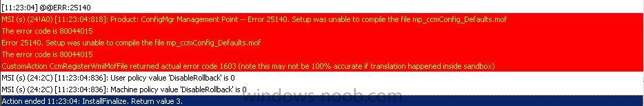

I have installed SCCM 2012 SP1 onto Windows Server 2012 with SQL running on a remote server. Both servers are running in an ESX enviroment. AD has been extended & all security permissions applied to both AD (System management Container) & SQL I can install the site without any issues except for the mangement point it will not install. I can add a DP. FP, application catalog roles and they are all working fine. No matter what i try i am unable to get the MP to install, the server has been rebuilt several times, install has been tried both with windows updates and without. No Virus software and Firewall disabled. Different download's of SCCM ISO's have been tried but i still can not get it installed. I have installed all the PreReq's that are required and there is no fail's therefore it will allow me to continue the install. When i watch the log file (mpMSI.log) i can see it running through the setup for MP & if iook in the SMS_CCM Folder i see it add the files for the MP before doing a rollback due to the failure on installation. The erro which i am getting is attached which relates to mp_ccmConfig_Defaults.mof was unable to compile. I have checked for 2007 client installed which some people suggest but this does not exist as we don't install SCCM client onto servers. I have disabled UAC, removed bits and reinstalled but i am still unable to resolve. Any help to resolve this will be very much welcome. Thanks in advance
Hi thanks for your reply, we don't install the SCCM 2007 client on Servers so there is not client. However i did try the post you suggested prior to posting but did not help me. This is really strange i am now at the point to try installing Server 2012 to see if that resolves the problem. Peter
Hi i wonder if somebody can save me from going crazy!!!!! I have installed SCCM 2012 SP1 onto Windows 8 R2 Standard SP1 with SQL running on a remote server running on ESX hardware v7 .AD has been extended for SCCM ( Done for 2007 install) All security permissions applied in both AD & SQL. I can install the site with no problems at all except for the MP, the DP role is installed fine. I can add extra roles for example FallBack status point, Application Catalog web service point etc. No matter what i try i am unable to get the management point to install. I have rebuilt the server from scratch, i have tried it with all windows updates & without. Different ISO's of SCCM all with the same problem. I have followed all documents which i can find on the internet and added a PreReq's which are require but it will still not install. When i watch the log file (mpMSI.log) i can see it running through the setup for the MP & if i look in the SMS_CCM folder i see it add the files for the MP before removing them due to the rollback of the install. The error which i am getting is attach which relates to mp_ccmConfig_Defaults.mof was unable to compile. Any help would be very welcome as i am going crazy with this as i am unable to find a solution. Thanks in advance to who ever can help me with this and i hope there is somebody because this is normally the place where i find my solutions for SCCM.
