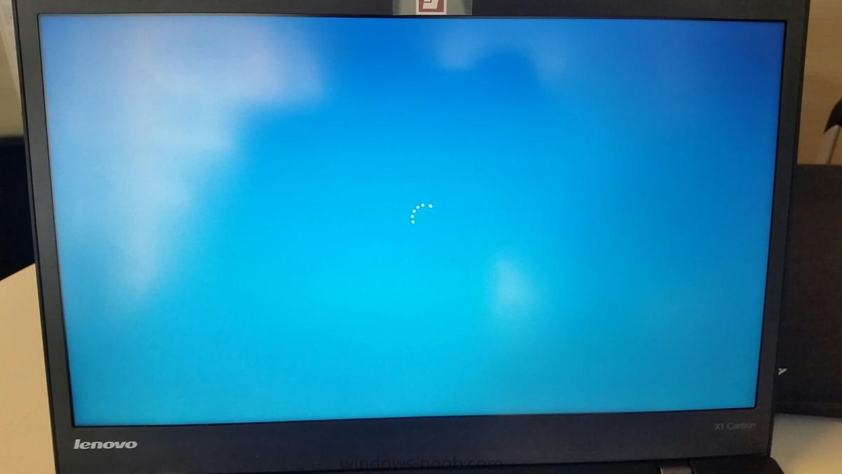

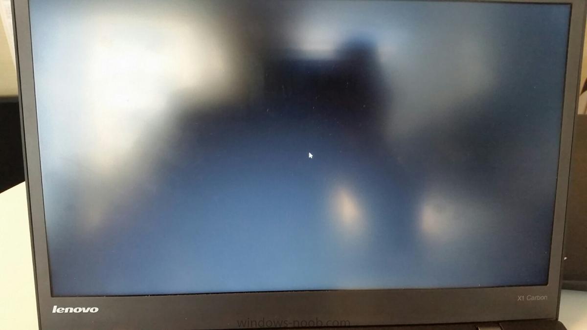

Hello everyone, Not sure if I'm posting this on the right forum so please let me know and I'll post at Windows 10 forum. I have been testing out the new Windows 10 In-place upgrade with specified drivers within the task sequence. I have been successful at upgrading my test machines from Windows 7 to 10. Recently, I decided to inject updates to the upgrade package to be able to apply updated Windows 10 to make the process much smoother. Now, after applying the task sequence and rebooting into the Operating System, I get a black screen with the cursor. After I do a force reboot, I am prompted with a blue background and the spinning white dots. Not sure if this has to do with the updates I injected or something else? If so, is there a way to remove injected updates from the Upgrade Package? Has anyone come across this yet?

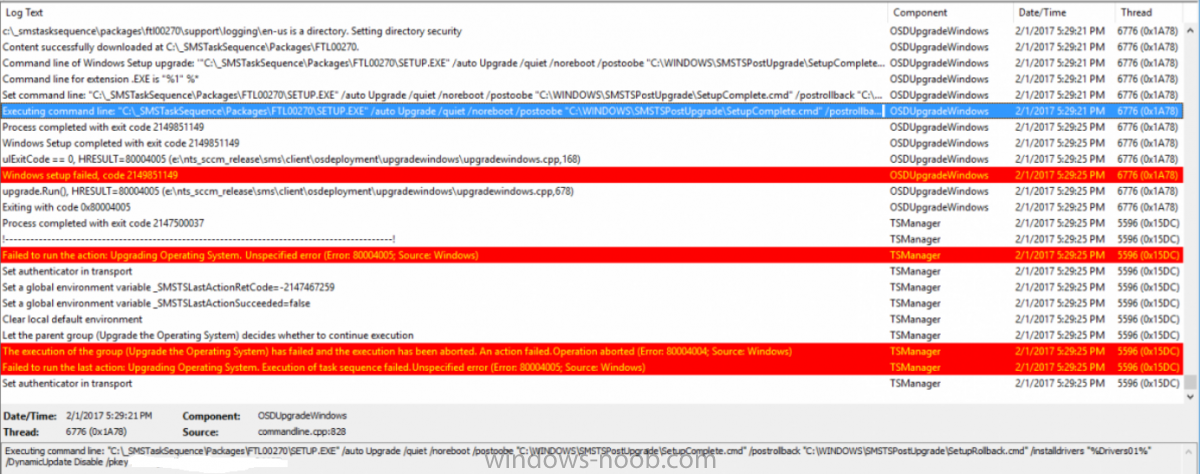

Hey anyweb, I just tried a few test and I believe I figured out what was my initial problem. I re-imaged a PC with Windows 7 and it had the old SCCM client, 5.00.8239.1000 installed. My site server is currently at 5.00.8458.1000. As soon as I upgraded the test PC to 5.00.8458.1007, the upgrade took place and the directory changed to reflect the 'c:\drivers' variable. Now I my smsts.log are showing the appropriate executing command line. Thanks again!

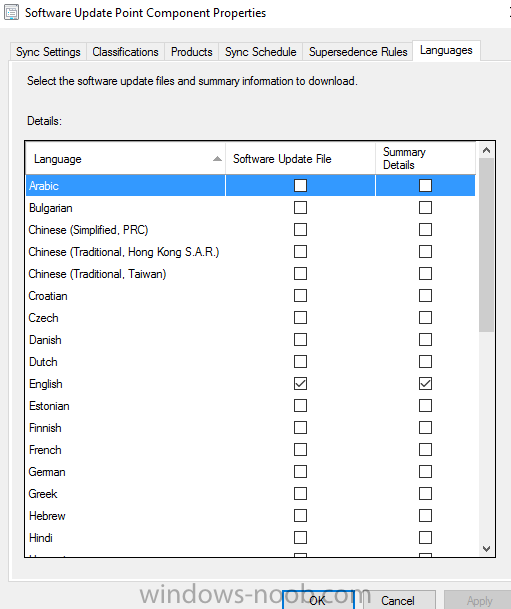

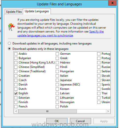

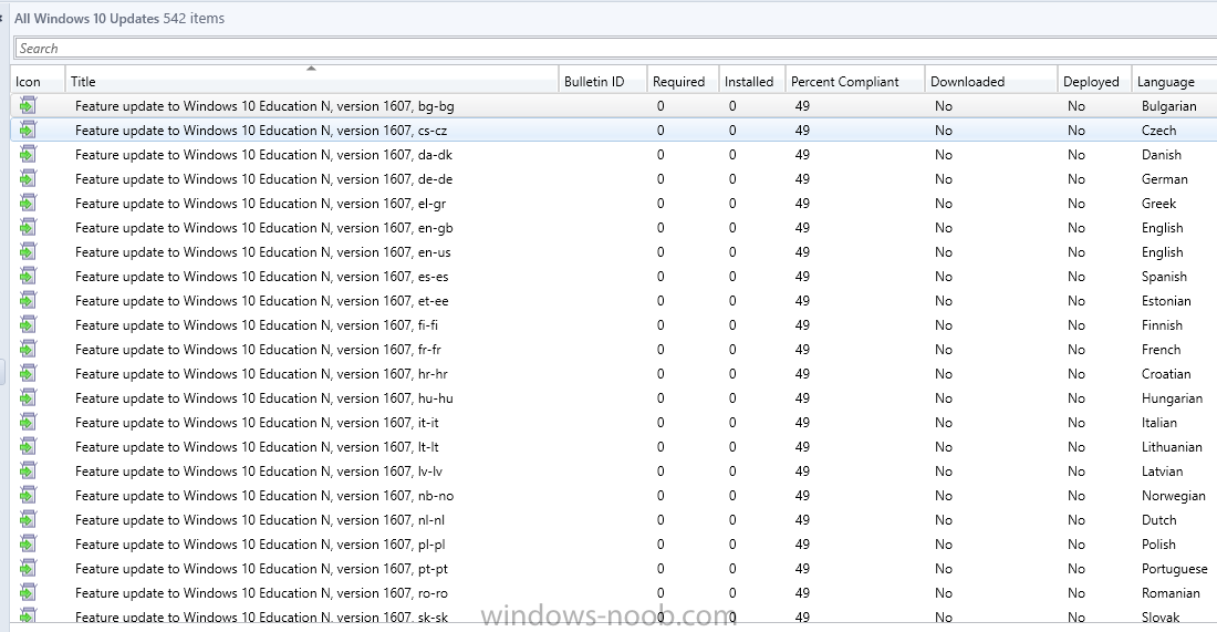

Hello everyone, I just recently started configuring my sccm for WIN 10 servicing. As I began to download updates and upgrades from Microsoft, the downloads began to pull down all languages for both the feature and Upgrade patches for Windows 10. I checked on the language configuration within the SUP and only English was ticked. I went to WSUS console and noticed that in here all languages were ticked. I made the changes to only have English ticked and resynced my Windows 10 Updates. Unfortunately, all languages are still being displayed. Is there any way I can delete/remove all non-required updates with different languages from SCCM? I have already ran the "Server Cleanup Wizard" at the WSUS console level and resynced but still no avail. Am I missing something here on how to remove unwanted updates from SCCM console? This can be inefficient when trying to create Servicing Plans to apply only particular updates i.e. Enterprise and English only updates.
I'm sending 2 smsts.log to you via message. The first log is for one laptop that was successful using the method that noahw86 provided and the second smsts.log shows a failed attempt to inject drivers that I just tried to do. Not sure why the log shows the "drivers01" for the driver location instead of the actually indicated directory within my TS. Can you see why the OSD process is not changing the directory as specified?
Hi anyweb, I know this is a few months old post but wanted to try and see if anyone here can help. I am having the exact same issue as noahw86 where the directory is not being created during the "Download Package Content" step. I specified the directory as indicated on this tutorial but the directory does not get created and the driver content looks like it gets downloaded within the default task sequence directory. So when the "Upgrading Operating System" step runs it fails since I'm indicating the variable %Drivers01%. I attached a screenshot of my smsts.log below to show you the executing step and how the variable is not being changed. Could this be a bug within 1602?

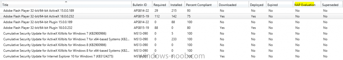

Hey anyweb, Not sure if you had the time to view my log above but I did bump into another forum who had the same issue. However, when I checked for the NAP evaluation for each of my software updates, they were already all set to 'No'. Should I place them a NAP evaluation schedule and re-run the 1606 prereq check?
