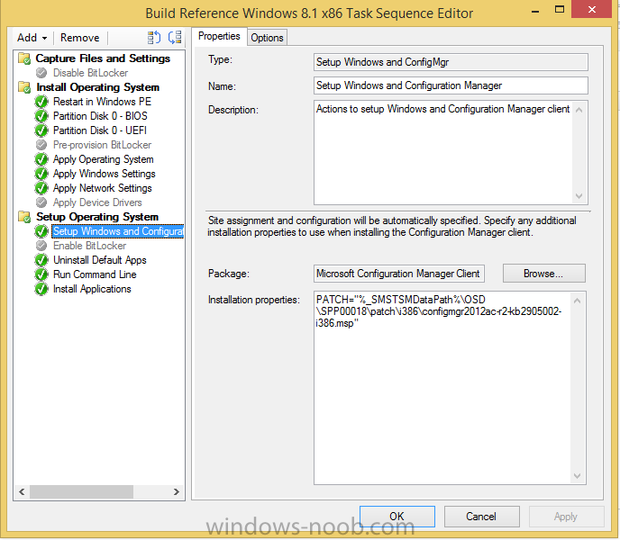

Have you made sure that you are installing the correct client hotfix? Make sure you are using the right type ie x86 or x64 in the PATCH command of the Setup and Configure Windows step. This will require changing the TS. See my TS for example. This is installing the x86 patch to a x86 deployment. -

Hi Rocket Man, I have sorted the issue. The client upgrade that came with the one of the hotfix's was not being installed during the OSD. The was the smallest of errors in the PATCH=.................. command that i was using. Now this has been sorted the task sequence components have been upgraded and the error has disappeared. Thanks for you help. -
