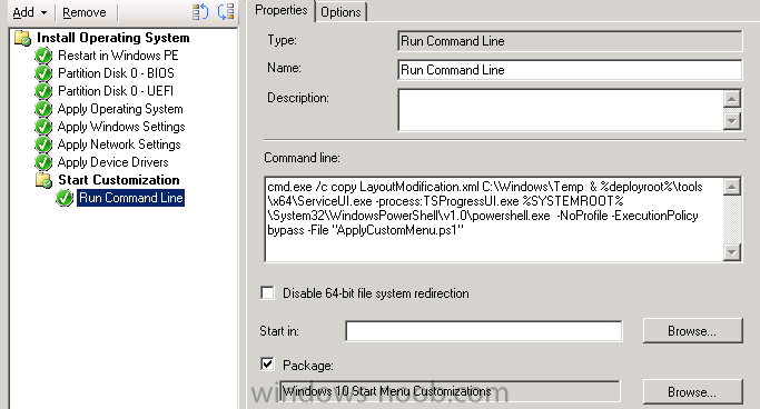

  2. Hi, I tried to work according to your article about "Start Customization" on Windows 10, This is my thin task sequence: I am not sure it is the correct place to put the group. the image failed with XXXXXXXX01 error.

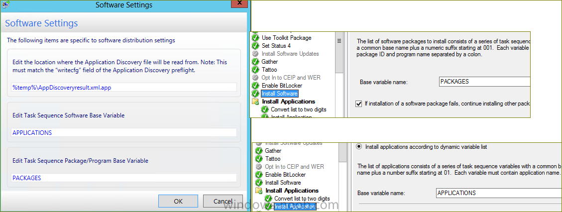

  4. Hi guys , I have TS (MDT) that i created in my SCCM , i added some app&pack to my ts using UDI , the problem is that when i try to deploy the image everything work well except app&pack installs , no one of them installed , i get Error : the error is ReleaseRequest failed with error code 0x80004005 Task Sequence Manager could not release active TS request. code 80004005 as i understand that the error 0x80004005 is generic error ? important to note those app&pack working well in software center +we have another image (without UDI) that we added some applications and packages as they will install in deployment process and they working well , The problem occurred only with image that mix with UDI,MDT These are my configurations :
  5. Hi all , We have strange situation with my MDT task , i have added several programs\packages using UDI to my task , everything working excellent , once MDT wizard open "Install Programs&Application" i selected all programs\application in list and then i click Next ( Continue with Task process) , after task finish i don't see my application as installed , no in software center no in Program and Features , it's very strange because i don't see any error , as i told everything passing in task

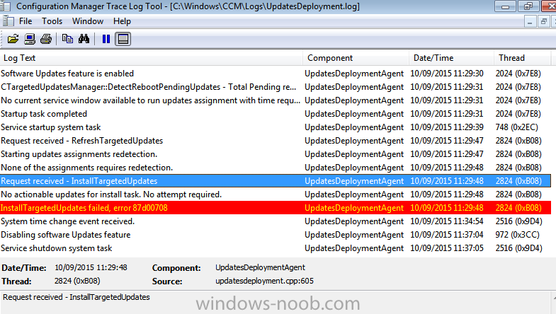

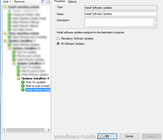

  21. Hi HotdogSCCM what is the problem with command ?indeed , you right i copied the command from blog. if the command is wrong maybe you have else command ? OR from your experience what is the best order .1 install 2 scan ? why kick off "Install Updates" ? i'm ready to try your suggestions , but first of all i need to know what is wrong , the order or the command , I exhausted my efforts amount Thank you ,
  22. Hi , Yes, i deployed it to Unknwon computers , and it's always failed in step 2 ( Scan ) : WMIC /namespace:\\root\ccm path sms_client CALL TriggerSchedule “{00000000-0000-0000-0000-000000000113}” /NOINTERACTIVE the error is "error 0x8004100e " i really don't understand why it's failed in scan process
  23. Hi all , i have SCCM 2012 in my organization , the SCCM working perfectly if it's updates, deploy images, package , etc.. i though to be more clever and upgrade my images deployment , and i want to deploy images with updates , i know that it's possible , so i started with process and add these configuration : Of course i deployed that task sequence to "Unknown Computer" This is the error that i got:
