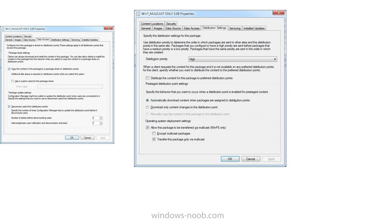

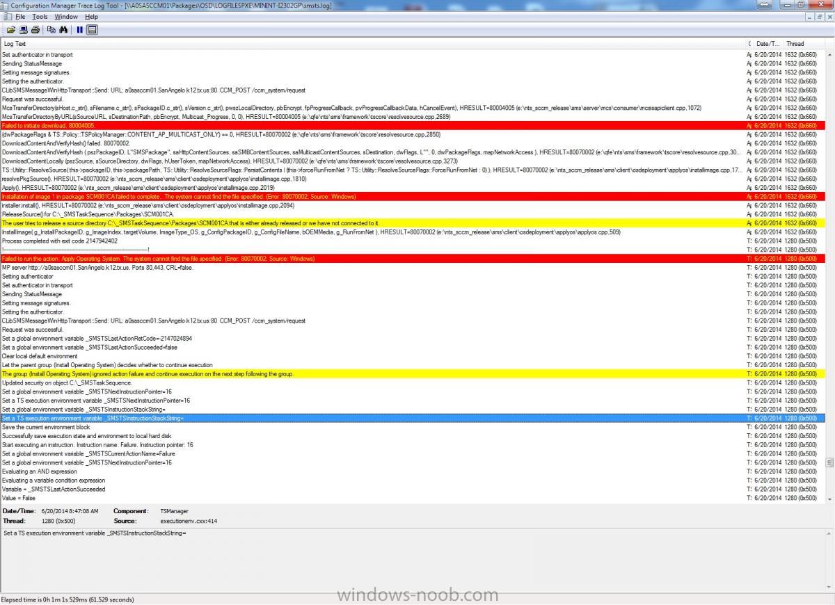

  2. Hello let me first start off with my environment. 2 servers one setup as Primary and the other as Site System Server(Just Distribution Point Role, Site System and Component Server) Primary Dell PowerEdge Server 710, Win 2008 r2, raid 6, 24gb, SQL on server and we upgraded from sp1 to r2 cu1. Second server is a dell laptop running with Sever 2012 r2( I know your going to ask why) I work at a school district and we use it as a portable Imaging server due to issues multicasting to campuses. . I can unicast without any issues its just multicast fails. I cannot even multicast on the same Vlan with SCCM R2, on Cisco switch we setup multicast and I know it works with Ghost on same Vlan just not across yet but we are working on that issue to. I have checked distribute package to package share and checked transfer via winpe all packages in task sequence and on the wim I also set only transfer via winpe. I have tried updating the DP from all packages and Operating System Images still same error Attached via Image and .log I would appreciate any insight on what I am doing wrong or any tips thank you Server Mcs.Exec.log Failed to retrieve database settings. The system cannot find the file specified. (Error: 80070002; Source: Windows) McsExec 6/18/2014 8:35:21 PM 2348 (0x092C) Error testing database connection: 0x80070002 McsExec 6/18/2014 8:35:21 PM 2348 (0x092C) Failed to read MCS settings. The system cannot find the file specified. (Error: 80070002; Source: Windows) McsExec 6/19/2014 6:40:21 AM 2208 (0x08A0) Checking MCS Certificate McsExec 6/19/2014 6:40:21 AM 2208 (0x08A0) MCSEncryptionCert Exists and is valid. Length 976. McsExec 6/19/2014 6:40:21 AM 2208 (0x08A0) ========== HealthCheck ffffffff-ffff-ffff-ffff-ffffffffffff McsExec 6/19/2014 6:40:21 AM 2208 (0x08A0) Failed to read MCS settings. The system cannot find the file specified. (Error: 80070002; Source: Windows) McsExec 6/19/2014 6:40:21 AM 2208 (0x08A0) Failed to retrieve database settings. The system cannot find the file specified. (Error: 80070002; Source: Windows) McsExec 6/19/2014 6:40:21 AM 2208 (0x08A0) Error testing database connection: 0x80070002 McsExec 6/19/2014 6:40:21 AM 2208 (0x08A0) Failed to read MCS settings. The system cannot find the file specified. (Error: 80070002; Source: Windows) McsExec 6/19/2014 3:49:04 PM 1764 (0x06E4) Checking MCS Certificate McsExec 6/19/2014 3:49:04 PM 1764 (0x06E4) MCSEncryptionCert Exists and is valid. Length 976. McsExec 6/19/2014 3:49:04 PM 1764 (0x06E4) ========== HealthCheck ffffffff-ffff-ffff-ffff-ffffffffffff McsExec 6/19/2014 3:49:04 PM 1764 (0x06E4) Failed to read MCS settings. The system cannot find the file specified. (Error: 80070002; Source: Windows) McsExec 6/19/2014 3:49:04 PM 1764 (0x06E4) Failed to retrieve database settings. The system cannot find the file specified. (Error: 80070002; Source: Windows) McsExec 6/19/2014 3:49:04 PM 1764 (0x06E4) Error testing database connection: 0x80070002 McsExec 6/19/2014 3:49:04 PM 1764 (0x06E4) Setting WDS IpAddressSource McsExec 6/19/2014 10:58:47 PM 1820 (0x071C) Running: WDSUTIL.exe /Set-TransportServer /ObtainIPv4From:Range /Start:239.0.0.1 /End:239.0.0.254 McsExec 6/19/2014 10:58:47 PM 1820 (0x071C) Waiting for completion of: WDSUTIL.exe /Set-TransportServer /ObtainIPv4From:Range /Start:239.0.0.1 /End:239.0.0.254 McsExec 6/19/2014 10:58:47 PM 1820 (0x071C) Run completed for: WDSUTIL.exe /Set-TransportServer /ObtainIPv4From:Range /Start:239.0.0.1 /End:239.0.0.254 McsExec 6/19/2014 10:58:48 PM 1820 (0x071C) Running: WDSUTIL.exe /Set-TransportServer /StartPort:64001 /EndPort:65000 McsExec 6/19/2014 10:58:48 PM 1820 (0x071C) Waiting for completion of: WDSUTIL.exe /Set-TransportServer /StartPort:64001 /EndPort:65000 McsExec 6/19/2014 10:58:48 PM 1820 (0x071C) Run completed for: WDSUTIL.exe /Set-TransportServer /StartPort:64001 /EndPort:65000 McsExec 6/19/2014 10:58:49 PM 1820 (0x071C) Succesfully Configured WDS McsExec 6/19/2014 10:58:49 PM 1820 (0x071C) Checking MCS Certificate McsExec 6/19/2014 10:58:49 PM 1820 (0x071C) MCSEncryptionCert Created. Length 976. McsExec 6/19/2014 10:58:49 PM 1820 (0x071C) ========== HealthCheck ffffffff-ffff-ffff-ffff-ffffffffffff McsExec 6/19/2014 10:58:49 PM 1820 (0x071C) Setting WDS IpAddressSource McsExec 6/20/2014 6:23:47 AM 4464 (0x1170) Running: WDSUTIL.exe /Set-TransportServer /ObtainIPv4From:Range /Start:239.0.0.1 /End:239.0.0.254 McsExec 6/20/2014 6:23:47 AM 4464 (0x1170) Waiting for completion of: WDSUTIL.exe /Set-TransportServer /ObtainIPv4From:Range /Start:239.0.0.1 /End:239.0.0.254 McsExec 6/20/2014 6:23:47 AM 4464 (0x1170) Setting WDS IpAddressSource McsExec 6/20/2014 10:00:32 AM 1732 (0x06C4) Running: WDSUTIL.exe /Set-TransportServer /ObtainIPv4From:Range /Start:239.0.0.1 /End:239.0.0.254 McsExec 6/20/2014 10:00:32 AM 1732 (0x06C4) Waiting for completion of: WDSUTIL.exe /Set-TransportServer /ObtainIPv4From:Range /Start:239.0.0.1 /End:239.0.0.254 McsExec 6/20/2014 10:00:32 AM 1732 (0x06C4) Client reply has no message header marker ApplyOperatingSystem 6/20/2014 8:47:07 AM 1632 (0x0660) DoRequest (sReply, true), HRESULT=80004005 (e:\qfe\nts\sms\framework\osdmessaging\libsmsmessaging.cpp,10184) ApplyOperatingSystem 6/20/2014 8:47:07 AM 1632 (0x0660) oMcsRequest.GetMCSKey(mcsKeyInfoResponse), HRESULT=80004005 (e:\nts_sccm_release\sms\server\mcs\consumer\mcsisapiclient.cpp,429) ApplyOperatingSystem 6/20/2014 8:47:07 AM 1632 (0x0660) Failed to get MCS key (Code 0x80004005) ApplyOperatingSystem 6/20/2014 8:47:07 AM 1632 (0x0660) ClientRequestToMCS::DoRequest failed. error = (0x80004005). ApplyOperatingSystem 6/20/2014 8:47:07 AM 1632 (0x0660) Request to MCS 'a0sasccm03.SanAngelo.k12.tx.us' failed with error (Code 0x80004005). ApplyOperatingSystem 6/20/2014 8:47:07 AM 1632 (0x0660) Multicast OpenSessionRequest failed (0x80004005). ApplyOperatingSystem 6/20/2014 8:47:07 AM 1632 (0x0660) Sending status message: SMS_OSDeployment_PackageDownloadMulticastStatusFail ApplyOperatingSystem 6/20/2014 8:47:07 AM 1632 (0x0660) Setting authenticator. ApplyOperatingSystem 6/20/2014 8:47:07 AM 1632 (0x0660) Set authenticator in transport ApplyOperatingSystem 6/20/2014 8:47:07 AM 1632 (0x0660) Sending StatusMessage ApplyOperatingSystem 6/20/2014 8:47:07 AM 1632 (0x0660) Setting message signatures. ApplyOperatingSystem 6/20/2014 8:47:07 AM 1632 (0x0660) Setting the authenticator. ApplyOperatingSystem 6/20/2014 8:47:07 AM 1632 (0x0660) CLibSMSMessageWinHttpTransport::Send: URL: a0sasccm01.SanAngelo.k12.tx.us:80 CCM_POST /ccm_system/request ApplyOperatingSystem 6/20/2014 8:47:07 AM 1632 (0x0660) Request was successful. ApplyOperatingSystem 6/20/2014 8:47:07 AM 1632 (0x0660) McsTransferDirectory(sHost.c_str(), sFilename.c_str(), sPackageID.c_str(), sVersion.c_str(), pwszLocalDirectory, pbEncrypt, fpProgressCallback, pvProgressCallbackData, hCancelEvent), HRESULT=80004005 (e:\nts_sccm_release\sms\server\mcs\consumer\mcsisapiclient.cpp,1072) ApplyOperatingSystem 6/20/2014 8:47:07 AM 1632 (0x0660) McsTransferDirectoryByURL(sSourceURL, sDestinationPath, pbEncrypt, Multicast_Progress, 0, 0), HRESULT=80004005 (e:\qfe\nts\sms\framework\tscore\resolvesource.cpp,2689) ApplyOperatingSystem 6/20/2014 8:47:07 AM 1632 (0x0660) Failed to initiate download. 80004005. ApplyOperatingSystem 6/20/2014 8:47:07 AM 1632 (0x0660) (dwPackageFlags & TS::Policy::TSPolicyManager::CONTENT_AP_MULTICAST_ONLY) == 0, HRESULT=80070002 (e:\qfe\nts\sms\framework\tscore\resolvesource.cpp,2850) ApplyOperatingSystem 6/20/2014 8:47:08 AM 1632 (0x0660) DownloadContentAndVerifyHash() failed. 80070002. ApplyOperatingSystem 6/20/2014 8:47:08 AM 1632 (0x0660) DownloadContentAndVerifyHash ( pszPackageID, L"SMSPackage", saHttpContentSources, saSMBContentSources, saMulticastContentSources, sDestination, dwFlags, L"", 0, dwPackageFlags, mapNetworkAccess ), HRESULT=80070002 (e:\qfe\nts\sms\framework\tscore\resolvesource.cpp,3052) ApplyOperatingSystem 6/20/2014 8:47:08 AM 1632 (0x0660) DownloadContentLocally (pszSource, sSourceDirectory, dwFlags, hUserToken, mapNetworkAccess), HRESULT=80070002 (e:\qfe\nts\sms\framework\tscore\resolvesource.cpp,3273) ApplyOperatingSystem 6/20/2014 8:47:08 AM 1632 (0x0660) TS::Utility::ResolveSource( this->packageID, this->packagePath, TS::Utility::ResolveSourceFlags::PersistContents | (this->forceRunFromNet ? TS::Utility::ResolveSourceFlags::ForceRunFromNet : 0) ), HRESULT=80070002 (e:\nts_sccm_release\sms\client\osdeployment\applyos\installimage.cpp,1767) ApplyOperatingSystem 6/20/2014 8:47:08 AM 1632 (0x0660) resolvePkgSource(), HRESULT=80070002 (e:\nts_sccm_release\sms\client\osdeployment\applyos\installimage.cpp,1810) ApplyOperatingSystem 6/20/2014 8:47:08 AM 1632 (0x0660) Apply(), HRESULT=80070002 (e:\nts_sccm_release\sms\client\osdeployment\applyos\installimage.cpp,2019) ApplyOperatingSystem 6/20/2014 8:47:08 AM 1632 (0x0660) Installation of image 1 in package SCM001CA failed to complete.. The system cannot find the file specified. (Error: 80070002; Source: Windows) ApplyOperatingSystem 6/20/2014 8:47:08 AM 1632 (0x0660) smsts.log
