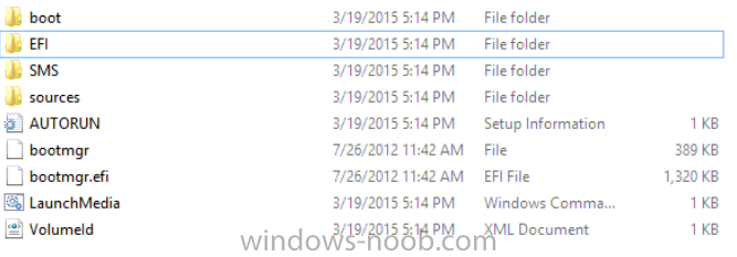

  4. Hi, I have created a .iso file using the create task sequence media option for Standalone media. Now I need to burn it to a DVD. Please let me know the steps. 1. I have tried to burn it by right click and burn disk image. This does not make it bootable. Should I use any 3rd party apps and which file should be referred to make it bootable. Below are the files from the .iso file.
