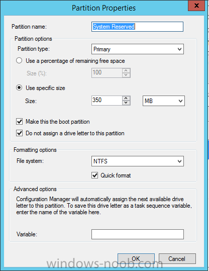

Partition TS Step:
The Cause:
The _SMSTaskSequence folder gets placed on D: then after the step below occurs it starts looking for the TS files to be on E: which doesn't exist. (Full log attached)

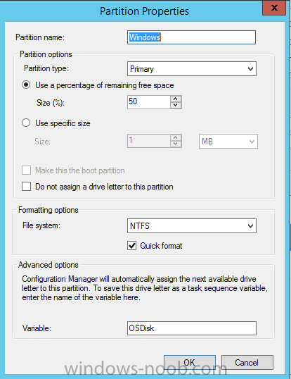

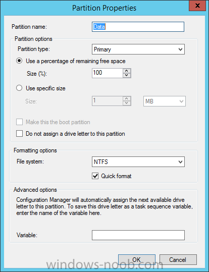

so 50%+100%=150% of your disk, could be your problem ;-)
Hmm. I guess i misunderstood how that works.
My understanding.
I have a 100GB Hard Drive
Partition 1 - 50% of remaining space (100GB) = 50GB
Partition 2 - 100% of the remaining space left on the drive (50GB) = 50GB
Totaling 100GB of space used.
No?
I would like to agree with Niall. Also, I always prefer to give my operating system drive a fixed size and leave the rest for any data partition.
So the thought is that sccm is trying to create e: on the extra 50% of the 150%? The partitions create properly 50% and 50%.

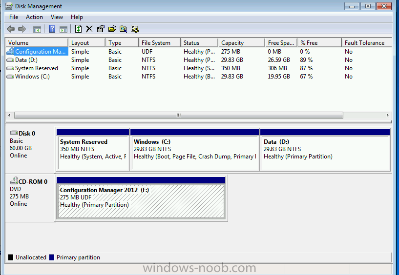

ok so that's your partitions after the step ? well if so it's obviously working, or is it ?

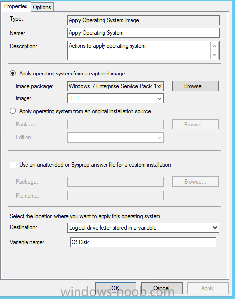

what does your apply operating system image step look like
No ideas? Anyone? Could it be that I only have one "image" in my wim file? If you notice in my Apply OS step my image package is 1-1. That is my only option. I know typically there are two options. 1-1 and 2-2. One being (I believe) some sort of system image and the other the actual OS.
So I did this same partitioning on Windows 8.1 TS i have where the wim shows as two image files and it worked perfectly. Although I did also change the location to install the os to "next available partition" instead of using a variable. So going to change OS location first since that will be much easier than recapturing my wim. I will post back results in case anyone cares.
