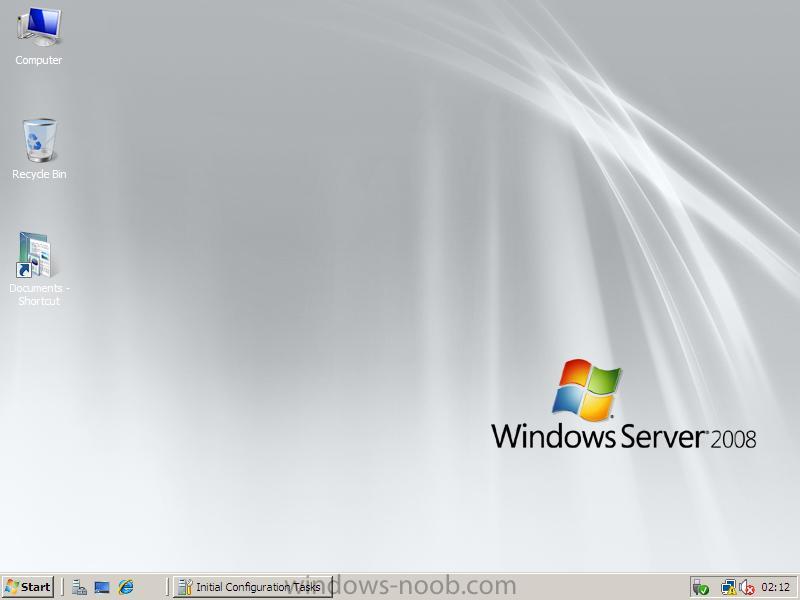

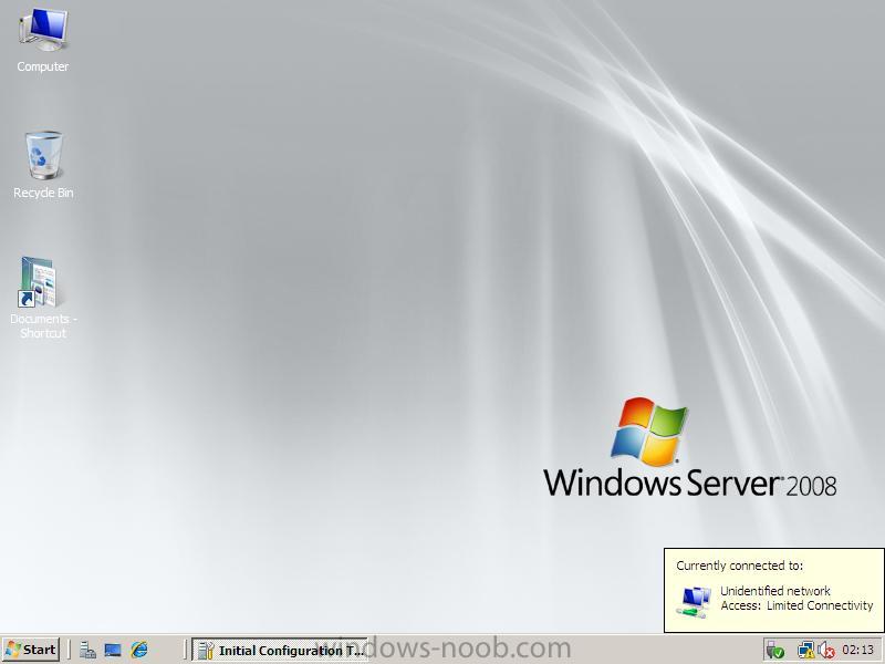

Hi the netvork icon on the taskbar near the clock has yellow triangle with exclamation mark if i go with mouse pointer cross this icon popup widow open with limited access word.the dns is perfectly configured also the static adresses and the name of server all correct i no doing this first time.i know i missing some point it reminds me when i use to do network on linux some wizards was crap you have to use the command line as root then the settings works. when i disconnect on the fresh installation without configuring anything like dns dhcp or active directory the lan cable from the switch then the network icon crossed like normaly when the cable is unplugged but soon as i plug the cable back the yellow triangle with exclamation mark show up. the duplex mode is set on auto i did try also half an full duplex on 10 and 100 mbit but still the same. i have connected the server to internet via rooter (standard dsl) then the icon disappeared and is connected, internet works.so the card works. even after configuring the dns and the static ip adress is the same fault.i have tried on hp also on ibm but same. can be some issue with dhcp or dns i am not sure but again how is possible the server not responding to or showing up like domain controller if all settings r correct.or my administrator account profile is like limited user profile.any idea? thanks -

hi some mor news about this persist crazy failure.i did fresh installation of server 2008 standard start the server plug the ethernet cable to the switch and i got yellow exclamation mark on the network card icon with limited acces.this not change.i set the dns correctly name of server all the lookup forvarders etc etc same as how is all the time.i was even thinking maybe this software is not compatible with my server.after i set manually from dns to dhcp till active directory the problem still persist.if i do the sme on server 2003 all works from the first moment.i just thinking if enyone had crossed this probleme. -

hi sorry to disturb you again i just went trough the instalation again but after when i do the active directory services when i restart the server i see in roles 2 yellow exlamation mark one is near active directory domain services and another near the dns. and also down on the panel ner the clock where is the network icon i have the yellow exclamation mark if i go on this icon with mouse i see currently connected to something.local and the acces:Limited Connectivity so i am a bit pissed off there is must be some hardware issue or wrong driver.otherwise i canot see there probleme.this is not my first server but i know server2008 is based on vista its not my favorite. i was ok on 2003 and 2000 but this now going on my nervous few day. could you please give me some advice if you have experienced the same fault? -
