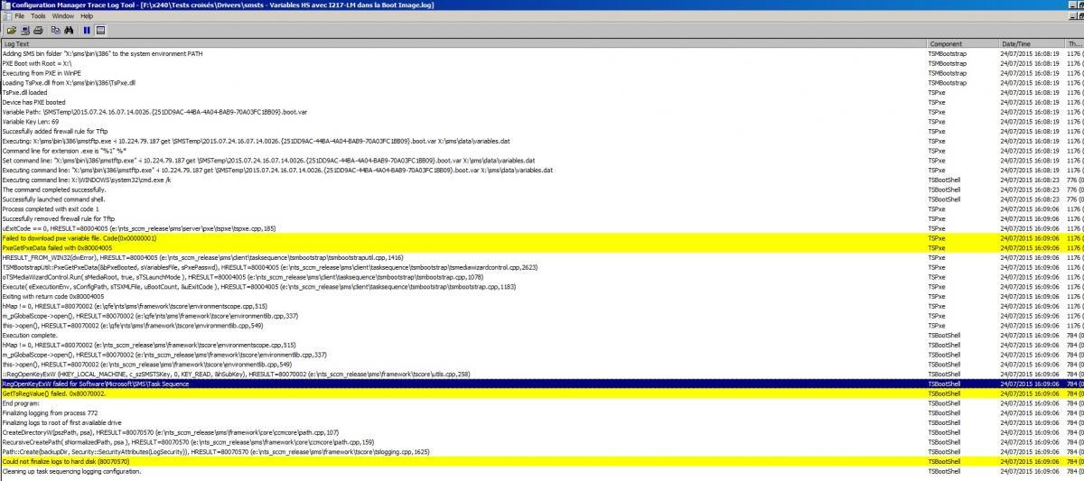

  9. Hello, The Task Sequence that was deploying W7 with SCCM 2012 SP1 has stopped to deploying the Lenovo X240 laptop. The Laptop must load WinPE on Workgroup & PXE When I get on F8 to get an ipconfig, nothing but the message "configuration IP" is dysplayed, then WinPE reboot. I don't know if the laptop has joined the workgroup The smsts.log show 2 mains errors : Failed to download pxe variable file. Code(0x00000001) TSPxe 24/07/2015 16:09:06 1176 (0x0498) PxeGetPxeData failed with 0x80004005 TSPxe 24/07/2015 16:09:06 1176 (0x0498) RegOpenKeyExW failed for Software\Microsoft\SMS\Task Sequence TSBootShell 24/07/2015 16:09:06 784 (0x0310) GetTsRegValue() failed. 0x80070002. TSBootShell 24/07/2015 16:09:06 784 (0x0310) The driver are the following : http://support.lenovo.com/us/en/downloads/ds038819 Please, Help me.
