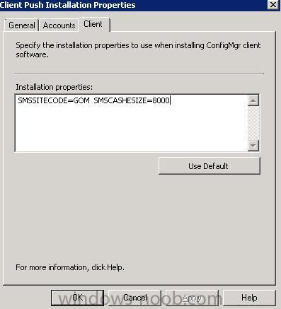

hi anyweb, I set my SIDECODE=AUTOt, it happend nothing. Update: I have installed my sccm 2007 on a separate server Windows 2008 . My Domiancontroller is installed on a separate server Windows 2008 too. I can see this both groups SMS_SiteSystemToSiteServerConnection_sitecode and SMS_SiteToSiteConnection_sitecode on my sccm Side Server. But on my AD Domain I could not see these groups SMS_SiteSystemToSiteServerConnection_sitecode and SMS_SiteToSiteConnection_sitecode and I create these groups there. that means I have both groups as well on my Side Server as on my AD Domain. My Question is, do I need on AD Domain these groups SMS_SiteSystemToSiteServerConnection_sitecode and SMS_SiteToSiteConnection_sitecode???? or not? Is it the possible, that my problem with sccm client Configmgr does not function because of these groups on AD Domain??? cheers -

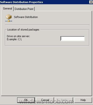

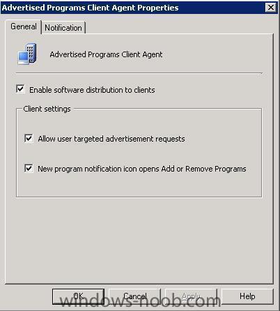

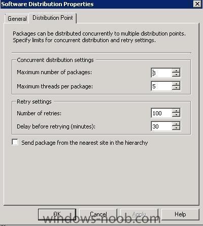

here my SMSSIDECODE I think so,software distribution component installed correctly! here my advertisment tell me please, why does it work with my domain controller? do I have to set for every clients a boundary? thank for helping -

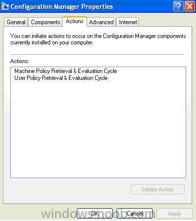

I have on client many log files, which file do you mean? CAS.log in the CAS-log "Software Distribution Site Settings for the client are missing from WMI" -

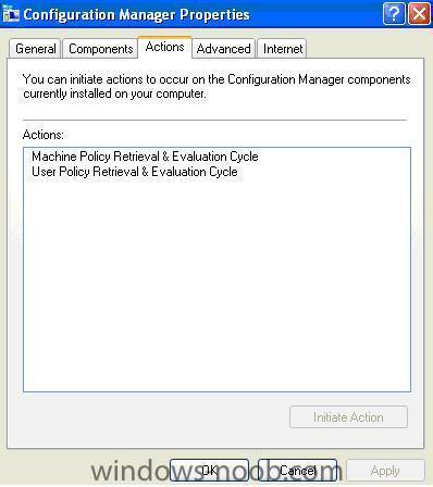

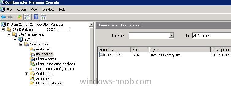

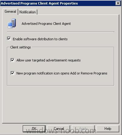

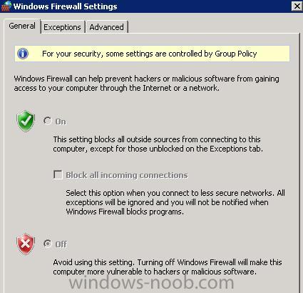

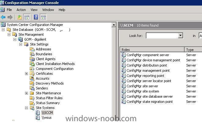

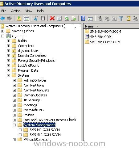

yes I follow all prerequisites before installing sccm 2007. The Ad schema is extened. I have a container named System Management. And Firewall is per policy disabled. MP role is there. the boundaries see please my scrennshot above. my boundary my MP my AD ( system Management) my Firewall why can I see on the domaincontroller all features of Configmgr? But on the Clients I see only this?
