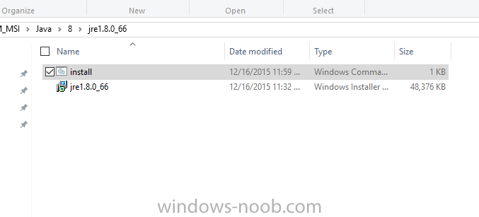

  6. I just have a cmd script that runs the following code...it's never failed on me before? msiexec.exe /i "%~dp0jre1.8.0_66.msi" JU=0 JAVAUPDATE=0 AUTOUPDATECHECK=0 RebootYesNo=No WEB_JAVA=1 /qn
