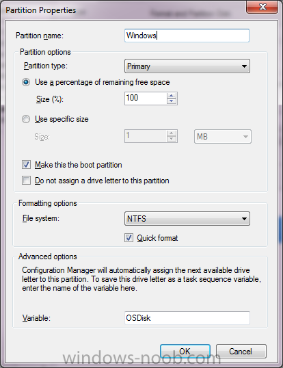

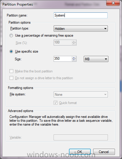

Hello I'm using BIOS. Yes UEFI is disabled. I tried creating new task sequence step for format (which you can view from attachment). This didn't help. Computer still made C-drive, so it's pretty weird..- 7 replies
