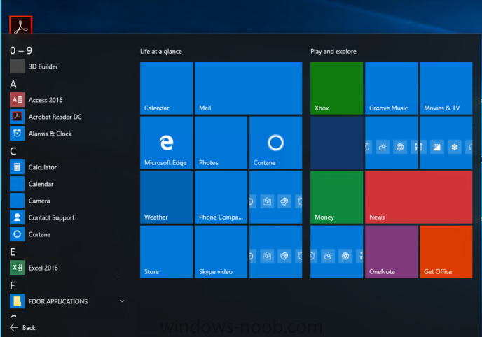

What's the best way of doing this? I've created so many new XML files with the export cmdlet and attempted to implement them into my OSD TS in SCCM and it still doesn't work at all. I'm not getting my predefined layout in my profile when i log onto my VM with the freshly imaged computer. -

i just learned why i was getting the error i was getting about invalid file type, i was trying to run it on win 10 version 10240 i was trying to apply it to a WIM though that i mounted. it still causes weird stuff like shown above in the screenshots during the OSD, on 1511 -

I used to have the scripts that are listed all over the web within my Win10 deployment and it worked wonderfully. But now, it's not. And i'm not sure why. What's happening is, the metro apps are being removed, but their shortcuts i guess are staying behind. And as for the start menu, the file is being applied to the default profile and i can open the layoutmodification.xml file in the current user location and the default user location and the contents of it match the desirable xml file on the SCCM server that's being deployed, but the start menu still looks original to a fresh Win10 install, but it also has messed up metro app shortcuts that are left behind from the apps that were removed. Why is this? I've included a screen shot of what it looks like now.

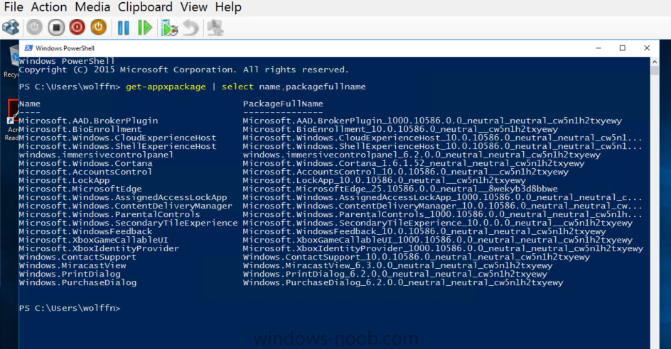

Good afternoon, I am trying to deploy Windows 10 Enterprise x64 to a test laptop of mine at work and I'm coming across some issues after doing the following steps to deploy: create a new HyperV VM using win10 ent x64 media create a generic local account without a password remove the local Administrator pw (and enable it) customize what I want on the generic local account I've created remove undesired metro apps utilizing Remove-AppxPackage and Remove-AppxProvisionedPackage powershell cmdlets mount sccm 2012 capture media ISO begin capture media process from within the generic account it finishes the WIM file media creation and i replace the WIM file within my TS for image deployment I start the deployment on the test device and it installs and everything looks good, except: 1) start menu does not work at all 2) i get an error citing something similar to "c:\windows\system32\config\systemprofile desktop refers to a location that is unavailable" 3) i notice the "Default" account has nothing in its folder 4) the search function doesn't work 5) some things inside of windows explorer\file browsing does not work I noticed my applications did install that i have set up in the TS, the drivers all installed properly, but something is wrong with the profiles copying over properly or even at all. should i not be modifying or removing the metro apps? such as 3d builder, windows maps, ms store, skype, get office, sway, get started, etc. I'm removing all except for Contact Support, Windows Feedback, Calculator, Voice Recorder thanks in advance
