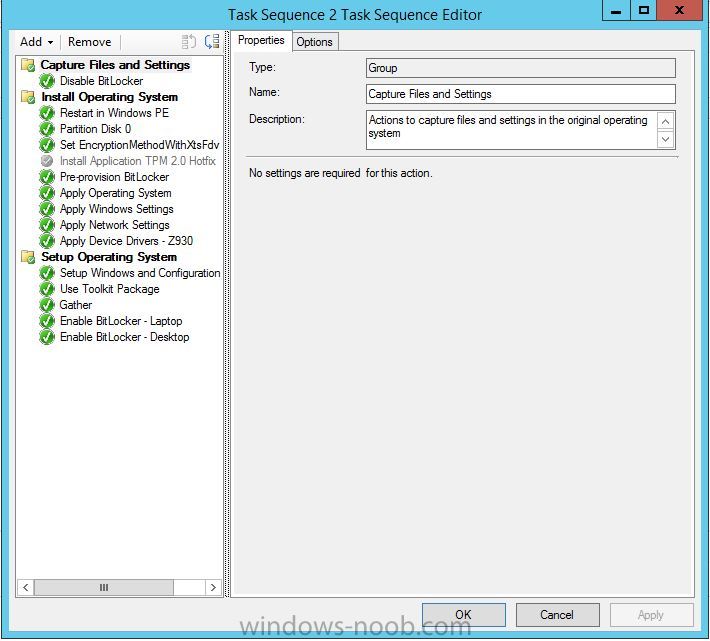

Hello I currently have a working task sequence for non UEFI machines it currently provisions a bitlocker space and depending if its a laptop or desktop enables either bitlocker with pin or just bitlocker No matter what I do I cannot seem to get a UEFI version to work in the task sequence. I have copied various settings from a MDT task sequence that cater for the UEFI sequence. I seem to be able to format based on the items I have copied but cannot get the bitlocker part to work. No errors as it seems to go through the sequence ok so I am guessing its not picking up correct variables to do the task Does someone have a working task sequence for UEFI machines I can look at I am currently trying to install a windows 7 x64 OS Any help Cheers

More investigation it looks like the TPM driver is appearing under the system devices not under security devices, does any one know why this would be happening? -

Hello having major trouble with enabling bitlocker in my task sequence, been trying to follow various sites to help fix I use the Islaptop, IsDesktop to apply specific types of TPM The strange thing is when the enable laptop tpm, fails and goes onto the desktop the bitlocker process seems to have started when I try to right click resume the process the following error appears WIZARD initialization has failed One or more Bitlocker key protectors are required. You cannot delete the last key on the this drive am I missing something I have tried various different ways of getting this to work and I know AD is setup correctly and these laptops are supported as we did all bitlocker tasks successfully with MDT I have done a copy of the SMSTS file below HELP PLEASE <![LOG[start executing an instruction. Instruction name: Enable BitLocker - Laptop. Instruction pointer: 19]LOG]!><time="10:34:06.112-60" date="08-24-2016" component="TSManager" context="" type="1" thread="1104" file="engine.cxx:140"> <![LOG[set a global environment variable _SMSTSCurrentActionName=Enable BitLocker - Laptop]LOG]!><time="10:34:06.112-60" date="08-24-2016" component="TSManager" context="" type="0" thread="1104" file="executionenv.cxx:662"> <![LOG[set a global environment variable _SMSTSNextInstructionPointer=19]LOG]!><time="10:34:06.112-60" date="08-24-2016" component="TSManager" context="" type="0" thread="1104" file="executionenv.cxx:662"> <![LOG[set a local default variable OSDBitLockerPIN]LOG]!><time="10:34:06.112-60" date="08-24-2016" component="TSManager" context="" type="0" thread="1104" file="executionenv.cxx:694"> <![LOG[set a global environment variable _SMSTSLogPath=C:\WINDOWS\CCM\Logs\SMSTSLog]LOG]!><time="10:34:06.112-60" date="08-24-2016" component="TSManager" context="" type="0" thread="1104" file="executionenv.cxx:662"> <![LOG[Evaluating an AND expression]LOG]!><time="10:34:06.112-60" date="08-24-2016" component="TSManager" context="" type="1" thread="1104" file="tsexpreval.cpp:600"> <![LOG[Evaluating a variable condition expression]LOG]!><time="10:34:06.112-60" date="08-24-2016" component="TSManager" context="" type="1" thread="1104" file="tsexpreval.cpp:783"> <![LOG[Variable = IsLaptop]LOG]!><time="10:34:06.112-60" date="08-24-2016" component="TSManager" context="" type="1" thread="1104" file="tsexpreval.cpp:801"> <![LOG[Value = True]LOG]!><time="10:34:06.112-60" date="08-24-2016" component="TSManager" context="" type="1" thread="1104" file="tsexpreval.cpp:802"> <![LOG[Operator = equals]LOG]!><time="10:34:06.112-60" date="08-24-2016" component="TSManager" context="" type="1" thread="1104" file="tsexpreval.cpp:803"> <![LOG[Expand a string: equals]LOG]!><time="10:34:06.112-60" date="08-24-2016" component="TSManager" context="" type="0" thread="1104" file="utility.cpp:790"> <![LOG[Expand a string: IsLaptop]LOG]!><time="10:34:06.112-60" date="08-24-2016" component="TSManager" context="" type="0" thread="1104" file="utility.cpp:790"> <![LOG[Expand a string: True]LOG]!><time="10:34:06.112-60" date="08-24-2016" component="TSManager" context="" type="0" thread="1104" file="utility.cpp:790"> <![LOG[The variable condition expression is evaluated to be TRUE]LOG]!><time="10:34:06.112-60" date="08-24-2016" component="TSManager" context="" type="1" thread="1104" file="tsexpreval.cpp:907"> <![LOG[The AND expression is evaluated to be TRUE]LOG]!><time="10:34:06.112-60" date="08-24-2016" component="TSManager" context="" type="1" thread="1104" file="tsexpreval.cpp:633"> <![LOG[The condition for the action (Enable BitLocker - Laptop) is evaluated to be true]LOG]!><time="10:34:06.112-60" date="08-24-2016" component="TSManager" context="" type="1" thread="1104" file="instruction.cxx:715"> <![LOG[Expand a string: OSDBitLocker.exe /enable /wait:False /mode:TPMAndPIN /pwd:AD]LOG]!><time="10:34:06.112-60" date="08-24-2016" component="TSManager" context="" type="0" thread="1104" file="executionenv.cxx:776"> <![LOG[Expand a string: ]LOG]!><time="10:34:06.112-60" date="08-24-2016" component="TSManager" context="" type="0" thread="1104" file="executionenv.cxx:776"> <![LOG[Command line for extension .exe is "%1" %*]LOG]!><time="10:34:06.112-60" date="08-24-2016" component="TSManager" context="" type="0" thread="1104" file="commandline.cpp:229"> <![LOG[set command line: OSDBitLocker.exe /enable /wait:False /mode:TPMAndPIN /pwd:AD]LOG]!><time="10:34:06.112-60" date="08-24-2016" component="TSManager" context="" type="0" thread="1104" file="commandline.cpp:732"> <![LOG[start executing the command line: OSDBitLocker.exe /enable /wait:False /mode:TPMAndPIN /pwd:AD]LOG]!><time="10:34:06.112-60" date="08-24-2016" component="TSManager" context="" type="1" thread="1104" file="instruction.cxx:731"> <![LOG[!--------------------------------------------------------------------------------------------!]LOG]!><time="10:34:06.112-60" date="08-24-2016" component="TSManager" context="" type="1" thread="1104" file="instruction.cxx:760"> <![LOG[Expand a string: FullOS]LOG]!><time="10:34:06.112-60" date="08-24-2016" component="TSManager" context="" type="0" thread="1104" file="executionenv.cxx:776"> <![LOG[Executing command line: OSDBitLocker.exe /enable /wait:False /mode:TPMAndPIN /pwd:AD]LOG]!><time="10:34:06.112-60" date="08-24-2016" component="TSManager" context="" type="1" thread="1104" file="commandline.cpp:828"> <![LOG[==============================[ OSDBitLocker.exe ]==============================]LOG]!><time="10:34:06.128-60" date="08-24-2016" component="OSDBitLocker" context="" type="1" thread="3200" file="main.cpp:349"> <![LOG[Command line: "OSDBitLocker.exe" /enable /wait:False /mode:TPMAndPIN /pwd:AD]LOG]!><time="10:34:06.128-60" date="08-24-2016" component="OSDBitLocker" context="" type="1" thread="3200" file="main.cpp:350"> <![LOG[initialized COM]LOG]!><time="10:34:06.128-60" date="08-24-2016" component="OSDBitLocker" context="" type="0" thread="3200" file="main.cpp:361"> <![LOG[Command line for extension .exe is "%1" %*]LOG]!><time="10:34:06.128-60" date="08-24-2016" component="OSDBitLocker" context="" type="0" thread="3200" file="commandline.cpp:229"> <![LOG[set command line: "OSDBitLocker.exe" /enable /wait:False /mode:TPMAndPIN /pwd:AD]LOG]!><time="10:34:06.128-60" date="08-24-2016" component="OSDBitLocker" context="" type="0" thread="3200" file="commandline.cpp:732"> <![LOG[Target volume not specified, using current OS volume]LOG]!><time="10:34:06.128-60" date="08-24-2016" component="OSDBitLocker" context="" type="0" thread="3200" file="main.cpp:247"> <![LOG[Current OS volume is 'C:']LOG]!><time="10:34:06.128-60" date="08-24-2016" component="OSDBitLocker" context="" type="0" thread="3200" file="main.cpp:249"> <![LOG[succeeded loading resource DLL 'C:\WINDOWS\CCM\1033\TSRES.DLL']LOG]!><time="10:34:06.144-60" date="08-24-2016" component="OSDBitLocker" context="" type="1" thread="3200" file="util.cpp:970"> <![LOG[Protection is OFF]LOG]!><time="10:34:06.144-60" date="08-24-2016" component="OSDBitLocker" context="" type="0" thread="3200" file="bitlocker.cpp:1506"> <![LOG[Volume is fully encrypted]LOG]!><time="10:34:06.144-60" date="08-24-2016" component="OSDBitLocker" context="" type="0" thread="3200" file="bitlocker.cpp:1537"> <![LOG[Creating key protectors]LOG]!><time="10:34:06.144-60" date="08-24-2016" component="OSDBitLocker" context="" type="0" thread="3200" file="bitlocker.cpp:1548"> <![LOG[FALSE, HRESULT=80004005 (e:\nts_sccm_release\sms\framework\tscore\tpm.cpp,130)]LOG]!><time="10:34:06.175-60" date="08-24-2016" component="OSDBitLocker" context="" type="0" thread="3200" file="tpm.cpp:130"> <![LOG[unable to find instance of 'Win32_Tpm'. Ensure that this device has a Trusted Platform Module which is enabled in the BIOS.]LOG]!><time="10:34:06.175-60" date="08-24-2016" component="OSDBitLocker" context="" type="3" thread="3200" file="tpm.cpp:130"> <![LOG[pTpm->Initialize(), HRESULT=80004005 (e:\nts_sccm_release\sms\client\osdeployment\bitlocker\bitlocker.cpp,450)]LOG]!><time="10:34:06.175-60" date="08-24-2016" component="OSDBitLocker" context="" type="0" thread="3200" file="bitlocker.cpp:450"> <![LOG[No suitable TPM found (0x80004005)]LOG]!><time="10:34:06.175-60" date="08-24-2016" component="OSDBitLocker" context="" type="3" thread="3200" file="bitlocker.cpp:450"> <![LOG[initializeTpm(), HRESULT=80004005 (e:\nts_sccm_release\sms\client\osdeployment\bitlocker\bitlocker.cpp,1313)]LOG]!><time="10:34:06.175-60" date="08-24-2016" component="OSDBitLocker" context="" type="0" thread="3200" file="bitlocker.cpp:1313"> <![LOG[ConfigureKeyProtection( keyMode, pwdMode, pszStartupKeyVolume ), HRESULT=80004005 (e:\nts_sccm_release\sms\client\osdeployment\bitlocker\bitlocker.cpp,1552)]LOG]!><time="10:34:06.175-60" date="08-24-2016" component="OSDBitLocker" context="" type="0" thread="3200" file="bitlocker.cpp:1552"> <![LOG[pBitLocker->Enable( argInfo.keyMode, argInfo.passwordMode, argInfo.sStartupKeyVolume, argInfo.bWait ), HRESULT=80004005 (e:\nts_sccm_release\sms\client\osdeployment\bitlocker\main.cpp,382)]LOG]!><time="10:34:06.175-60" date="08-24-2016" component="OSDBitLocker" context="" type="0" thread="3200" file="main.cpp:382"> <![LOG[Process completed with exit code 2147500037]LOG]!><time="10:34:06.190-60" date="08-24-2016" component="TSManager" context="" type="1" thread="1104" file="commandline.cpp:1124"> <![LOG[!--------------------------------------------------------------------------------------------!]LOG]!><time="10:34:06.190-60" date="08-24-2016" component="TSManager" context="" type="1" thread="1104" file="instruction.cxx:814"> <![LOG[Failed to run the action: Enable BitLocker - Laptop. Unspecified error (Error: 80004005; Source: Windows)]LOG]!><time="10:34:06.190-60" date="08-24-2016" component="TSManager" context="" type="3" thread="1104" file="instruction.cxx:921">
