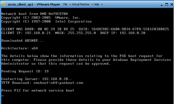

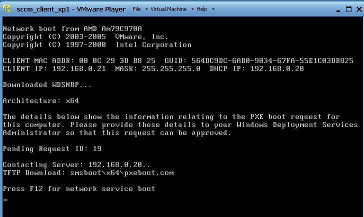

2. I am using vmware player and have only checked "host only" in the network settings but I have not added any network drivers. The only NIC drivers I added were of the host machine hoping the VMware would pick that up, I am fairly new to vm. 3. Screenshots attached 4. I am not sure why it says it needs to be authorized I went into Windows deployment service and made sure that was not enabled.
If a screenshot of the pxe boot will help just ask and I can post it.

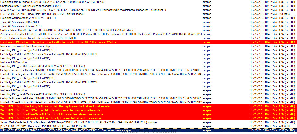

Virtual Windows 2008 R2 SCCM 2007 SP2 Eval AD DHCP DNS IIS WDS Virtual Windows 7 Good morning, and happy Friday! Today is my birthday, my car overheated, and my SCCM is not working so any help would be appreciated I followed the amazingly awesome SCCM installation, and configuration guide on here. I have avertised a task sequence to all systems which has a client I imported. My virtual client recognizes the DHCP server, receives a IP, and says its connecting to the server 192.168.0.20 but then it takes a while and fails out, my task sequence will not run it will not even get into windows pe. This is the smspxe log any ideas? <![LOG[sMSPXE Provider starting ]LOG]!><time="09:25:07.894+240" date="10-29-2010" component="smspxe" context="" type="0" thread="1648" file="main.cpp:226"> <![LOG[================= PXE Provider loaded. =====================]LOG]!><time="09:25:07.913+240" date="10-29-2010" component="smspxe" context="" type="1" thread="1648" file="smspxe.cpp:142"> <![LOG[init Policy Provider settings]LOG]!><time="09:25:07.913+240" date="10-29-2010" component="smspxe" context="" type="0" thread="1648" file="provsettings.cpp:232"> <![LOG[Machine is running Windows Longhorn. (NTVersion=0X601, ServicePack=0)]LOG]!><time="09:25:07.927+240" date="10-29-2010" component="smspxe" context="" type="1" thread="1648" file="provsettings.cpp:1740"> <![LOG[Reloading PXE Provider Settings. cached=0]LOG]!><time="09:25:07.927+240" date="10-29-2010" component="smspxe" context="" type="0" thread="1648" file="provsettings.cpp:297"> <![LOG[Loaded PXE settings from reg key HKLM\Software\Microsoft\SMS\Identification: SMS Site Settings: Server: WIN-BBVL4E98LAT SiteCode: DST Parent SiteCode: <empty> ]LOG]!><time="09:25:07.927+240" date="10-29-2010" component="smspxe" context="" type="0" thread="1648" file="provsettings.cpp:389"> <![LOG[Cannot read the registry value of MACIgnoreListFile (80070002)]LOG]!><time="09:25:07.927+240" date="10-29-2010" component="smspxe" context="" type="1" thread="1648" file="provsettings.cpp:456"> <![LOG[Loaded PXE settings from reg key HKLM\Software\Microsoft\SMS\PXE: PXE Settings: IsActive: Yes SupportUnknownMachines: No MACIgnoreListFile: <empty> ResponseDelay: 2 CacheExpire: 3600 HTTP Port: 80 HTTPS Port: 443 IISSSLState: 0x0 BindPolicy: Exclude <empty> TRK: <non empty> SiteSignCert: <empty> Root CA Certs: <empty> PXE GUID: 0766cc47-ee5a-46d9-b5b2-473978c9696b PXEPassword: <non empty> ]LOG]!><time="09:25:07.927+240" date="10-29-2010" component="smspxe" context="" type="0" thread="1648" file="provsettings.cpp:571"> <![LOG[Loaded TFTP settings from reg key HKLM\System\CurrentControlSet\Services\WDSSERVER\Providers\WDSTFTP: TFTP Settings: Directory: C:\RemoteInstall ]LOG]!><time="09:25:07.927+240" date="10-29-2010" component="smspxe" context="" type="0" thread="1648" file="provsettings.cpp:754"> <![LOG[MAC Ignore List Filename in registry is empty]LOG]!><time="09:25:07.927+240" date="10-29-2010" component="smspxe" context="" type="1" thread="1648" file="provsettings.cpp:766"> <![LOG[Loaded Database settings from reg key HKLM\Software\Microsoft\SMS\PXE: Database Settings: Server: WIN-BBVL4E98LAT Database: SMS_DST User: <empty> Password: <empty> Use Integrated Security: No Impersonation Required: No ]LOG]!><time="09:25:07.927+240" date="10-29-2010" component="smspxe" context="" type="0" thread="1648" file="provsettings.cpp:964"> <![LOG[PXE Provider Settings Changed]LOG]!><time="09:25:07.927+240" date="10-29-2010" component="smspxe" context="" type="0" thread="1648" file="provsettings.cpp:317"> <![LOG[Querying Database for Cert with GUID: 0766cc47-ee5a-46d9-b5b2-473978c9696b]LOG]!><time="09:25:07.928+240" date="10-29-2010" component="smspxe" context="" type="0" thread="1648" file="provsettings.cpp:628"> <![LOG[inside GetPxeCert]LOG]!><time="09:25:07.928+240" date="10-29-2010" component="SmsPXE" context="" type="1" thread="1648" file="database.cpp:776"> <![LOG[Executing PxeGetCert(0766cc47-ee5a-46d9-b5b2-473978c9696b)]LOG]!><time="09:25:07.969+240" date="10-29-2010" component="SmsPXE" context="" type="0" thread="1648" file="database.cpp:806"> <![LOG[CDatabaseProxy :: GetPxeCert succeeded: 0766cc47-ee5a-46d9-b5b2-473978c9696b \\WIN-BBVL4E98LAT <non empty>]LOG]!><time="09:25:07.970+240" date="10-29-2010" component="SmsPXE" context="" type="0" thread="1648" file="database.cpp:878"> <![LOG[Loaded PXE settings from DB: PXE Cert: <non empty> ]LOG]!><time="09:25:07.970+240" date="10-29-2010" component="smspxe" context="" type="0" thread="1648" file="provsettings.cpp:632"> <![LOG[site Code: , Parent Site Code: ]LOG]!><time="09:25:07.970+240" date="10-29-2010" component="smspxe" context="" type="0" thread="1648" file="provsettings.cpp:637"> <![LOG[Executing PXE_GetSiteTypeAndDefaultMP(DST)]LOG]!><time="09:25:07.970+240" date="10-29-2010" component="smspxe" context="" type="0" thread="1648" file="database.cpp:934"> <![LOG[GetSiteTypeAndDefaultMP: SiteType=2 DefaultMP=WIN-BBVL4E98LAT.DSTT.LOCAL ]LOG]!><time="09:25:07.971+240" date="10-29-2010" component="smspxe" context="" type="0" thread="1648" file="database.cpp:981"> <![LOG[site Type: 2]LOG]!><time="09:25:07.971+240" date="10-29-2010" component="smspxe" context="" type="0" thread="1648" file="provsettings.cpp:643"> <![LOG[GetUnknownMachineResource (DST,x86):]LOG]!><time="09:25:07.971+240" date="10-29-2010" component="smspxe" context="" type="0" thread="1648" file="database.cpp:1126"> <![LOG[unknown machine resource not found]LOG]!><time="09:25:07.972+240" date="10-29-2010" component="smspxe" context="" type="0" thread="1648" file="database.cpp:1152"> <![LOG[GetUnknownMachineResource (DST,x64):]LOG]!><time="09:25:07.972+240" date="10-29-2010" component="smspxe" context="" type="0" thread="1648" file="database.cpp:1126"> <![LOG[unknown machine resource not found]LOG]!><time="09:25:07.972+240" date="10-29-2010" component="smspxe" context="" type="0" thread="1648" file="database.cpp:1152"> <![LOG[Loaded PXE settings from DB: Unknown machine GUIDs: (x86) , (x64) ]LOG]!><time="09:25:07.972+240" date="10-29-2010" component="smspxe" context="" type="0" thread="1648" file="provsettings.cpp:648"> <![LOG[initializing PXEPerfObject.]LOG]!><time="09:25:07.994+240" date="10-29-2010" component="smspxe" context="" type="1" thread="1648" file="smspxe.cpp:404"> <![LOG[Executing LookupDevice(, 00:00:00:00:00:00)]LOG]!><time="09:25:08.017+240" date="10-29-2010" component="smspxe" context="" type="0" thread="1648" file="database.cpp:394"> <![LOG[CDatabaseProxy :: LookupDevice succeeded: 0 0 0 0]LOG]!><time="09:25:08.018+240" date="10-29-2010" component="smspxe" context="" type="0" thread="1648" file="database.cpp:444"> <![LOG[Failed to read PXE settings. The system cannot find the file specified. (Error: 80070002; Source: Windows)]LOG]!><time="09:25:08.018+240" date="10-29-2010" component="smspxe" context="" type="3" thread="1648" file="bootimagecache.cpp:119"> <![LOG[Failed to read PXE settings. The system cannot find the file specified. (Error: 80070002; Source: Windows)]LOG]!><time="09:25:08.018+240" date="10-29-2010" component="smspxe" context="" type="3" thread="1648" file="bootimagecache.cpp:119"> <![LOG[Found new image SMSPKG\DST00001]LOG]!><time="09:25:08.050+240" date="10-29-2010" component="smspxe" context="" type="1" thread="1648" file="bootimagemgr.cpp:915"> <![LOG[Opening image file C:\RemoteInstall\SMSImages\SMSPKG\DST00001\boot.DST00001.wim]LOG]!><time="09:25:08.052+240" date="10-29-2010" component="smspxe" context="" type="1" thread="1648" file="wimfile.cpp:276"> <![LOG[Failed to read PXE settings. The system cannot find the file specified. (Error: 80070002; Source: Windows)]LOG]!><time="09:25:08.059+240" date="10-29-2010" component="smspxe" context="" type="3" thread="1648" file="bootimagecache.cpp:119"> <![LOG[Found Image file: C:\RemoteInstall\SMSImages\SMSPKG\DST00001\boot.DST00001.wim PackageID: SMSPKG\DST00001 ProductName: Microsoft® Windows® Operating System Architecture: 0 Description: Microsoft Windows PE (x86) Version: Creator: SystemDir: WINDOWS ]LOG]!><time="09:25:08.059+240" date="10-29-2010" component="smspxe" context="" type="1" thread="1648" file="bootimagemgr.cpp:715"> <![LOG[Closing image file C:\RemoteInstall\SMSImages\SMSPKG\DST00001\boot.DST00001.wim]LOG]!><time="09:25:08.059+240" date="10-29-2010" component="smspxe" context="" type="1" thread="1648" file="wimfile.cpp:312"> <![LOG[Mutex was not owned. Now have ownership.]LOG]!><time="09:25:08.060+240" date="10-29-2010" component="smspxe" context="" type="0" thread="1648" file="TSBoot.h:696"> <![LOG[Opening image file C:\RemoteInstall\SMSImages\SMSPKG\DST00001\boot.DST00001.wim]LOG]!><time="09:25:10.422+240" date="10-29-2010" component="smspxe" context="" type="1" thread="1648" file="wimfile.cpp:276"> <![LOG[Applying image 1 to volume C:\Windows\TEMP\PXEBootFiles]LOG]!><time="09:25:10.425+240" date="10-29-2010" component="smspxe" context="" type="1" thread="1648" file="wimfile.cpp:466"> <![LOG[Closing image file C:\RemoteInstall\SMSImages\SMSPKG\DST00001\boot.DST00001.wim]LOG]!><time="09:25:10.640+240" date="10-29-2010" component="smspxe" context="" type="1" thread="1648" file="wimfile.cpp:312"> <![LOG[Found new image SMSPKG\DST00002]LOG]!><time="09:25:10.643+240" date="10-29-2010" component="smspxe" context="" type="1" thread="1648" file="bootimagemgr.cpp:915"> <![LOG[Opening image file C:\RemoteInstall\SMSImages\SMSPKG\DST00002\boot.DST00002.wim]LOG]!><time="09:25:10.644+240" date="10-29-2010" component="smspxe" context="" type="1" thread="1648" file="wimfile.cpp:276"> <![LOG[Failed to read PXE settings. The system cannot find the file specified. (Error: 80070002; Source: Windows)]LOG]!><time="09:25:10.647+240" date="10-29-2010" component="smspxe" context="" type="3" thread="1648" file="bootimagecache.cpp:119"> <![LOG[Found Image file: C:\RemoteInstall\SMSImages\SMSPKG\DST00002\boot.DST00002.wim PackageID: SMSPKG\DST00002 ProductName: Microsoft® Windows® Operating System Architecture: 9 Description: Microsoft Windows PE (x64) Version: Creator: SystemDir: WINDOWS ]LOG]!><time="09:25:10.647+240" date="10-29-2010" component="smspxe" context="" type="1" thread="1648" file="bootimagemgr.cpp:715"> <![LOG[Closing image file C:\RemoteInstall\SMSImages\SMSPKG\DST00002\boot.DST00002.wim]LOG]!><time="09:25:10.647+240" date="10-29-2010" component="smspxe" context="" type="1" thread="1648" file="wimfile.cpp:312"> <![LOG[Mutex was not owned. Now have ownership.]LOG]!><time="09:25:10.649+240" date="10-29-2010" component="smspxe" context="" type="0" thread="1648" file="TSBoot.h:696"> <![LOG[Opening image file C:\RemoteInstall\SMSImages\SMSPKG\DST00002\boot.DST00002.wim]LOG]!><time="09:25:11.807+240" date="10-29-2010" component="smspxe" context="" type="1" thread="1648" file="wimfile.cpp:276"> <![LOG[Applying image 1 to volume C:\Windows\TEMP\PXEBootFiles]LOG]!><time="09:25:11.810+240" date="10-29-2010" component="smspxe" context="" type="1" thread="1648" file="wimfile.cpp:466"> <![LOG[Closing image file C:\RemoteInstall\SMSImages\SMSPKG\DST00002\boot.DST00002.wim]LOG]!><time="09:25:11.992+240" date="10-29-2010" component="smspxe" context="" type="1" thread="1648" file="wimfile.cpp:312"> <![LOG[PXE Provider finished loading.]LOG]!><time="09:25:12.020+240" date="10-29-2010" component="smspxe" context="" type="1" thread="1648" file="smspxe.cpp:188"> <![LOG[[192.168.000.020:4011] Recv From:[192.168.000.020:9000] Len:274 101c8b0]LOG]!><time="09:27:19.638+240" date="10-29-2010" component="smspxe" context="" type="0" thread="248" file="smspxe.cpp:663"> <![LOG[Executing LookupDevice(46746E94-D140-497A-8C46-5463A8F006FD, FF:FF:FF:FF:FF:FF:FF:FF:FF:FF:FF:FF:FF:FF:FF:FF)]LOG]!><time="09:27:19.651+240" date="10-29-2010" component="smspxe" context="" type="0" thread="4792" file="database.cpp:394"> <![LOG[CDatabaseProxy :: LookupDevice succeeded: 0 0 0 0]LOG]!><time="09:27:19.652+240" date="10-29-2010" component="smspxe" context="" type="0" thread="4792" file="database.cpp:444"> <![LOG[MAC=FF:FF:FF:FF:FF:FF:FF:FF:FF:FF:FF:FF:FF:FF:FF:FF SMBIOS GUID=46746E94-D140-497A-8C46-5463A8F006FD > Device not found in the database.]LOG]!><time="09:27:19.652+240" date="10-29-2010" component="smspxe" context="" type="0" thread="4792" file="pxehandler.cpp:349">
