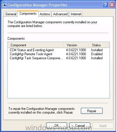

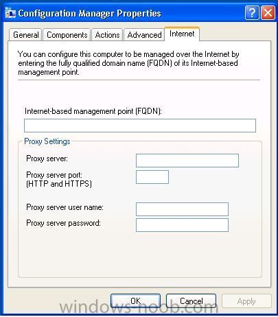

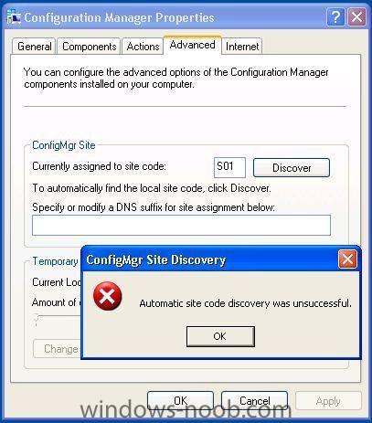

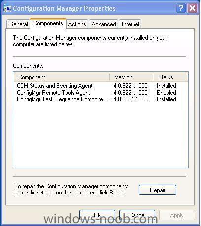

Thank you for your response anyweb, When I attempt to click on discover in the advanced tab, the message I receive is "Automatic site code discovery was unsuccessful". I am attaching a screen shot of the 5 tabs on my client side so you can see exactly my concerns. I tried to initiate the actions which were available but it gives me the follwoing error: "The action could not be initiated." Thank you for your help, John -

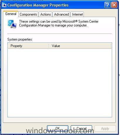

It didn't fully install, in the configuration manager properties window, the general tab is empty, and the components and actions tabs are barely populated. I can't initiate any actions locally, and the the configuration manager console doesn't show the client to be installed, in the column called "client" it has a "no" instead of a "yes". thanks for your help -

Good afternoon, I have been attempting to remove the SCCM 2007 client from windows XP service pack 3 computers for quite some time. I tried to use the CCMsetup.exe /uninstall, the msi removal of the client the SMS 2003 cmd tool, but I can't seem to succeed in removing it from that PC. The reason I am attempting to remove it, is because it didn't fully load, in the configuration manager properties window, the general tab is empty, and the components and actions tabs are barely populate. I tried to do a right click install client from the configuration manager console but it didn't work either. I would most definitely appreciate your help, Thank you
