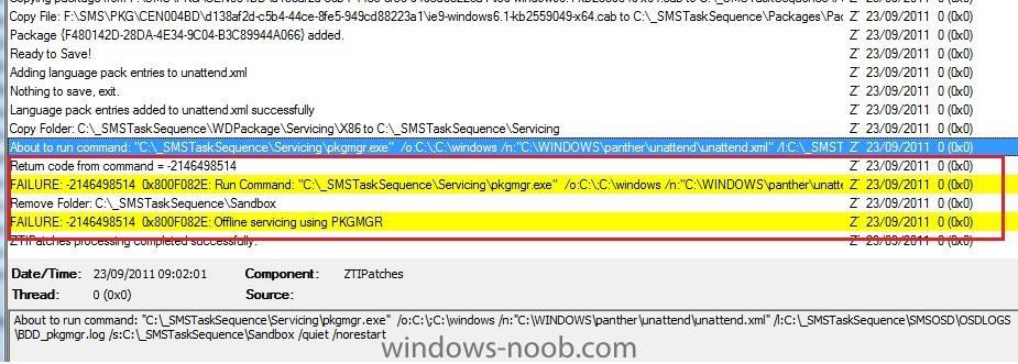

Hi All, I have a working USB media deployment but need to add the install updates offline task as this is for a remote office. I have added the Task in the Post Install section after my Driver installs but before the Setup Windows and ConfigMgr e.g. Use Toolkit Package > Install Upates Offline > Setup Windows and ConfigMgr. as per previous posts by AnyWeb. I also tried it before the Driver installs but recieve the same error attached, I have no EXE's in the patch package they are all CAB files, any ideas? Thanks, Barry

Check the log, you are not even getting that far, it is failing at Setup Windows and Config Manager: Set command line: "C:\_SMSTaskSequence\Packages\DOM00038\SOURCES\SETUP.EXE" "/unattend:C:\_SMSTaskSequence\unattend.xml" /noreboot That is erroring out with error 31. I would check the pakcage DOM00038 in the first instance. Barry
