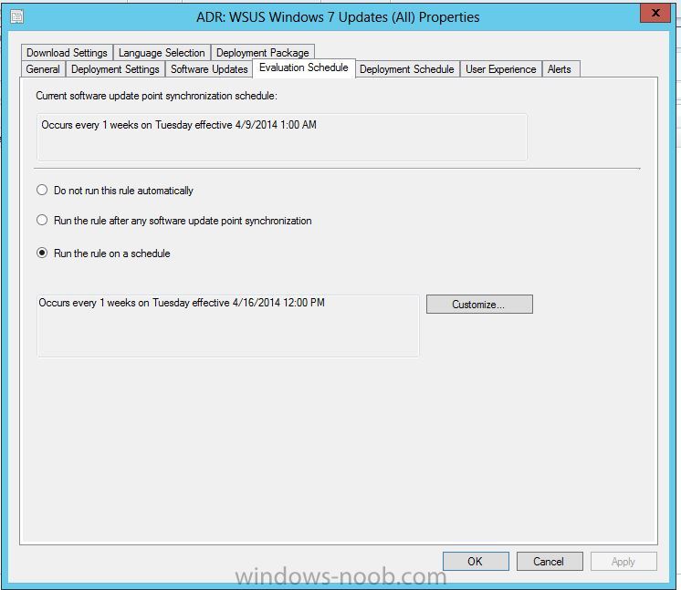

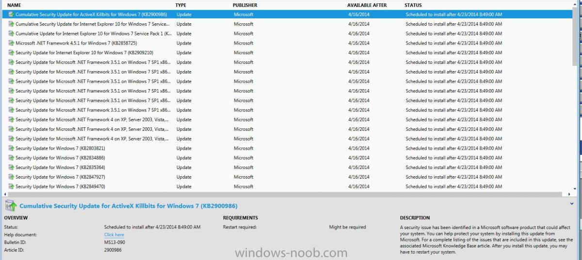

Could someone here tell me why my software updates are showing up on my users as "Scheduled to install after..." when I indicated in my Automatic Deployment Rule to run it Every 1 week on Tuesdays at 12:00PM? Below are some screenshots of my ADR Evaluation Schedule as well as what my users have on their side.

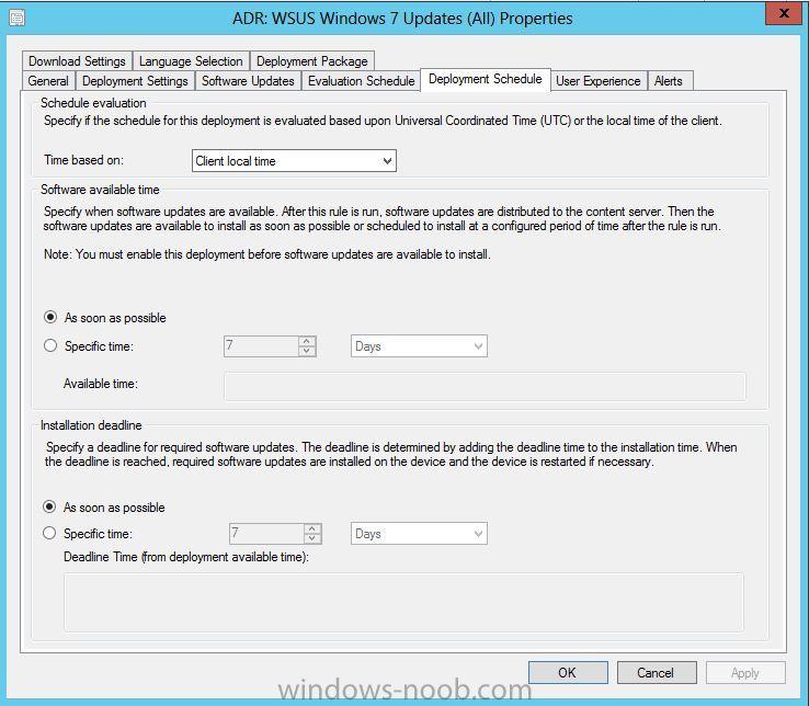

Check the "deployment schedule" tab for the Deadline Setting.

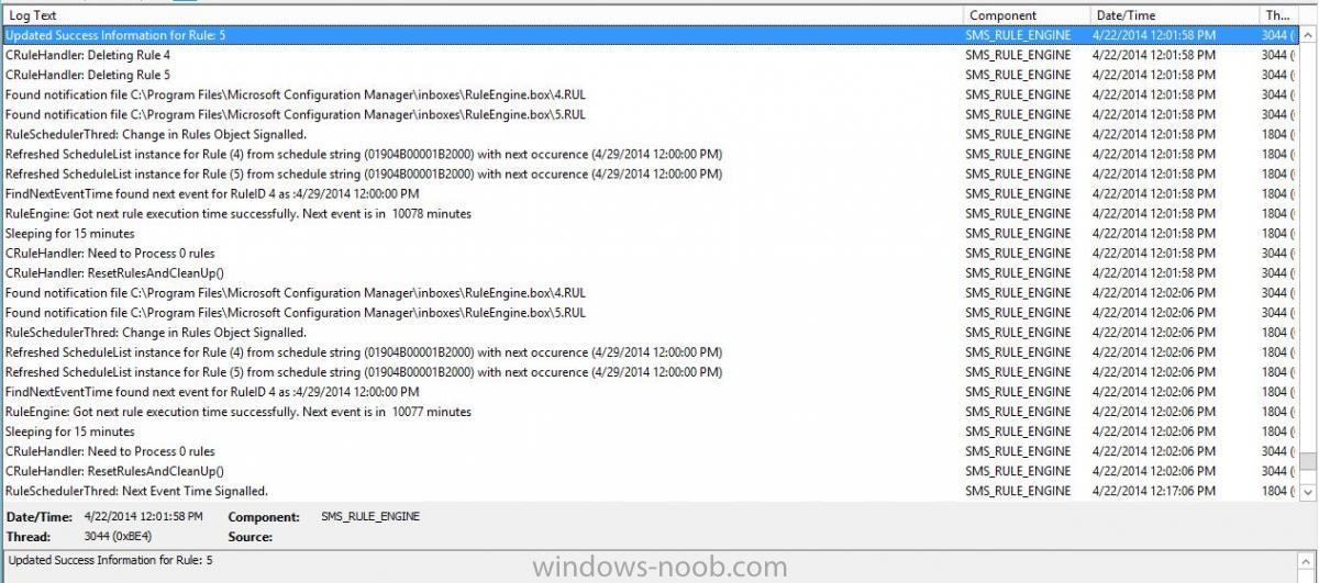

Also, within the RuleEngine log I see that the next trigger event will occur next Tuesday at 12:00P. So I don't know why it will install the following morning at 8:59am
I suggest checking whether any of your device collections have Maintenance Windows set on them.
I use a PowerShell script (Link below) to query all my collections and let me know if any have Maintenance Windows set, so I can troubleshoot or prepare to a batch of updates:
http://cm12sdk.net/?p=1847
Probably a stupid question, but is the time zone of your clients the same as your server?
Thank you for your replies. To dverbern, there is no maintenance window on any device collections or any maintenance window setup for that matter. To Peter33, everyone is configured and located on the same time zone, no differences there. Would another place to look at is office hours?
