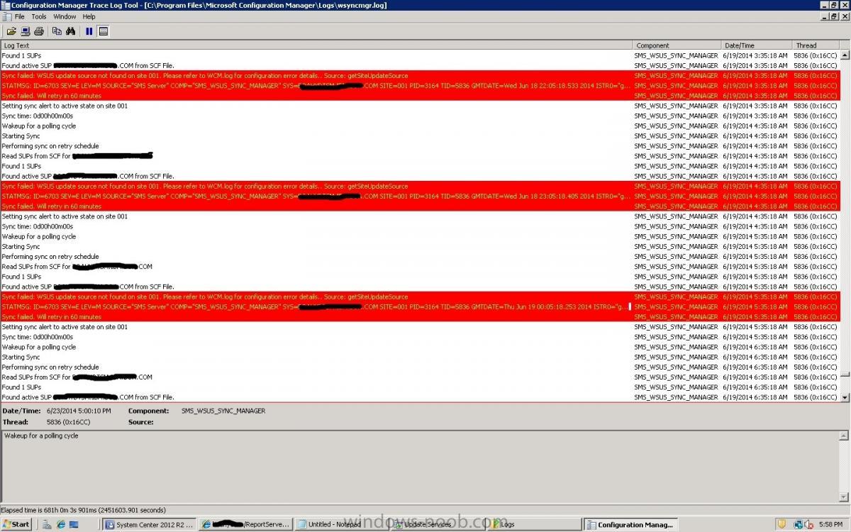

vighneshks Posted June 23, 2014 Report post Posted June 23, 2014 Hi,I have problem in configuring the WSUS in SCCM 2012 R2. I tried all the options which you have mentioned, but did not work. Could you please help me out in configuring the same. I have attached my log file for your reference. We are using proxy server to connect the microsoft site with authentication. wsyncmgr.log WCM.log Quote Share this post Link to post Share on other sites More sharing options...
Mikey C Posted June 23, 2014 Report post Posted June 23, 2014 Hi, I have problem in configuring the WSUS in SCCM 2012 R2. I tried all the options which you have mentioned, but did not work. Could you please help me out in configuring the same. I have attached my log file for your reference. We are using proxy server to connect the microsoft site with authentication. It says quite clearly in the above log file REFER TO THE WCM.LOG FOR CONFIGURATION ERROR DETAILS. Have you done that? Have you attached the WCM.log to the forum?........ Quote Share this post Link to post Share on other sites More sharing options...
vighneshks Posted June 24, 2014 Report post Posted June 24, 2014 I have attached the log file Mickey.. Quote Share this post Link to post Share on other sites More sharing options...
Mikey C Posted June 24, 2014 Report post Posted June 24, 2014 I have attached the log file Mickey.. Mikey, not Mickey Attention to detail!!!..... Quote Share this post Link to post Share on other sites More sharing options...
Mikey C Posted June 24, 2014 Report post Posted June 24, 2014 So basically WSUS and SCCM are not talking to each other, i would definitely do the same as posted above, carrying out each of the following steps carefully accurately (attention to detail again!!!) ) 1. Uninstall the SUP role. Wait until you are certain this has completed, or check the log to make sure. 2. Reboot SCCM server. 3. Uninstall WSUS, verify this has completed successfully, even log should help. 4. Reboot WSUS server. 5. Install WSUS. 6. Install first update. 7 Reboot 8. Install second update depending on OS i think.... 9 Reboot 11 DO NOT GO INTO WSUS CONSOLE AT ALL EVER! 12 Add SUP role to SCCM 13 Wait until that completes, check the SCCM server logs to confirm 14 Configure/confirm SCCM SUP settings are as required (i would recommend only ticking a couple of products for testing 14 Trigger a WSUS sync from the SCCM console. 15 Check the status of SCCM logs. Post back to let us know how you got on. Quote Share this post Link to post Share on other sites More sharing options...
vighneshks Posted June 25, 2014 Report post Posted June 25, 2014 Thanks Mikey.. Two updates were not installed properly. And there were mismatch with the products which we were selected in both SCCM and WSUS. Now it started syncing and will update you once it is 100%. Quote Share this post Link to post Share on other sites More sharing options...
