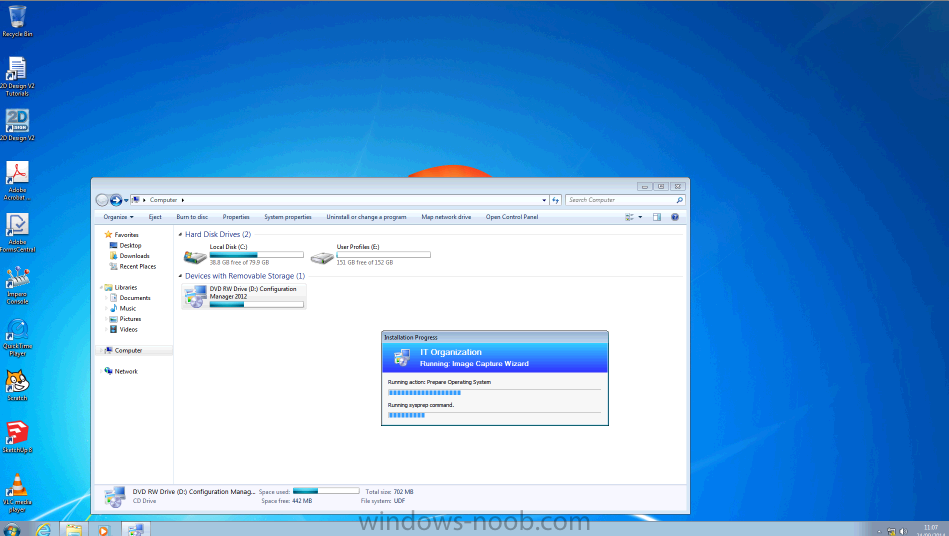

At the moment I am not using the Build & Capture task sequence, I prefer to build the image manually first then capture the image using the configuration manager capture tool which we keep on a CD that tells me that I must undomain the image before it can be captured (not a problem)

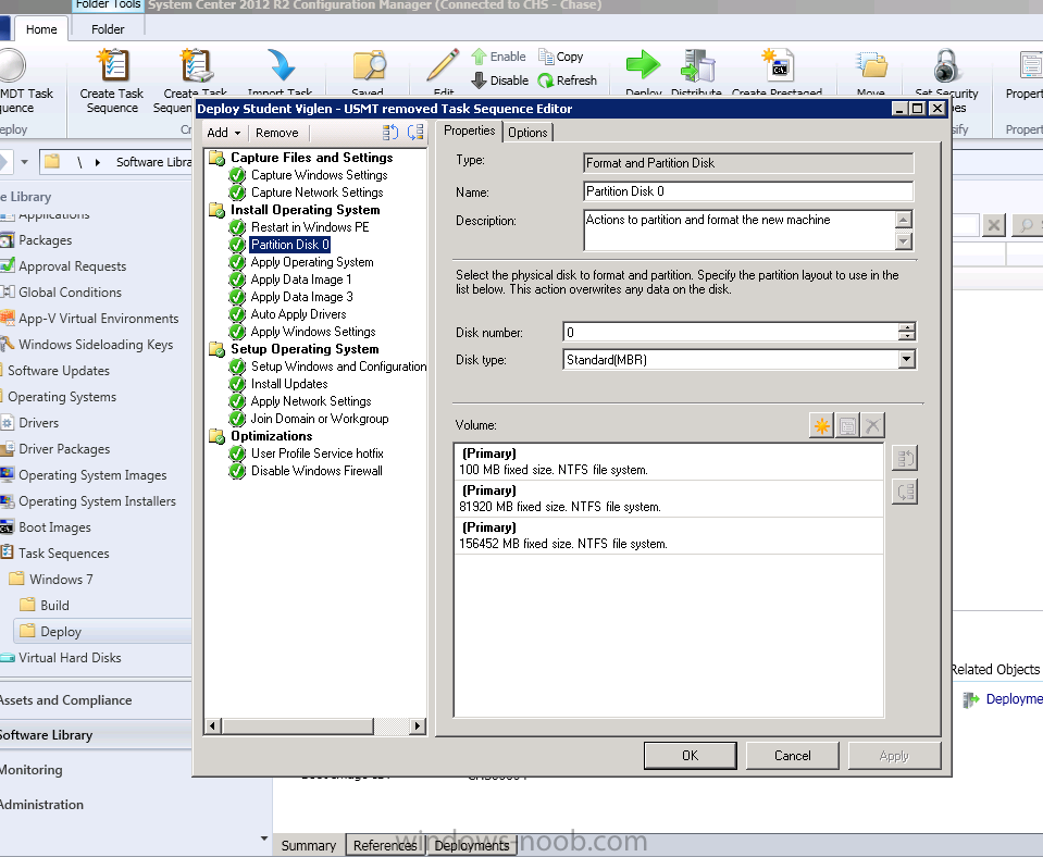

When I first installed windows 7 I booted it into AUDIT MODE during its first time initialization so we can move the user profile and appdata onto a separate partition on the same drive so C: would be the system partition and D: would solely be for user profiles as we use roaming profiles.

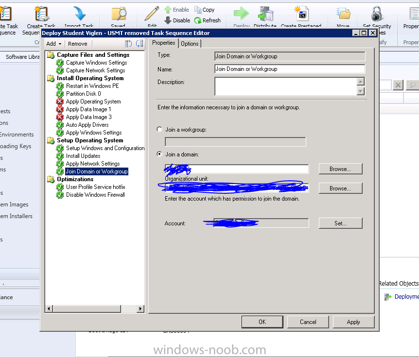

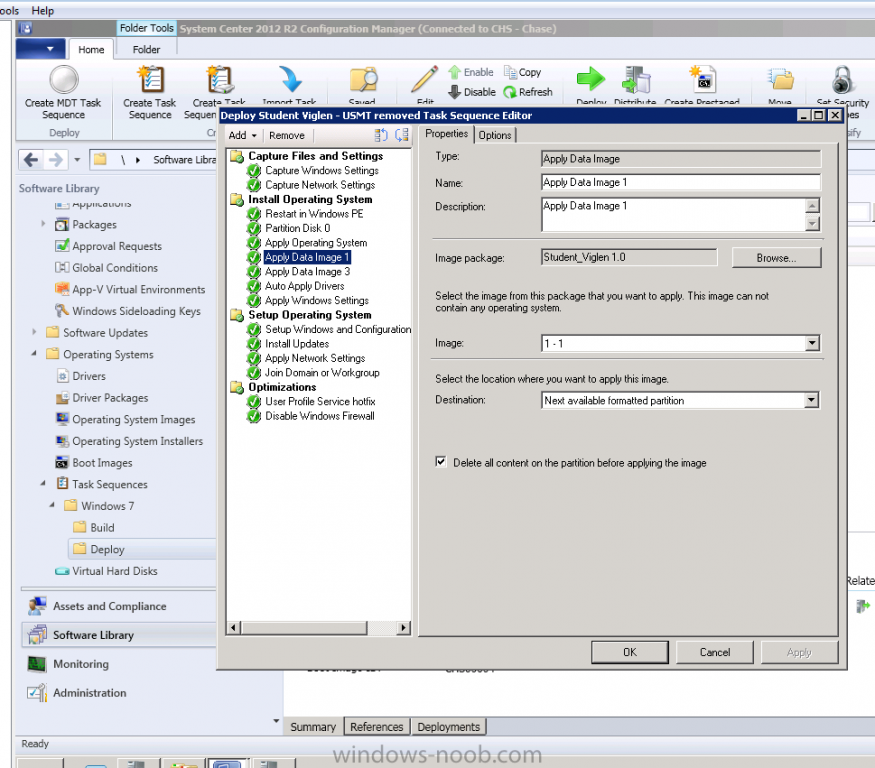

My problem is once I have distributed the image onto SCCM and deploy the task sequence onto the test machine, for one it doesnt join the domain at all despite inputting the correct credentials (which is another problem) which puts the OS with local admin logon only, now when we input the local admin credentials its kicks us out saying the "User profile service failed the logon, user profile cannot be loaded".

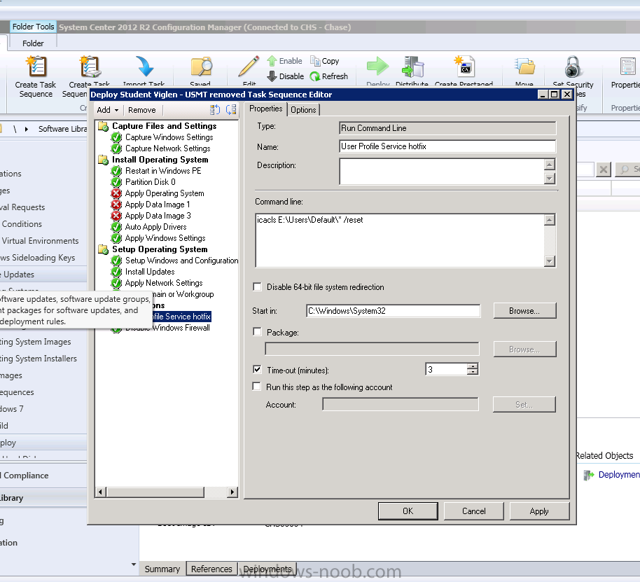

P.S. ignore the red X's in the task sequence I removed the image after this error started happening.
The user profile service hotfix was just a command line I found on another forum not sure if it even works or not!

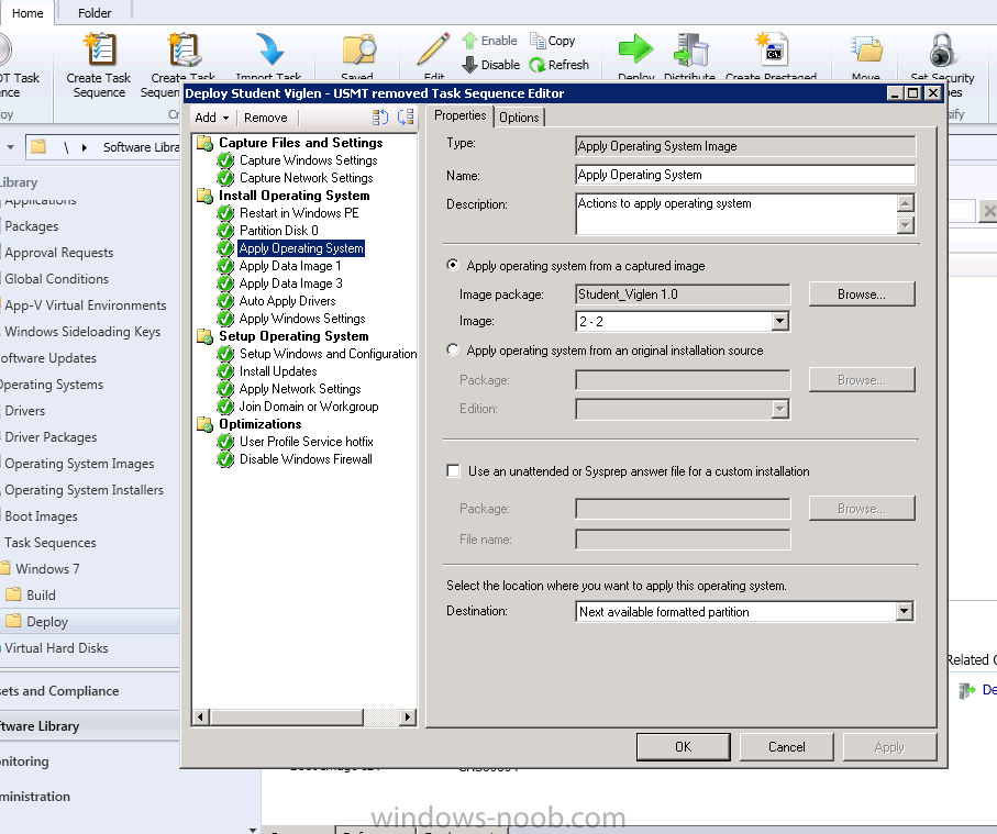

I'd recommend you build the images in Virtual hardware and avoid 2 partitions, it will only cause you problems sooner or later, keep everything on the one partition as bitlocker, and UEFI will make you glad you did so later...

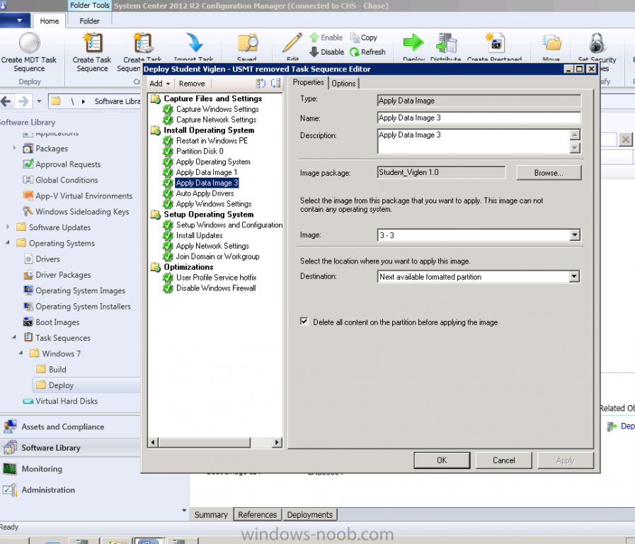

anyhow, if you captured the image with two partitions it probably has index(s) of those images, one being the os, the other the 'data' drive,
use the apply data image step to apply the D: drive,
for network join, make sure you've got an apply driver package step containing network drivers for the hardware you are installing this image on to and verify if theres network connectivity after the restart after applying the os, if not, you need network drivers....
good luck

i thought the driver issue wouldnt of been a problem as the image I capture already has those drivers, please forgive my naivety the SCCM world is very new to me.

Not sure what you mean when you say "use the apply data image step to apply the D: drive,"
Do these steps seem ok to you?
