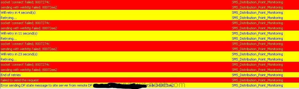

Hi everyone. I'm running Configmgr 2012 R2 and noticed that 1 of my DPs has errors sending DP usage to the site server. My two other DPs have no issues sending usage reports. Have you guys run into this issue?
I have uninstalled and reinstalled the DP role and reconfigured IIS, but no luck on correcting the errors.

Did a little bit more investigating:
This is a screenshot of ProcessMonitor.exe, from a DP that is able to send smsdpusage.log to the MP:
"Source --> Destination"
This is a screenshot of ProcessMonitor.exe from the troubled DP. TCP Reconnect eventually times out.
OK! did some more digging around. turns out the management point server had the wrong subnet mask entered into it's IPconfig....problem solved!
