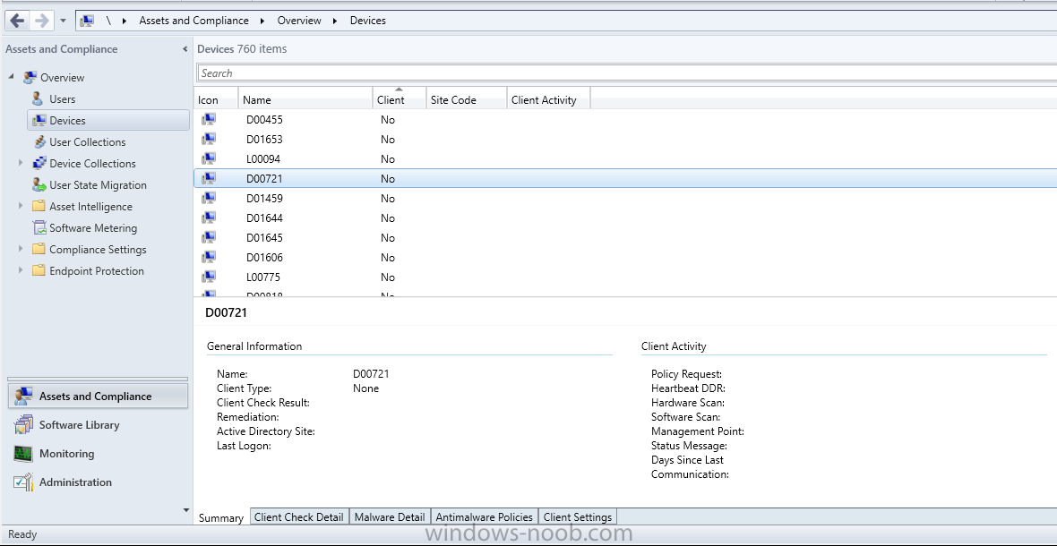

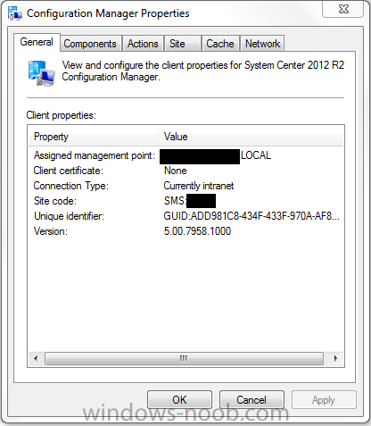

I am having an issue where many devices (100+ in an environment of about 500) are appearing with a Client - NO status in my SCCM 2012 console where they had been YES before. When I examine the device, it has the client installed and looks to be configured OK (shows site FQDN, SiteCode, etc). See below
Console showing no client
Client settings
