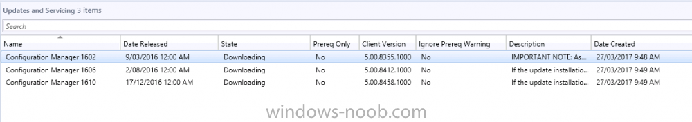

The proxy appears to be working fine in terms of downloading content. I have tested and verified this by manually downloading the content. Also I ran the SQL command to delete the updates from the DB, then deleted all content from the Microsoft Configuration Manager\EasySetupPayload folder and re-started the sever - once done the content re-downloads and goes through the motions of extracting. The issue right now is that in the SCCM console I can see 3 updates that are stuck in a "Downloading" state (1602, 1606, 1610).
Checking the dpmdownloader.log shows:
File D:\LocalApp\Microsoft Configuration Manager\EasySetupPayload\609f1263-04e0-49a8-940b-09e0e34de2d2.cab has been extracted with 0    SMS_DMP_DOWNLOADER    27/03/2017 10:04:13 AM    4380 (0x111C)

Check if there is redist to download for update, 609f1263-04e0-49a8-940b-09e0e34de2d2    SMS_DMP_DOWNLOADER    27/03/2017 10:04:13 AM    4380 (0x111C)
There is web proxy configured for the connector. Use it to download redist    SMS_DMP_DOWNLOADER    27/03/2017 10:04:13 AM    4380 (0x111C)
Download redist for update 609f1263-04e0-49a8-940b-09e0e34de2d2    SMS_DMP_DOWNLOADER    27/03/2017 10:04:13 AM    4380 (0x111C)
Start to download redist for 609f1263-04e0-49a8-940b-09e0e34de2d2 with command  /RedistUrl http://go.microsoft.com/fwlink/?LinkID=724436 /LnManifestUrl http://go.microsoft.com/fwlink/?LinkID=724434 /RedistVersion  /ProxyUri http://proxy.tnet.internal:8080/ /ProxyUserName TNET\MSSCService /ProxyUserPassword 3082017F06092A864886F70D010703A08201703082016C020102318201303082012C020102801497DC0957A8D11CFE2D104C34B13BE010B2C4716C300D06092A864886F70D01010105000482010025C48363EFC219242CD1316942281EA71C801FA19E40F2E28C124ED067F191F5EED05F2019F61CF198C5D4553A19408EE463952A6C4DEC6D5C3EAEE7848F35C90C0D979295CE532CC34D64432A01C69C4C37EFA3CEE43DECDABA43CBDCC27FEC910EA1013095A662CFAC92718D3214DEDC7311DC58EA6A2032F936D3184BAB8DE539D058EC3FF41A9776A54FE02B6F8BEAB9FACB434BF1773E896A02596547E0D2588A3FBB6E492EA1A836D66EC358AD74775F0396033F8CAE099CEC2CA03415722565114E30E9EDAE72E2B37A00C32197874DDF71D88E02A197D85C4F0060B02E008DFF6A01FAAA3207D582A432950FE36A22B8CE8E01A5D136442D3844C601303306092A864886F70D010701301406082A864886F70D030704087BB712ADB5021810801098ED95A53E3F6D704AC8069335D644A7 /NoUI  "\\TWPSCCM1VTO.tnet.internal\EasySetupPayload\609f1263-04e0-49a8-940b-09e0e34de2d2\redist" .    SMS_DMP_DOWNLOADER    27/03/2017 10:04:13 AM    4380 (0x111C)
Check whether the site has intune subscription    SMS_DMP_DOWNLOADER    27/03/2017 10:06:22 AM    2044 (0x07FC)
Check whether the site has intune subscription    SMS_DMP_DOWNLOADER    27/03/2017 10:11:24 AM    2044 (0x07FC)
Check whether the site has intune subscription    SMS_DMP_DOWNLOADER    27/03/2017 10:16:25 AM    2044 (0x07FC)
Check whether the site has intune subscription    SMS_DMP_DOWNLOADER    27/03/2017 10:21:26 AM    2044 (0x07FC)
Check whether the site has intune subscription    SMS_DMP_DOWNLOADER    27/03/2017 10:26:28 AM    2044 (0x07FC)
The end result is that it wont get past 'Check whether site has intune subscription'. When I upgraded our dev SCCM server I saw that it continued on to the next step after this without issue.

This issue was resolved with assistance by Microsoft via several very lengthy support calls. The core issues related to the SQL database and Microsoft had to directly manipulate the db in order to then be able to run the upgrade. Not sure exactly what caused the issues in the first place however all resolved now.
