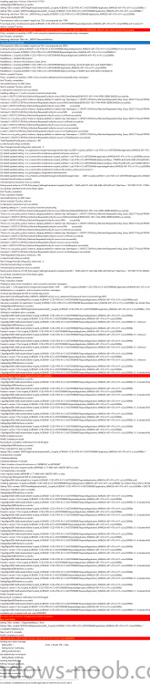

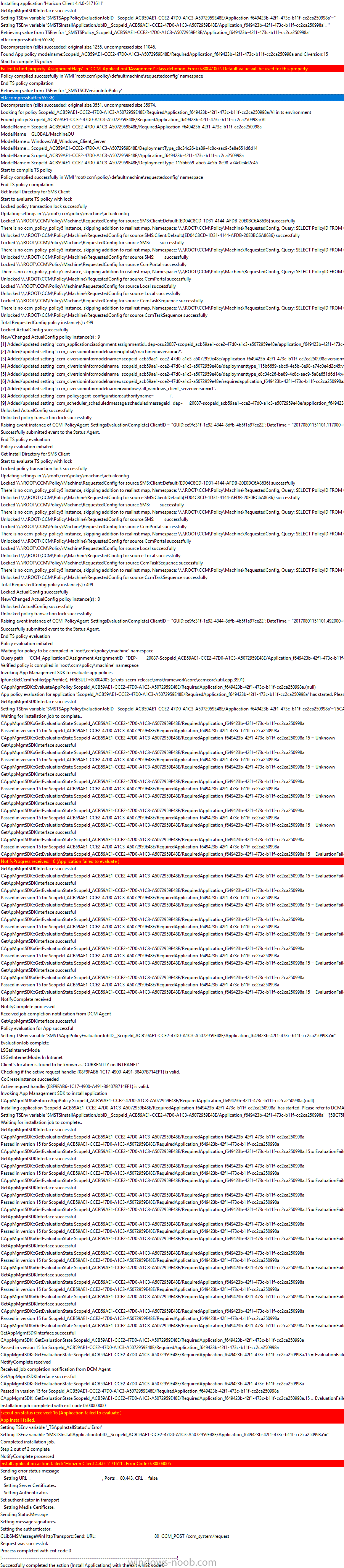

I'm attempting to install the vmWare Horizon View client during OSD for setting up a Windows based thin client; however, I can't seem to get it working and I'm not sure what else to do to attempt to troubleshoot it.
I've tried double checking that the network access account is set in software distribution configuration and that the account has the appropriate permissions on the network location where the files are located, and I can successfully install the program with a deployment using Software Center/Application Management and a required (or available) deployment - it is only failing when trying to install it with the Install Application step in a task sequence.
I've also tried wrapping the install exe in a powershell script, with the first line being to write 'begin install' to a log.  This log never gets written so I don't think it is even getting to point where it is really attempting to install anything.  I get the same messages in the smsts.log whether I'm attempting the command line/exe install or via the powershell script that runs the exe.
This is what I'm seeing in the error log (smsts.log) Note: the referenced DMCAgent.log doesn't appear to have any useful information in it:
